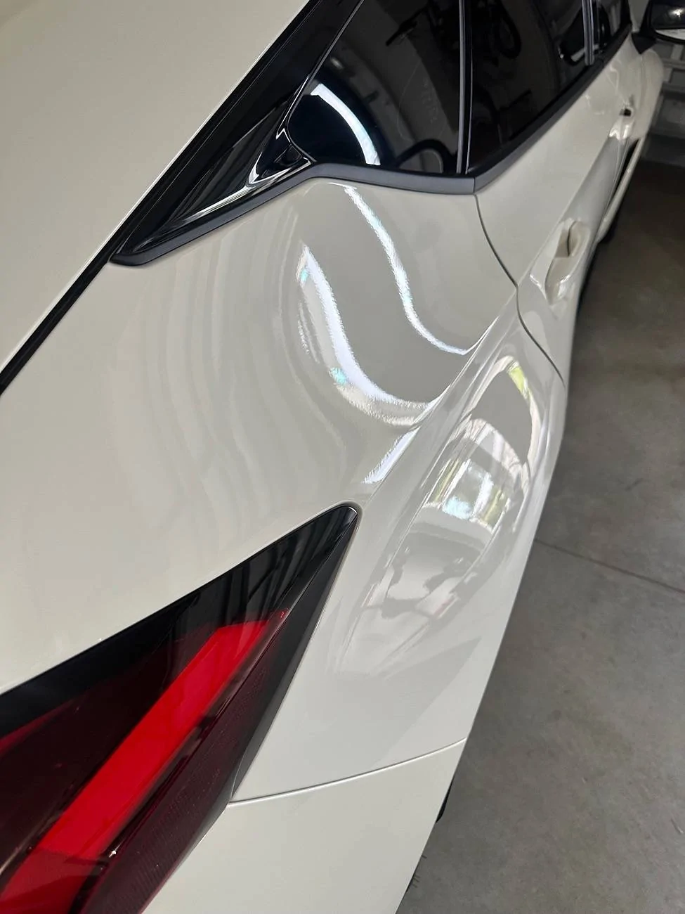

11th Gen Honda Civic Paint Polish Before Ceramic Coat IMG_2484
11th Gen Honda Civic Paint Polish Before Ceramic Coat IMG_2754
I washed the car, then sprayed iron remover, rinsed off, sprayed iron remover a second time, rinsed off again, clay barred the car, washed a second time, dried and waxed with Meguiars Ultimate wax. This was the result. Took about 4 hours one morning when I first got it but worth it.
