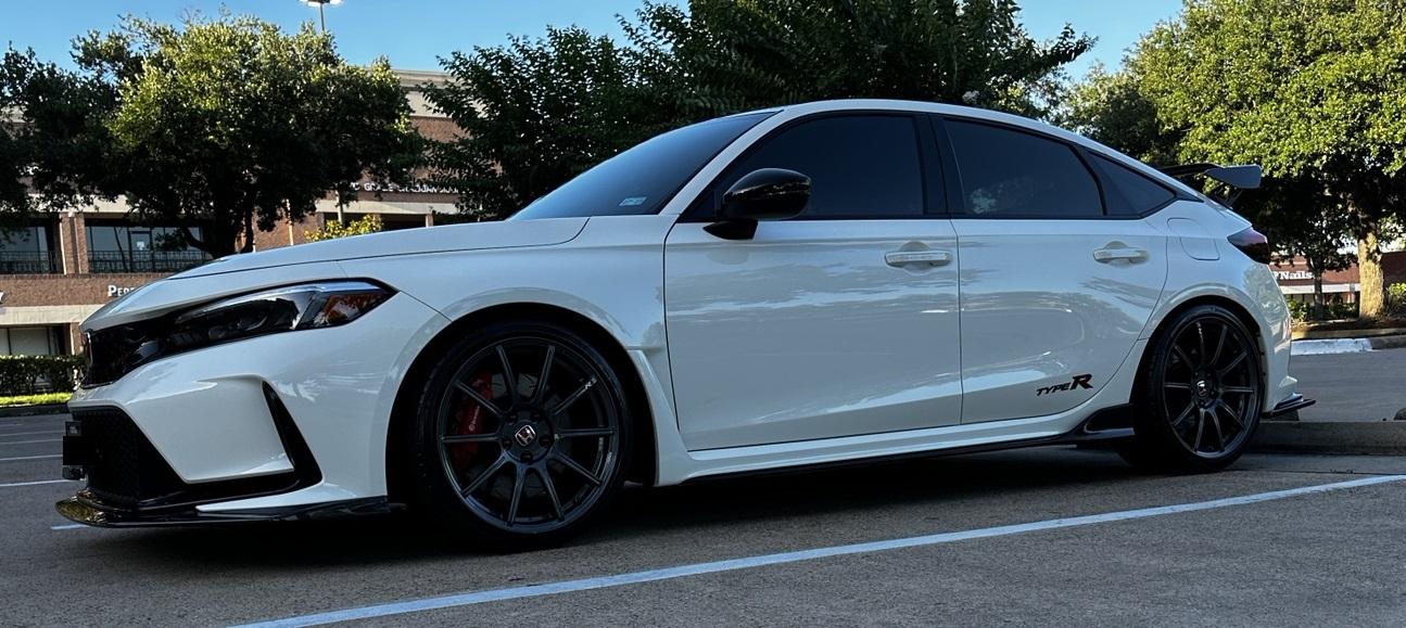

Ohlins will give you a little bit drop, not too much. Just enough, not being too aggressive ... Here is the side picture of Ohlins on its recommended settings :
11th Gen Honda Civic Ohlins DFV Road & Track Settings Discussion 4
I never scrape on my driveway :headbang:
