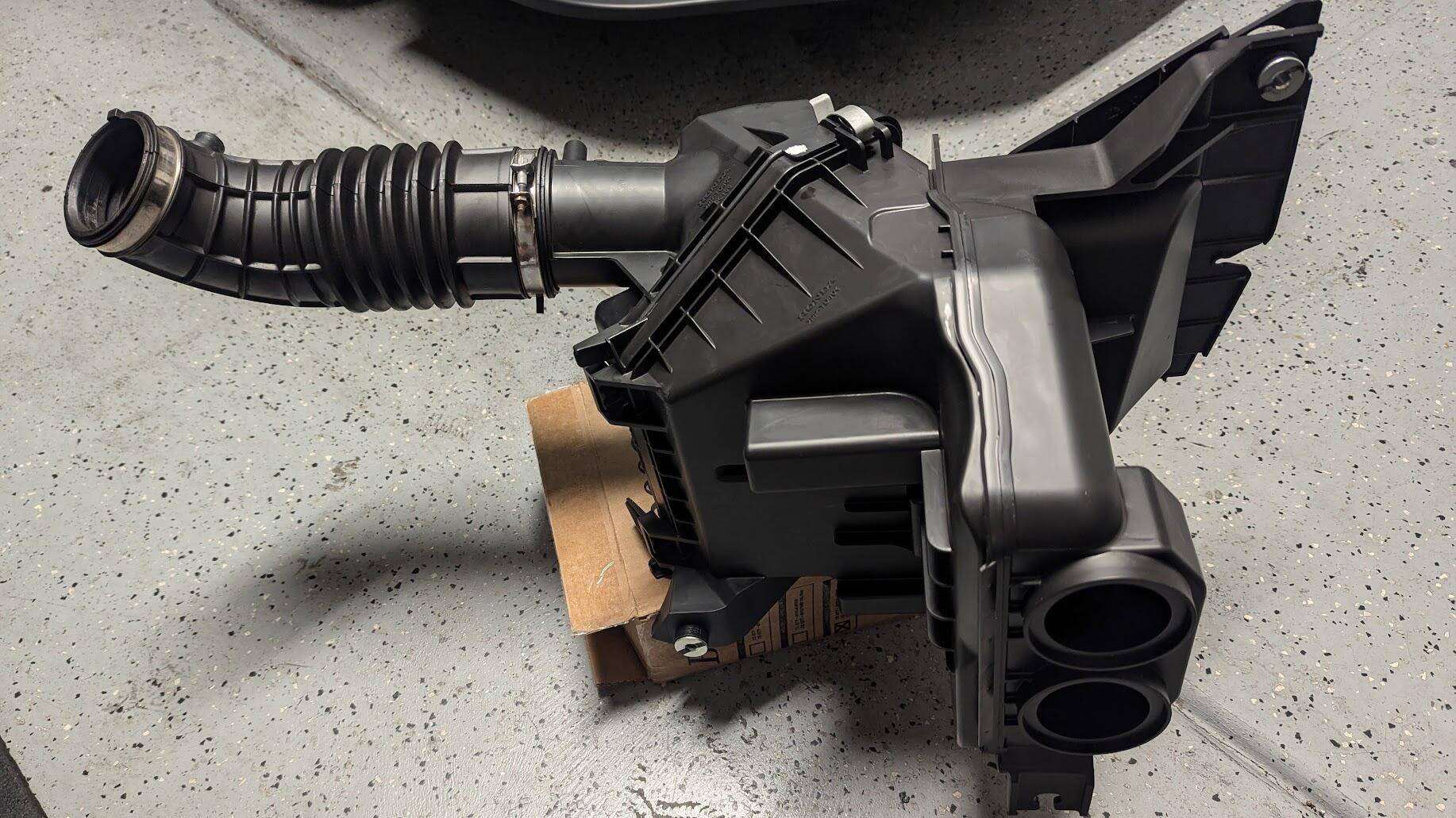

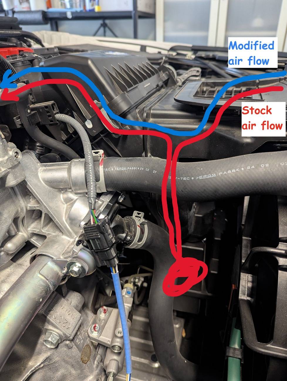

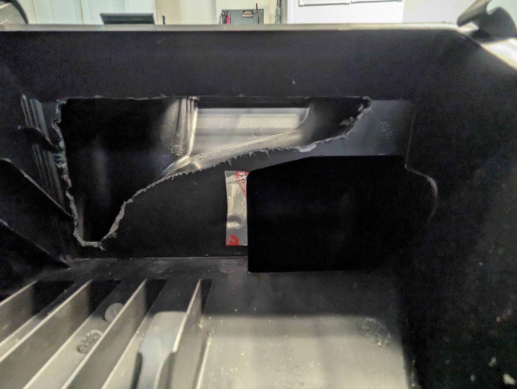

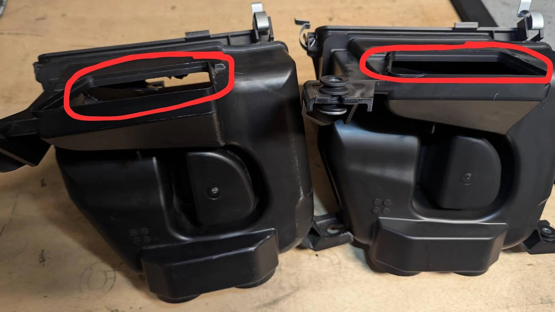

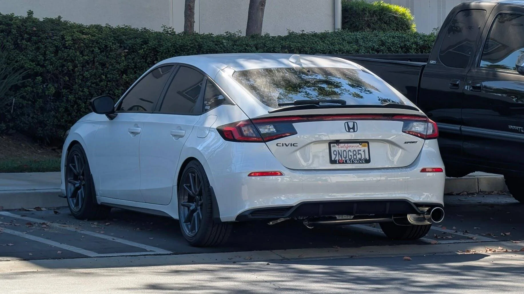

I bought a stock 2.0 airbox with a K&N OEM-style filter on FB Marketplace for $40. I planned to do a swiss cheese airbox mod, which I did on my past cars. The stock airbox requires incoming air to make 90 and 180 degree turns before entering the engine. I realized I could make an opening within the airbox to create a direct pathway. After I installed the modified airbox and K&N filter, I hear a minor increase in intake noise. Car doesn't feel any different. Maybe I'll get the PRL intake hose.

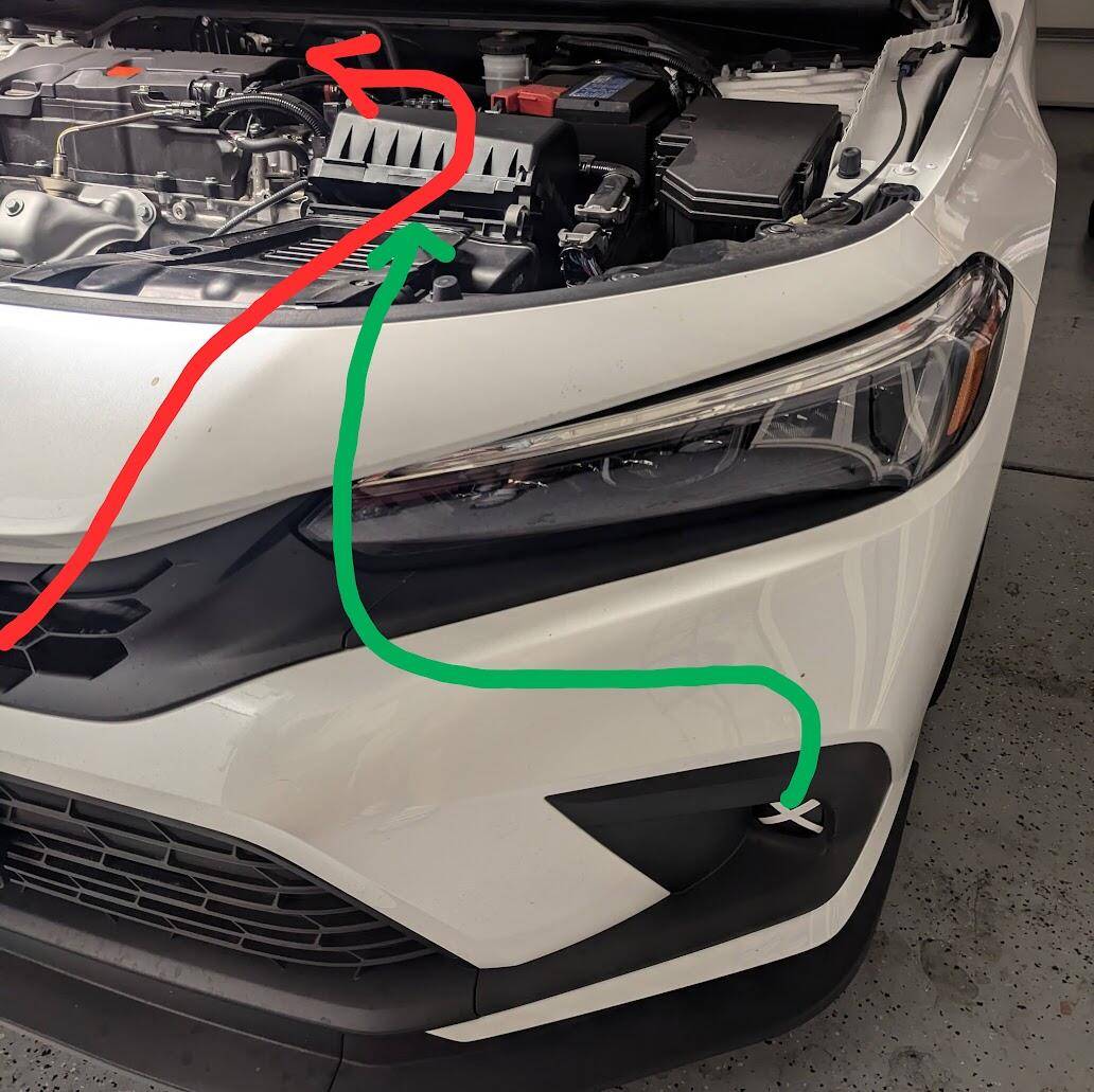

The bottom of the airbox has two holes (both connected) that attach to a resonator box. I can't access the bolts to remove the resonator box. This video shows how to remove it on a 1.5T by peeling back the driver's side wheel well. I could attach a hose from the driver's side fog light hole (my car doesn't have fog lights) to the bottom of the stock airbox. PRL makes an optional duct for their 1.5T airbox, but not for their 2.0 box. I wonder if PRL found the 2.0 doesn't have enough intake vacuum pressure to benefit from an add-on duct to their airbox. ?‍♂? The 2.0 must suck at sucking in air. ?

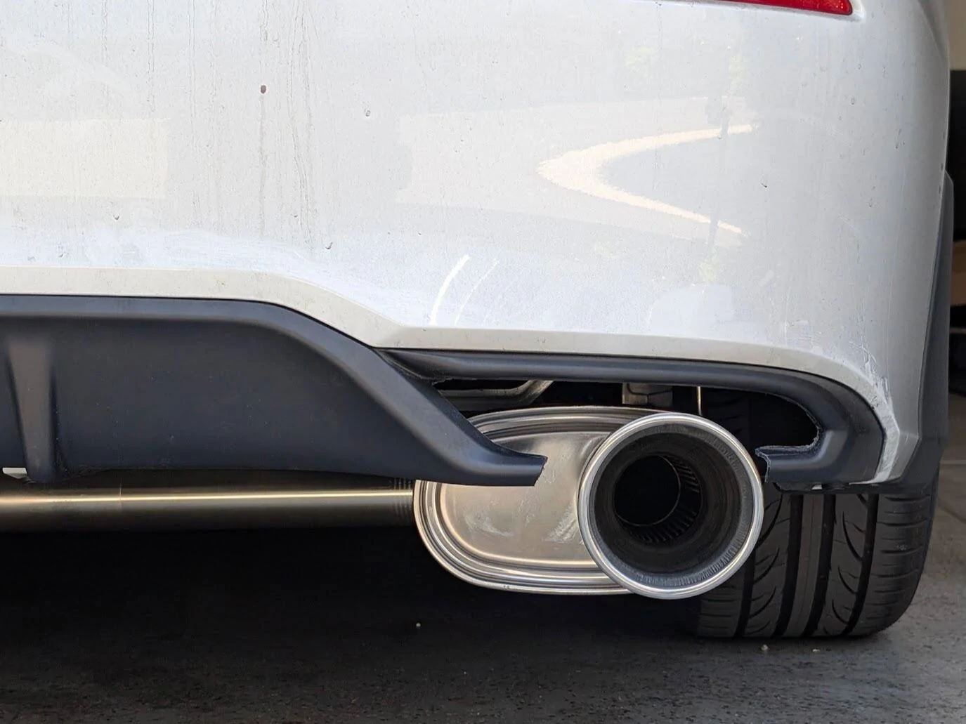

Installed an Invidia Q300 exhaust today. I prefer a stainless steel Spam-can shaped muffler design. ? Invidia Q300 was the only exhaust of that style I found for FL Civics. Most others have a N1 style (long and narrow) muffler design. My car is a 2.0, so it's single muffler. Invidia makes a dual muffler Q300 for the 15T. Here's a video of it. A muffler shop must modify the piping to connect with the downpipe. Do 2.0 cars have a muffler hanger on the driver's side? ?‍♂ The sound level is not loud, but not quiet either. I don't want a loud exhaust. It is the loudest at 1500-2000RPM. I modified the stock rear diffuser with a Dremel and sandpaper to fit the exhaust.
My only complaint is the tip sticks out too far. This exhaust must be designed for a sedan. I later learned the sedan is five inches longer than the hatchback (184 vs 179 inches according to Honda).
I bought it here for $491, plus tax and free shipping. I'm not sponsored nor affiliated with them. They were the best price I found.

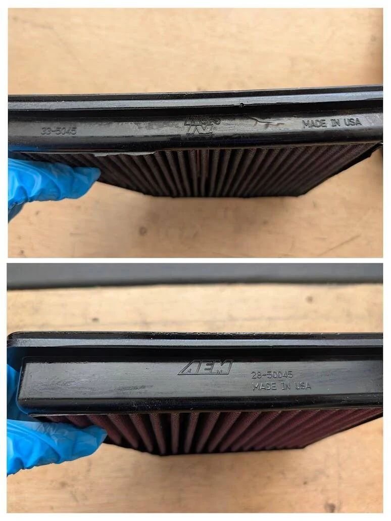

Swapped air filters: K&N to AEM. Been using a K&N for a month. I had K&N filters in the 90's and 00's. I didn't like how they need to be oiled. My previous car had an AEM, which doesn't need oil. I read online K&N bought AEM many years ago, and K&N made AEM's filters before the merger. ? Both websites state cotton gauze is the filter material.
K&N left. AEM right.

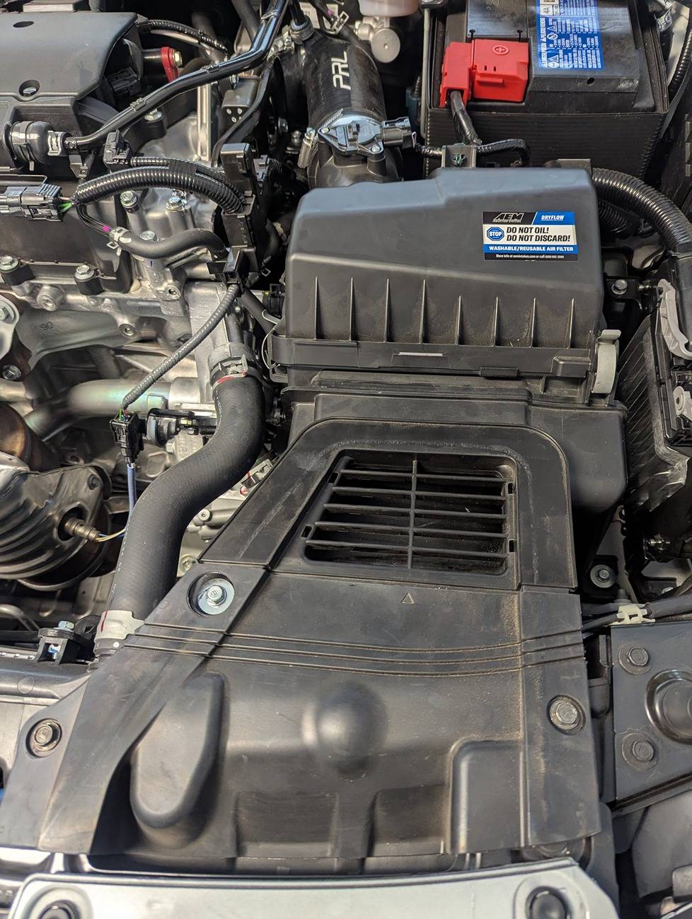

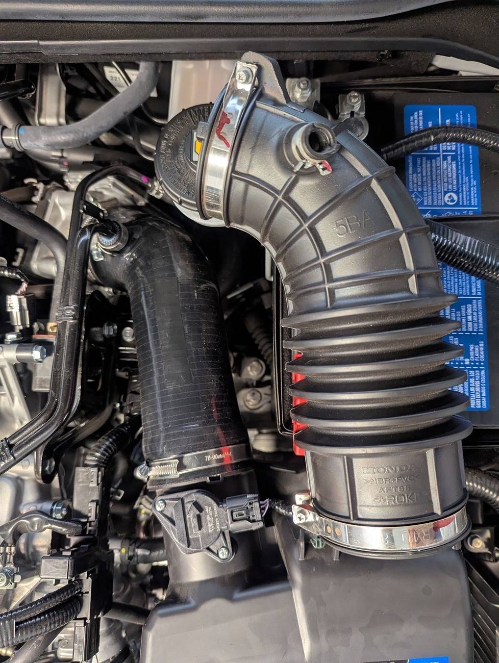

Installed 2 parts today.
  1. PRL intake hose for 2.0. This was an impulse buy after seeing it on sale for Black Friday ($12 off). Two months ago I cut hole in the stock airbox to allow direct airflow. Today I cleaned up the hole with a Dremel and sandpaper.
