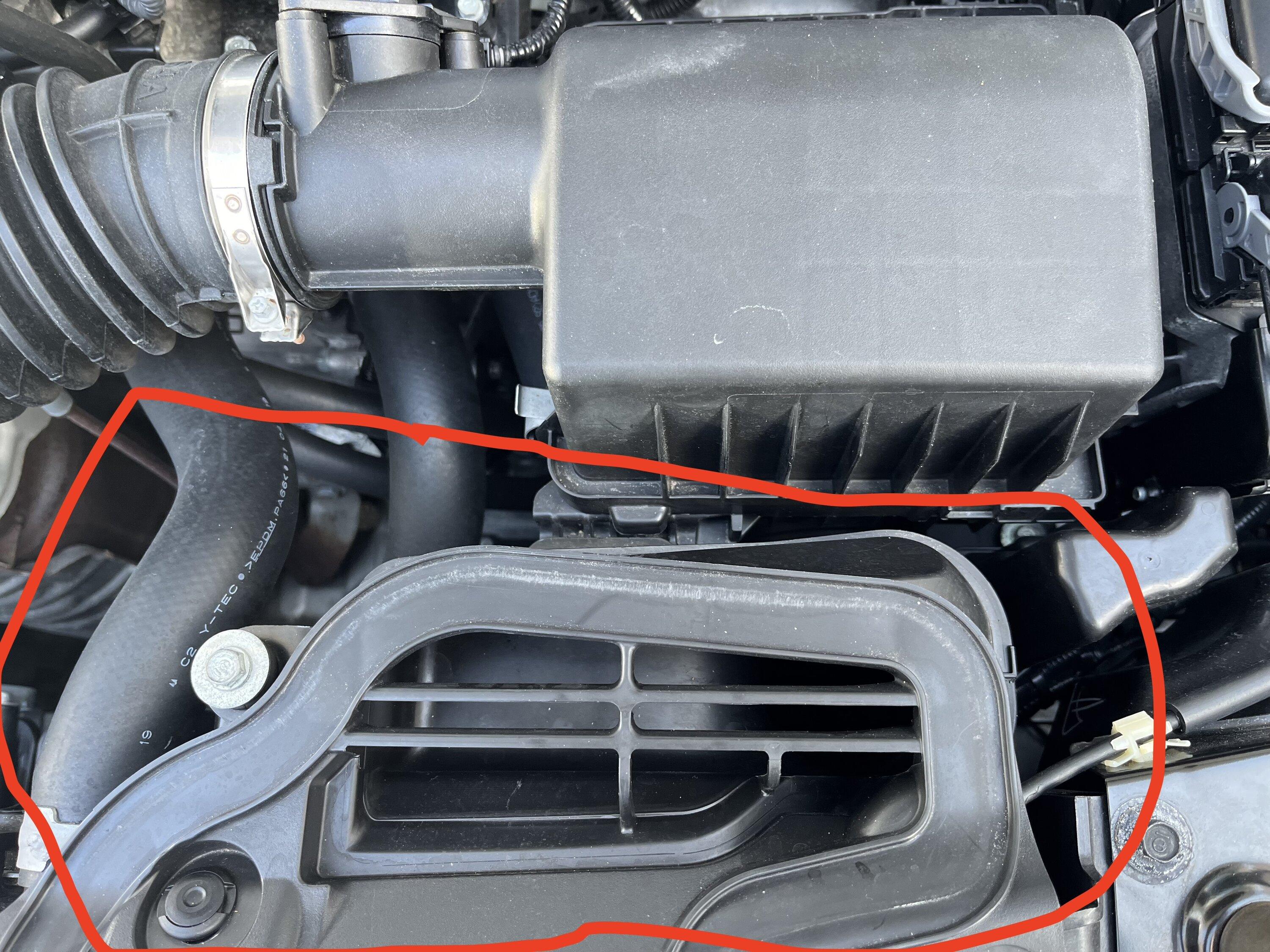

For those that are interested - this is what I did today. Let's see if it keeps the furry little bastards out of my air box. Now, how to keep them out of my cabin air filter area???

I’m considering getting some of that Honda branded rodent tape to wrap my engine wires before they start to snack on them. The damn stuff is EXPENSIVE! About $50 a roll!
my problem is a hickory tree in my front yard. Every year it drops thousands of nuts (I called them acorns but more correctly they are hickory nuts). It was never a problem in the past but for some reason this year it has been a disaster. That tree is coming down this summer. Hopefully that will solve most of the problems. All the anther trees are far away from my cars.

One other cars, I've had the luck with placing chicken wire screen (1/4" spacing) over the intake, which I bought at Home Depot. I also covered the trunk cabin air exits after finding a nest inside the trunk.
The screen wire is fine, so minimal affect on airflow. Also galvanized against corrosion.
On 11th gen Civics, I would sandwich the screen under the hood rubber seal, at the airbox entrance. I found hickory nuts stashed with the moth balls I once used, so moth balls proved useless and stinky.

I tried the oils. They don't work for deer, either (although deer don't get into the intake; they just eat everything.)
On my Ford F350, the chipmunks ate through the filter and broke the wire in the air flow sensor. It wouldn't run at all.
I used 1/2" screen and hose clamps to close off the intake. That worked.
Or, you could take my niece's approach. She got an air rifle and blows away any chipmunk she sees.
