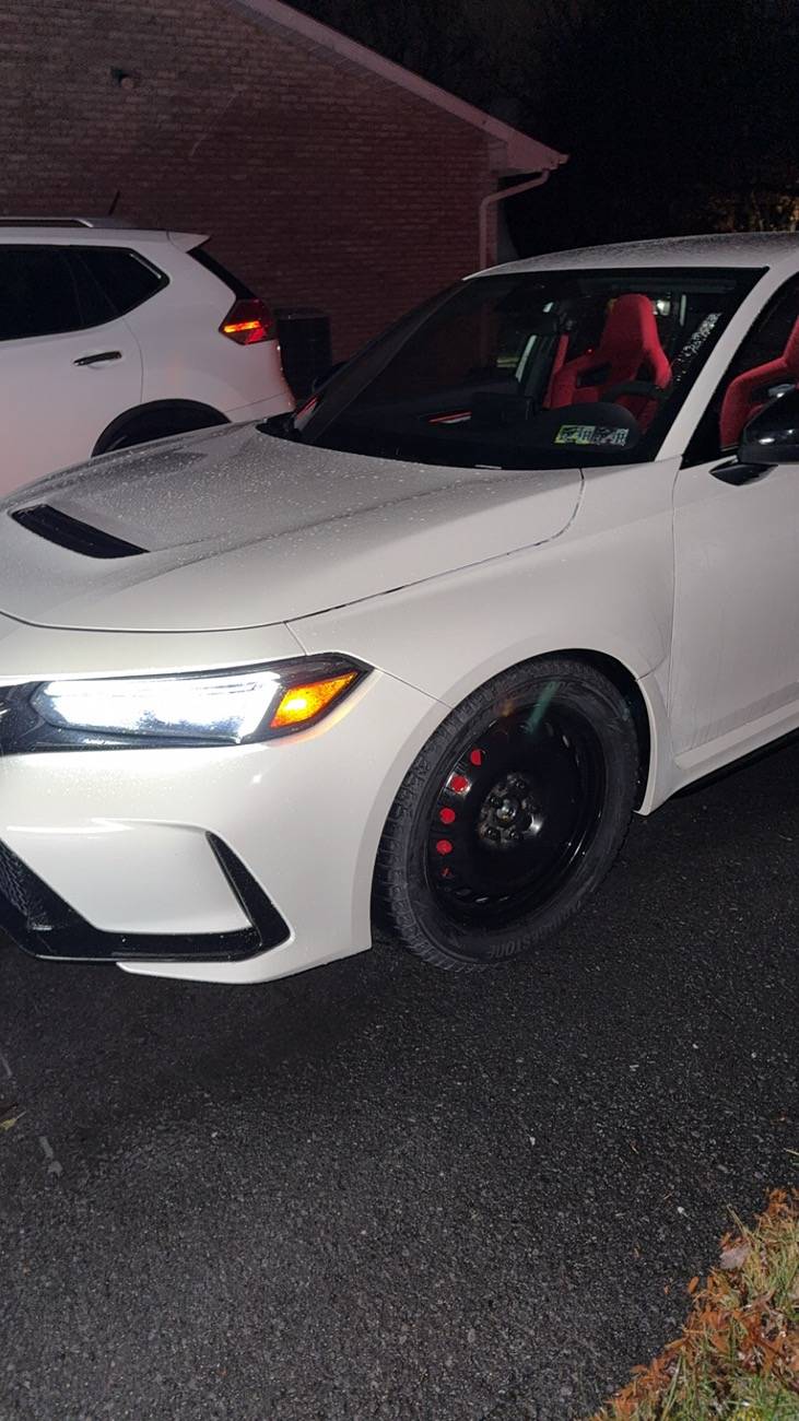

245/50/18. no rub not in full turn not even n the backroads. gained ~3 inches of ride height. was able to take 6 inches of snow np i drove this baby all winter long. Dont hate the steels too much it was 50$ for 4 wheels and the blozzak snow tores were closeout sale 97$ a piece. :)

LOL. yeah i left out the fact they were steelies ? they did come off a pilot hahha. ill upgrade the winter wheels once those snow tires are cooked. too good a deal to pass up. plus im buying 18x10.5 wheels for track. car dirty asf in winter… steelies it is ?

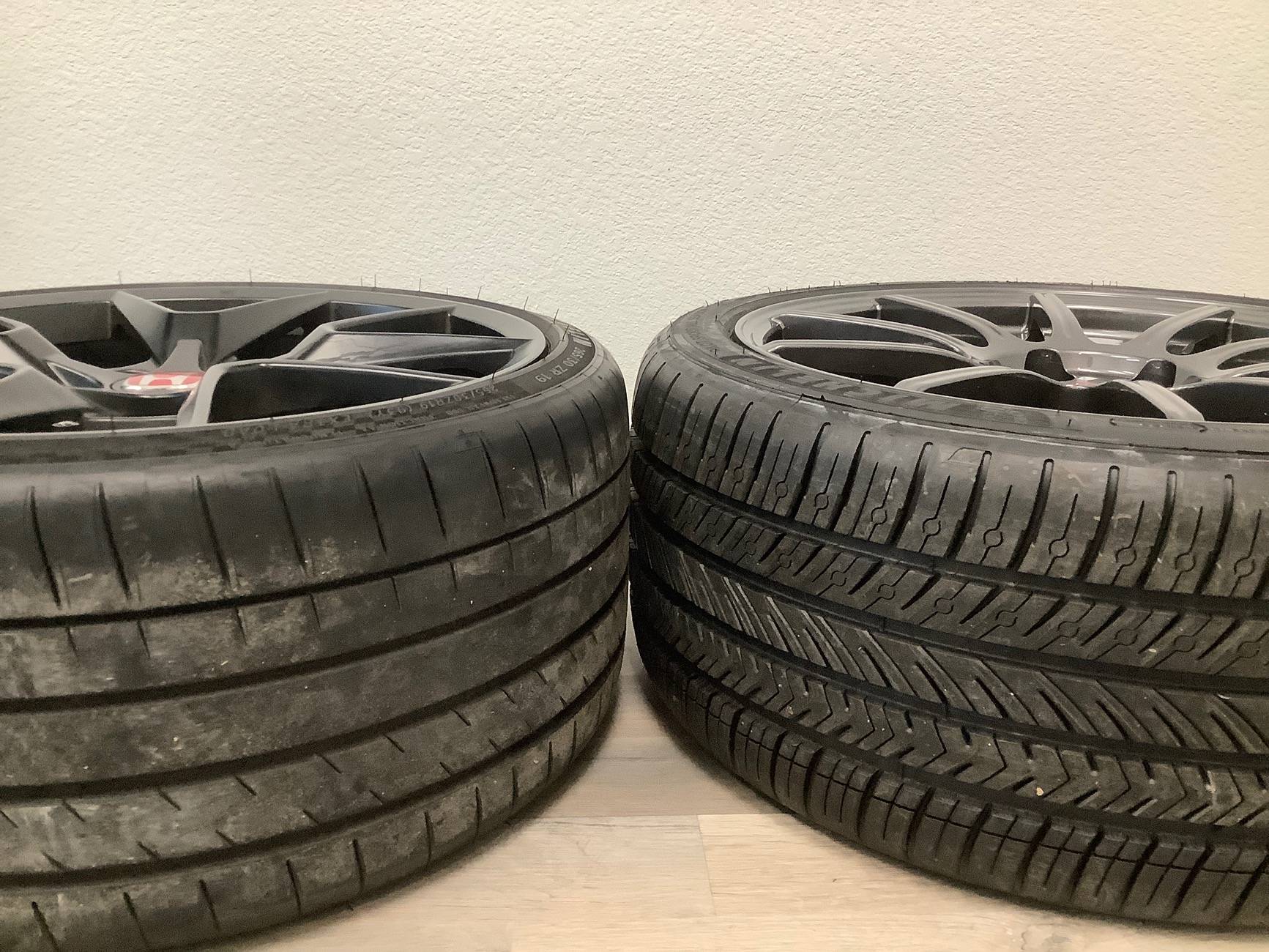

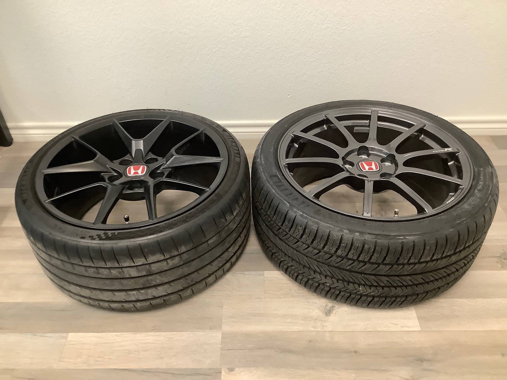

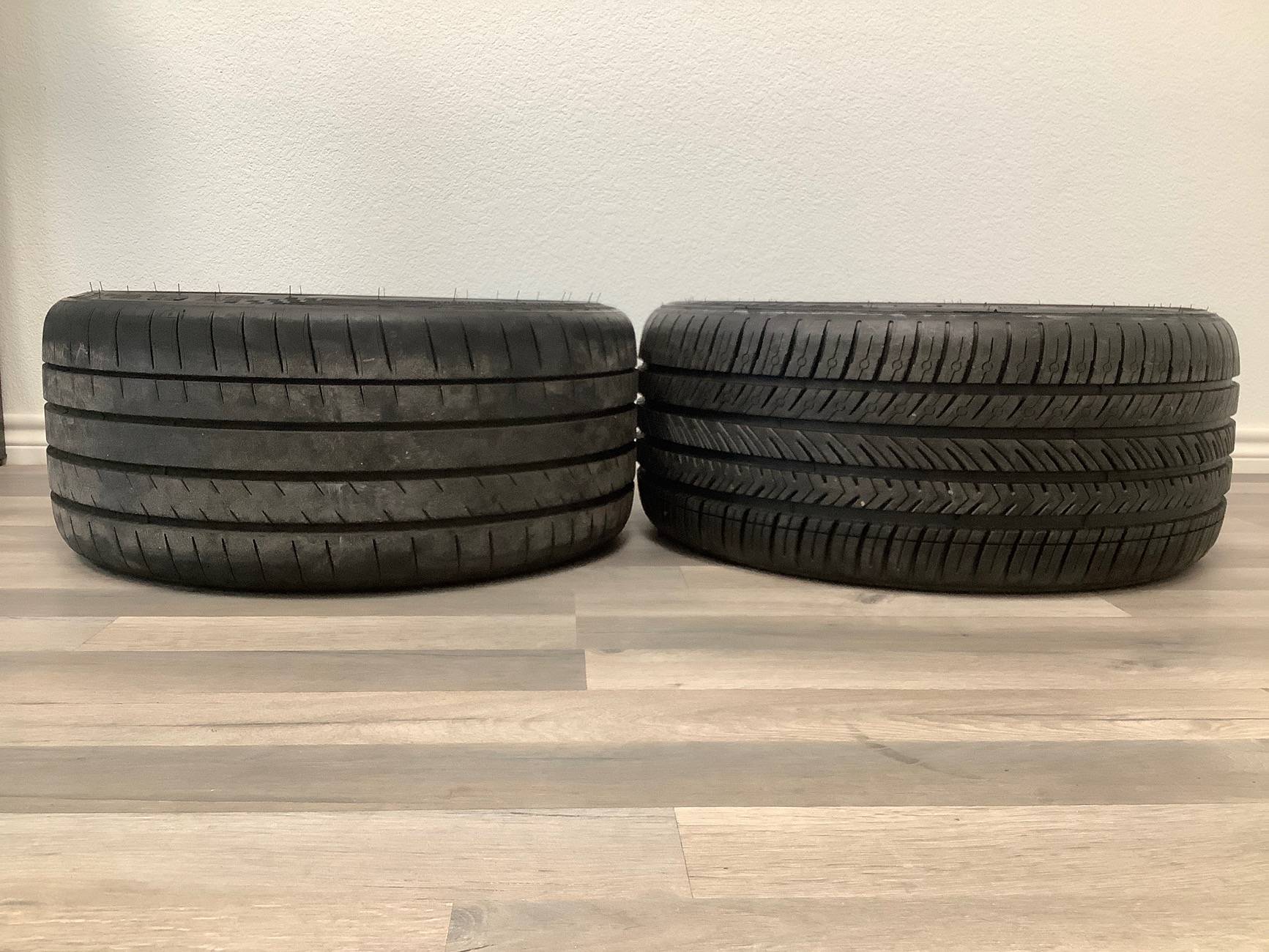

@Brittania and @SeanMcc23 , I finally got my current wheels and spacers all installed last week.
Honda Forged 19x9.5 ET+60 wheels plus H&R 15mm spacer on all 4 corners.
Tires are Michelin Pilot Sport All Season 4, size 275/35 19.
Using OEM FL5 suspension damper module.
Looks nice and easy fit, no problem. No rub so far driving in Comfort Mode.
11th Gen Honda Civic Maximum overall tire + wheel diameter on stock suspension IMG_0601
OEM Honda Cast wheels + Michelin PS 4S in 265/30ZR19 vs. Honda Forged wheels + Michelin PS All Season 4 in 275/35ZR19.
11th Gen Honda Civic Maximum overall tire + wheel diameter on stock suspension IMG_0636
11th Gen Honda Civic Maximum overall tire + wheel diameter on stock suspension IMG_0637
New tire is not much wider than the old one.
11th Gen Honda Civic Maximum overall tire + wheel diameter on stock suspension IMG_0638
11th Gen Honda Civic Maximum overall tire + wheel diameter on stock suspension IMG_0639

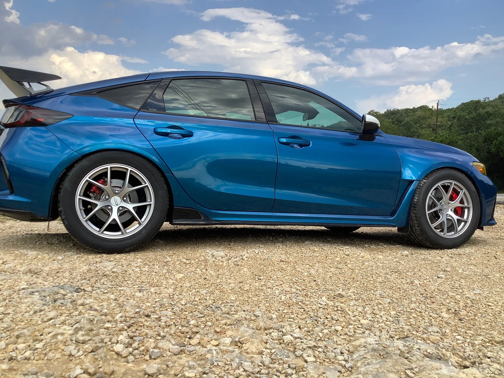

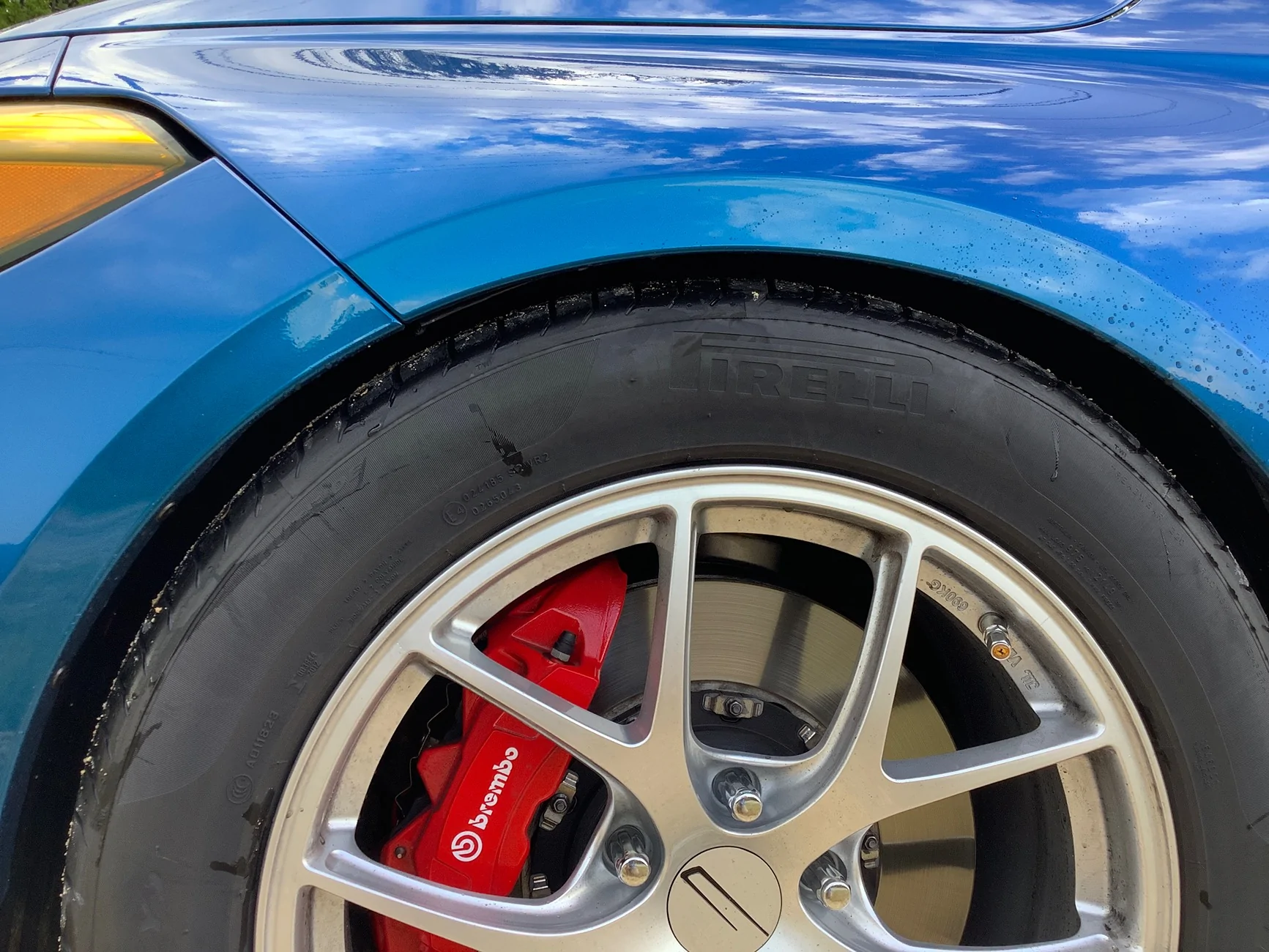

@SeanMcc23 ... I think I may have one upped you, brother.
So I went for it. I put 275/45ZR18 Pirelli P Zero summer tires on my new 18x9.0J ET +45 MITA Motorsports FKS wheels.
Setup is still stock OEM FL5 springs / shocks, dampers, and damper module. Also, there are no camber kits insalled.
I think I may have maxxed the chonk.
11th Gen Honda Civic Maximum overall tire + wheel diameter on stock suspension IMG_0832
11th Gen Honda Civic Maximum overall tire + wheel diameter on stock suspension IMG_0835
11th Gen Honda Civic Maximum overall tire + wheel diameter on stock suspension IMG_0839
11th Gen Honda Civic Maximum overall tire + wheel diameter on stock suspension IMG_0840
11th Gen Honda Civic Maximum overall tire + wheel diameter on stock suspension IMG_0841
11th Gen Honda Civic Maximum overall tire + wheel diameter on stock suspension IMG_0842
11th Gen Honda Civic Maximum overall tire + wheel diameter on stock suspension IMG_0843
11th Gen Honda Civic Maximum overall tire + wheel diameter on stock suspension IMG_0847

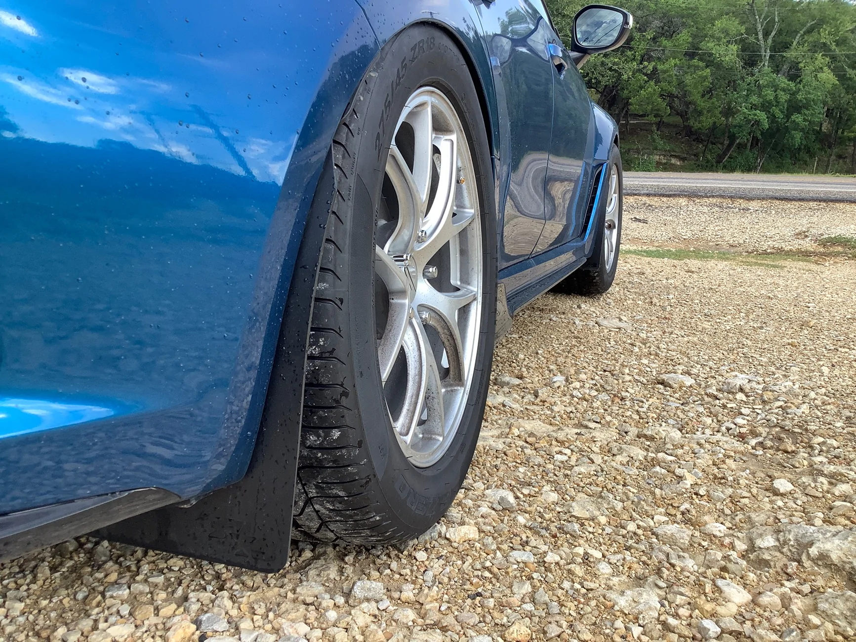

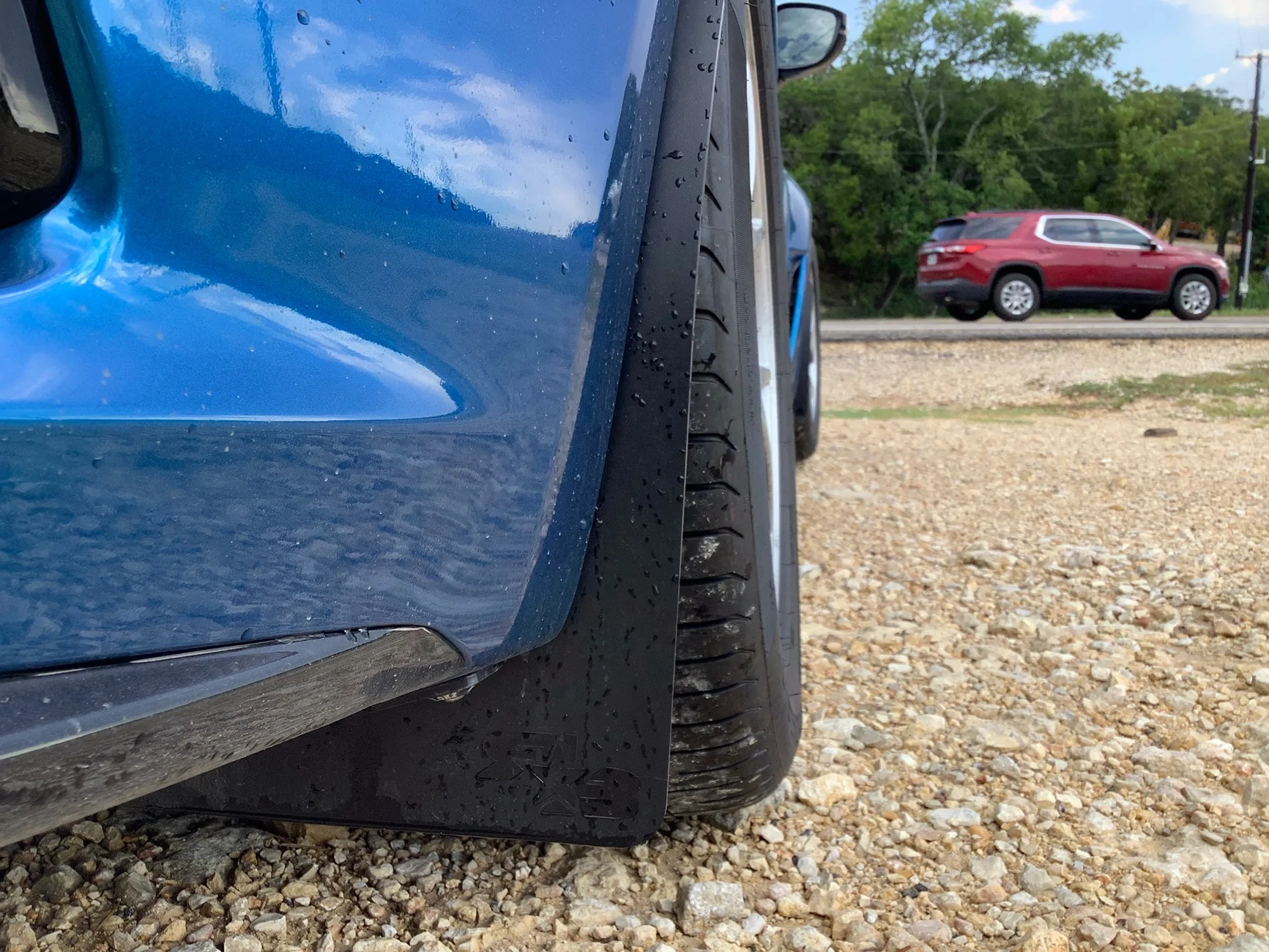

Full Disclosure:
Even in Sport mode, this setup does rub a little bit.
I have to go easy over bumps and while braking, and while braking and turning, particularly over bumps or dips.
So maybe I don't win this round.
This setup drives really smoothly overall, though.
Cheers.

I'm pretty sure that if I had mounted 265/45 ZR18 tires on these 18x9.0J wheels, there would be a lot less rubbing in Comfort mode, and
... maybe no rubbing at all in Sport mode.
Don't quote me on that, but maybe someone here will try it...?
