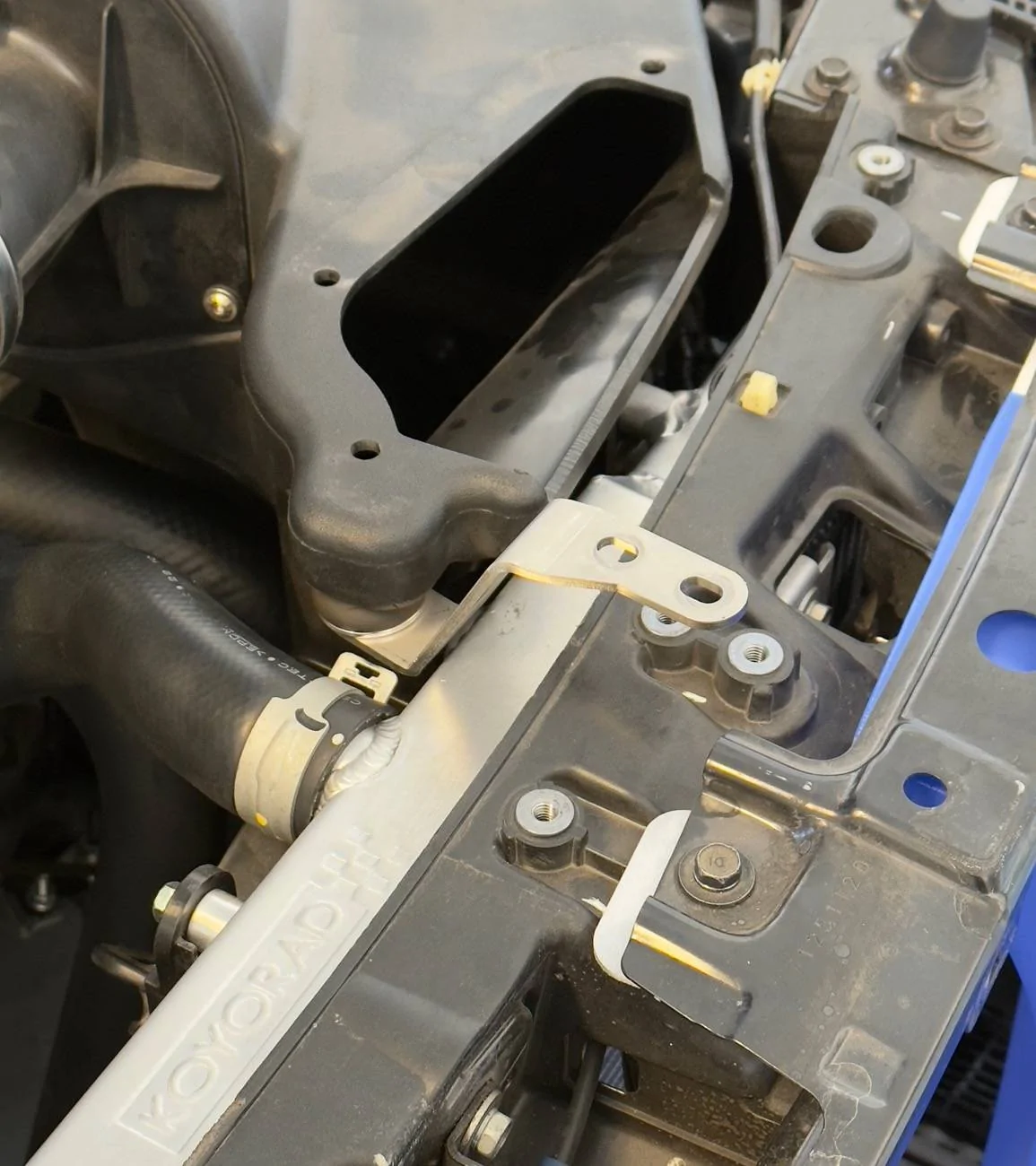

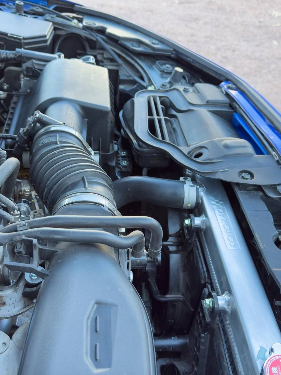

Just a heads up for everyone, I installed the Koyo radiator today, and the PRL HVI doesn’t fit with it.
I removed the bracket that holds it to the front radiator support to try and get a little more room, but even then you can just barely get the bolts in to the top plastic duct piece.
When all is said and done, the intake is still pressed very very firmly in to the fan shroud.

With the stock intake there was about 0.5” of clearance in between the intake duct to the air box and the fan shroud. I reinstalled your guys intake a few days ago though. Tune didn’t like the stock intake, even with a K&N filter.
I found that if I put a bolt through the forward most hole on the intake bracket, and rear most bolt hole on the radiator support it pushed the intake back enough to not be crushing itself in to the fan shroud.
