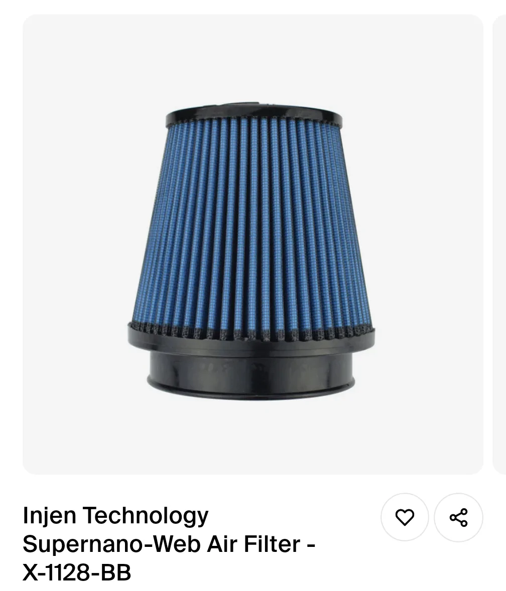

Not looking to start a oiled v. dryflow debate, but for those interested I have been searching for a dryflow filter option for this intake and finally found a workable option.
The problem is the narrow opening on the intake box, the narrowest green and aem 4 inch filters just won't fit.
I found a video of a guy putting an injen dryflow filter in the 2.0 (non-turbo) HVI intake, and it fit. The 1.5 box looks a little smaller than the 2.0 box, but I rolled the dice after finding the correct filter on Amazon. Sure enough it fits fine. The correct part number:
11th Gen Honda Civic Dryflow option for PRL HVI intake 1.5T Screenshot_20250807-192537~2

Nice find! I also use a dryflow on my HVI. And I believe green filters supplies PRL with their filters. Unless you're talking about a dry green filter which I wasn't aware existed!
