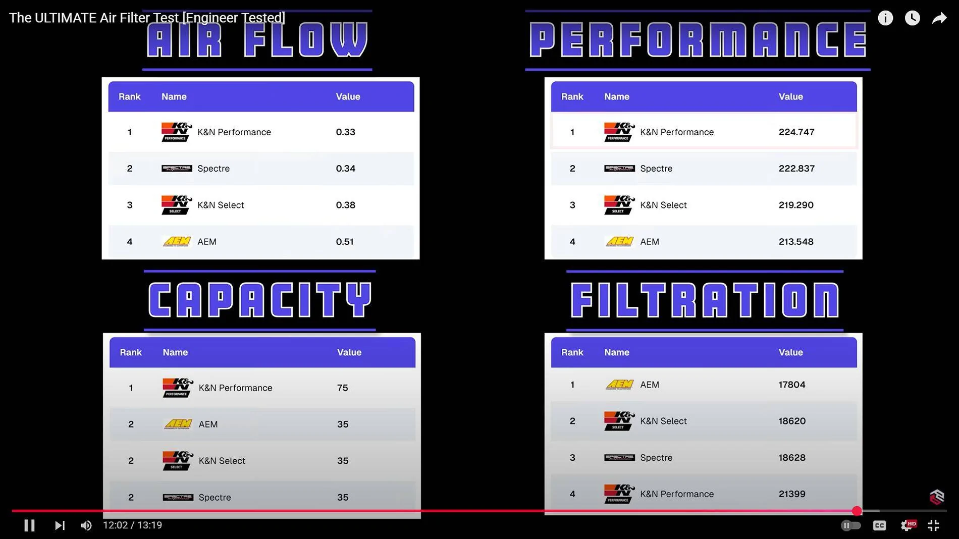

I'm not a fan of filters that need oil, like K&N. I use AEM dryflow filters. This video compared the performance and filtration of 4 panel filters.
11th Gen Honda Civic K&N Panel Filter 1745862075179-z

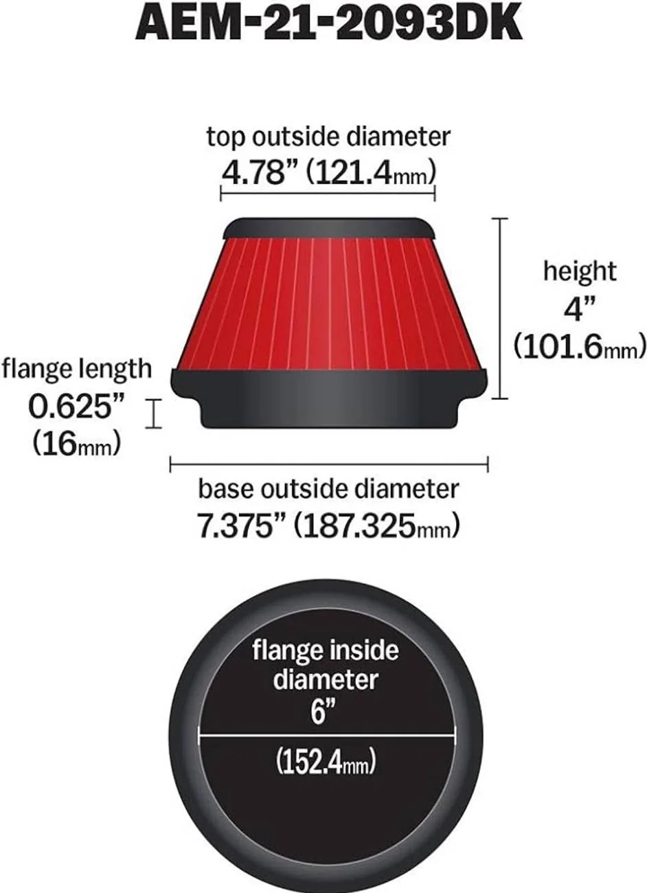

Found it.
It is “AEM 21-2093DK” perfect fit for the PRL HVI. With my experience, no issues with install and no problems with over 5k miles until upgrading to Infinity Design. Also checked on Amazon and its 20% off right now going for 48$
Also incase you or anyone else in the thread is curious about the dimensions.
