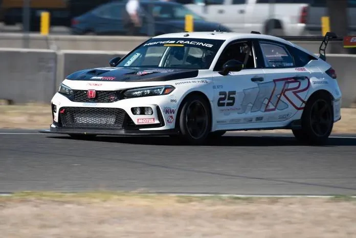

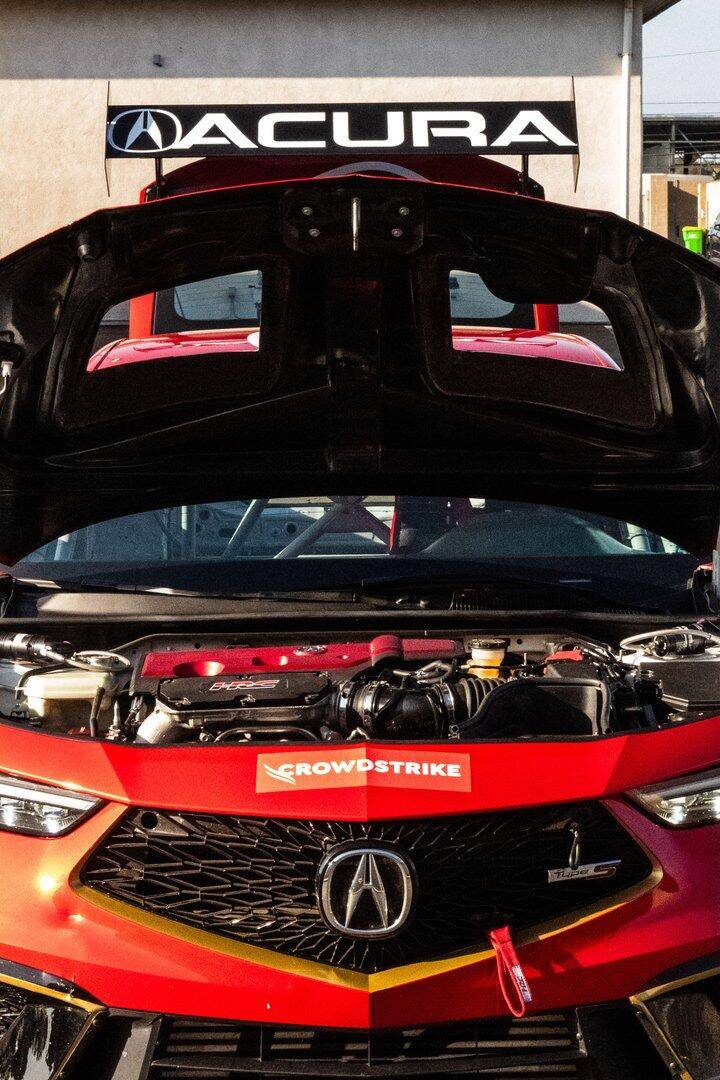

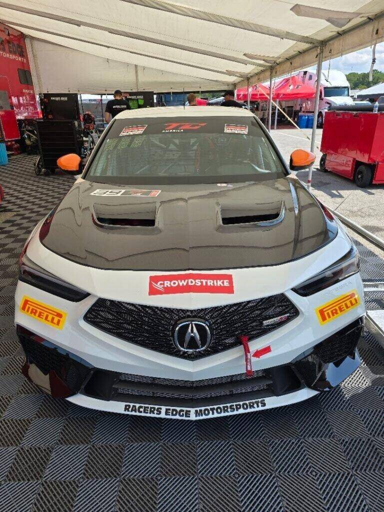

But for me, I'd rather just use what you see the professional race teams using. I haven't seen any race team use the varis hood.
HRC used the same Seibon hood for the Thunderhill 25 hour endurance race. It was used on the on the Civic Si too.
