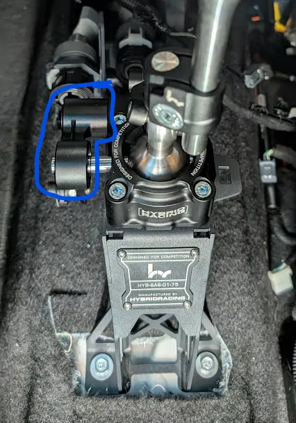

Hi everyone, new to the 11th gen platform, im just curious is the shift rod and the A brace on the hybird racing shifter be pretty loose? thanks in advance!

Mine is loose like that. I think it's intentional.
My gate rocker has a little play. It slides approx 2 mm left-right. Does yours? I also think that's intentional.

i just checked mine and it has no lateral play.

Mine also has no lateral play.

i did have the yoke loosen some after a little bit of time in the car. I tightened the two bolts and never had the issue again. Overall the yoke is loose on the heim joints, it began to make a small noise on shifting when it became too loose.
