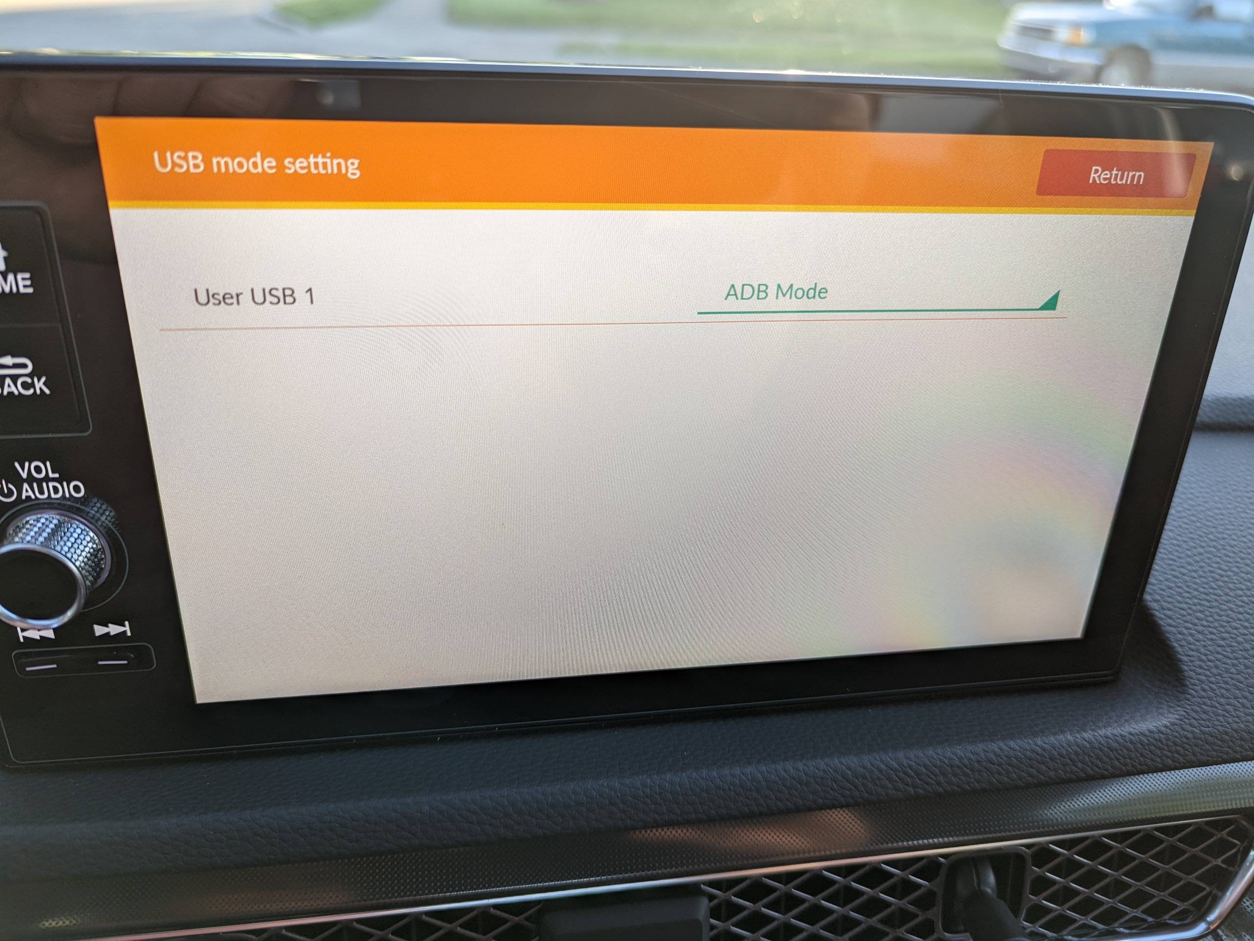

I also noticed that the ADB mode usb mode seemed to just turn off power completely to the port and nothing worked.
Is it possible enabling ADB mode is killing all USB ports except the one meant to be used for ADB? Perhaps try all the ports (including USBC).
I tried all ports no luck. I did enter the service screens but we are missing " Cancel Android Restrictions" option. I did enable developer options and ticked the OEM unlock and enabled adb.
I did change the USB host function to adb. I ordered a USBA to USBA cable so I can test on Monday

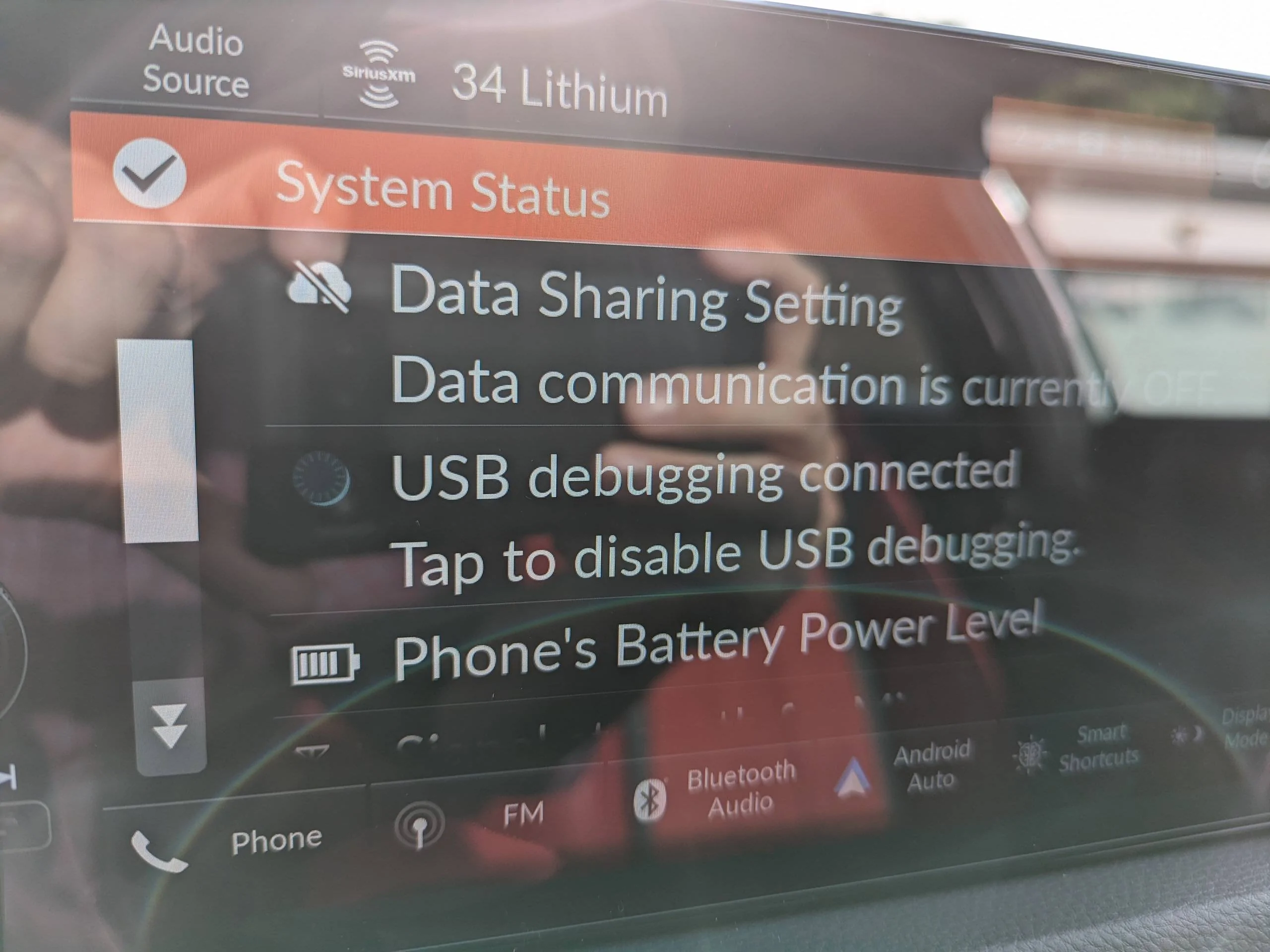

Alright the cable came in and it detects the device. Unfortunately I'm seeing an unauthorized from the adb server. Normally there is a pop-up on the Android device where you can authorize the PC that's connecting. Well I don't see this dialog. Interesting how it shows adb in the notification screen
I believe that you need to go into Developer options and switch USB function from charging to Data/file transfer.
Integra23
Tom
May 31, 2022
772
561
2023 Integra 6spd A-Spec
Once you have entered developer mode, scroll down and toggle USB mode from charging to file transfer.
I tried MTP and PTP mode but no prompt.

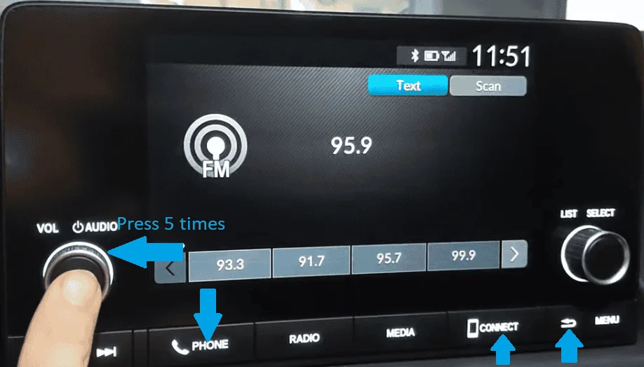

Took delivery on my 2022 Sport Hatchback (Canada). I love this car, but disappointed the 7in. display doesn't even seem to be android (I'm 70% sure; the software version reported isn't an Android one)
I've found two hidden menus in addition to the one in post #11. The process is much the same but uses additional buttons:
"Developer Diagnostic" Menu:
1. Power off the radio
2. While holding down Phone and Connect, and Menu, Press the power button 5 times and DO NOT release Phone, Connect, and Menu.
3. Keep holding Phone, Connect, and Menu for ~5 sec.
The Developer Diagnostics menu comes up with the following items:
DD VSP Error (defaulted to "on")
- Steer angle adjustment result
- Steer angle setting
- Bluetooth information
- Touch panel check
- Display check
- Gamma adjustment
- BMP display
I have not reviewed anything inside these menus yet.
The other hidden menu is called "Authentication Diag" and contains settings for changing the USB to Host/Device mode (among other things). I am hoping this would be a starting point for head unit mods.
Similar to the above, hold down three keys for ~5 seconds after hitting the power button 5 times. I've added a sample screenshot for clarity.
"Authentication Diag" menu:
2. While holding down Phone and Connect, and Back, Press the power button 5 times and DO NOT release Phone, Connect, and Back.
3. Keep holding Phone, Connect, and Back for ~5 sec.
The "Authentication Diag" menu comes up with the following items:
- USB mode change
- Apple CarPlay performance test
- USB hub mode (defaulted to off)
- Bluetooth test
The USB mode lets you toggle between Host & Device mode. Changing the setting seems a bit "flaky" and usually won't allow to select one or the other unless I leave the menu and come back in a few times. It often, but not always, allows me to change to "device" by holding down the button for around 5 seconds and then repeatedly tapping it to get the setting to "stick".
I haven't yet successfully been able to get any farther with this; in Device mode the head unit doesn't recognize either my phone or my computer attached to USB. As I mentioned, the software doesn't even seem to be Android. None of the info provided earlier in this thread seems to apply to the 7in screen (at least, not for Canada) except for the video clip in post #8 and the settings for the EQ in post #11.
I'd love to hear if anyone is able to do anything further with this info & make progress on getting a USB connection to PC.
- Touch panel check
- Display check
- Gamma adjustment
- BMP display
- USB mode change
- Bluetooth test

Previously when I tried I couldnt get the head unit to change modes. Maybe I'll try again. Previously when I connected it to my Mac, it just charges my Mac. I will give it a go again and report back if I see something different after setting it to one or the either.
Plugging my phone in (with USB debugging enabled) shows it's debugging (my phone) when connected
I'm assuming we need to change it to device mode for it to behave like a device and get properly detected by PC/mac as a device and maybe ADB
