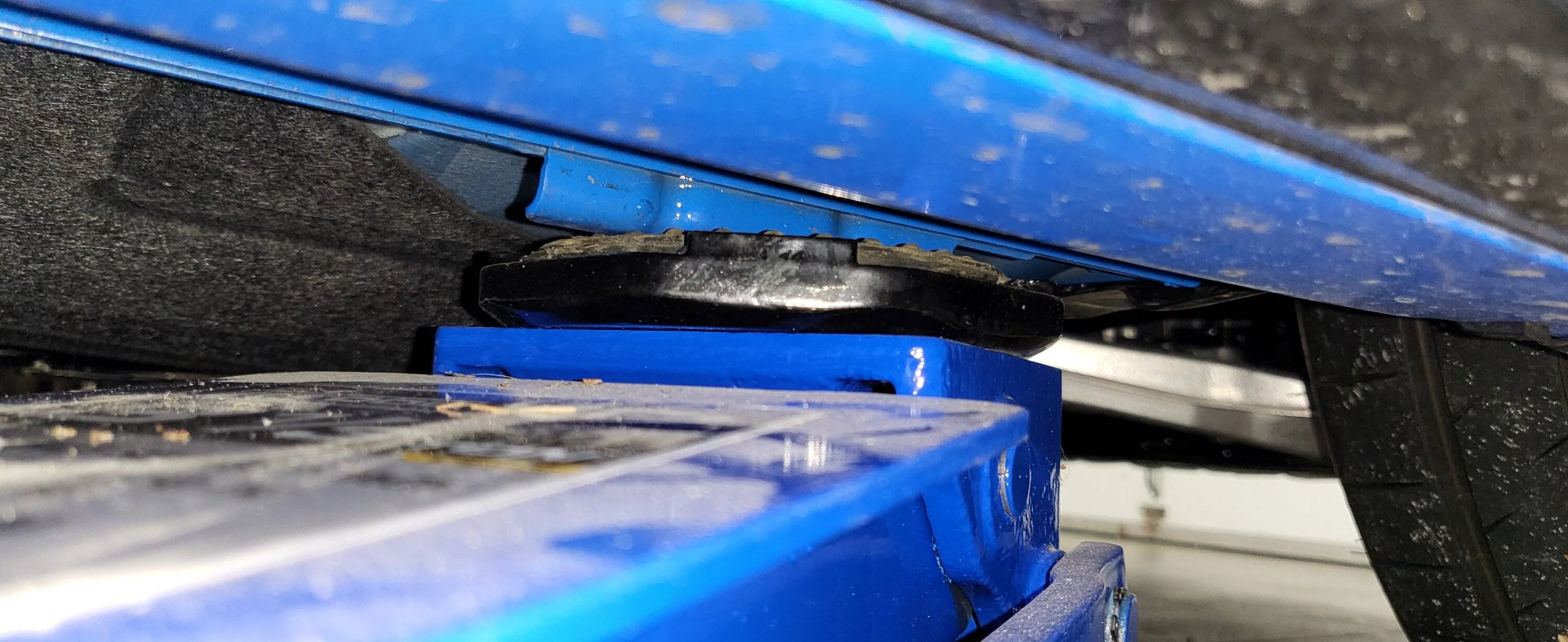

STEP 1: Jack the car up...
11th Gen Honda Civic Here's how to remove shipping blocks from FL5 Type R (my dealer forgot to remove them at delivery) 20221115_202028
11th Gen Honda Civic Here's how to remove shipping blocks from FL5 Type R (my dealer forgot to remove them at delivery) 20221115_202114
11th Gen Honda Civic Here's how to remove shipping blocks from FL5 Type R (my dealer forgot to remove them at delivery) 20221115_202232

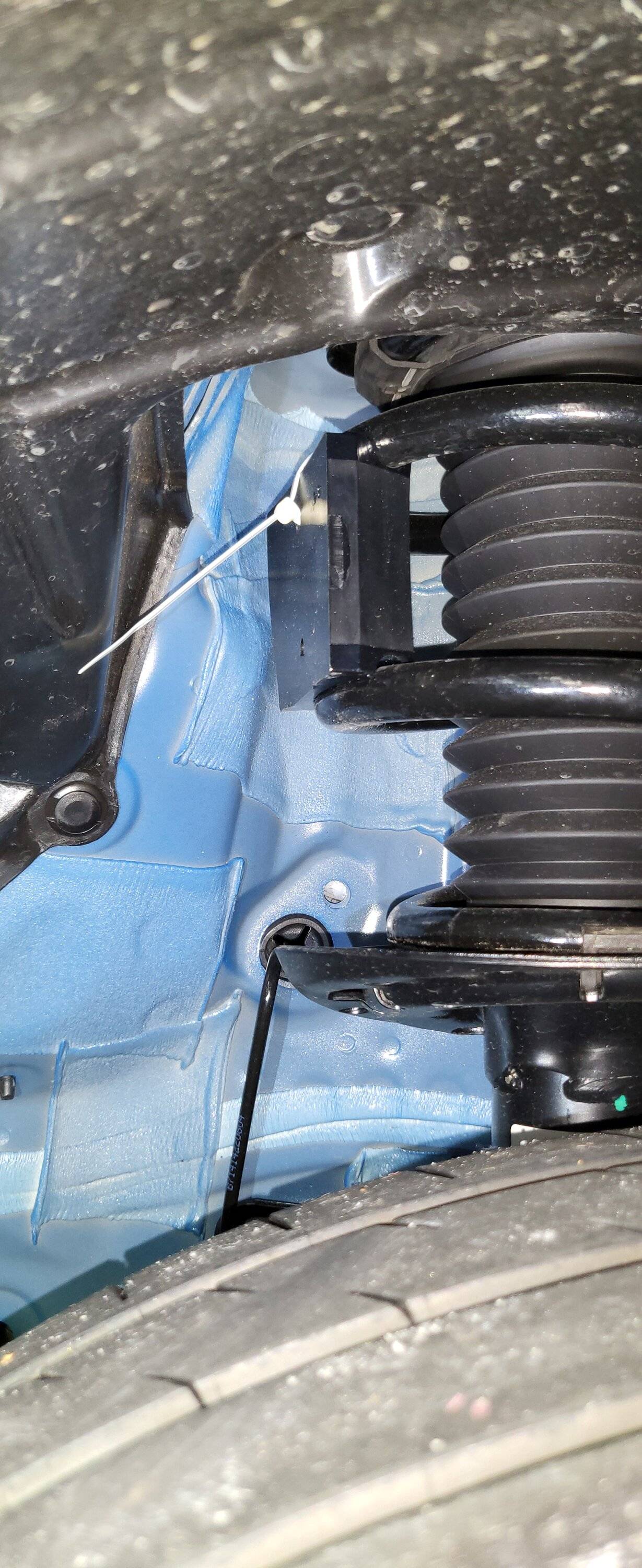

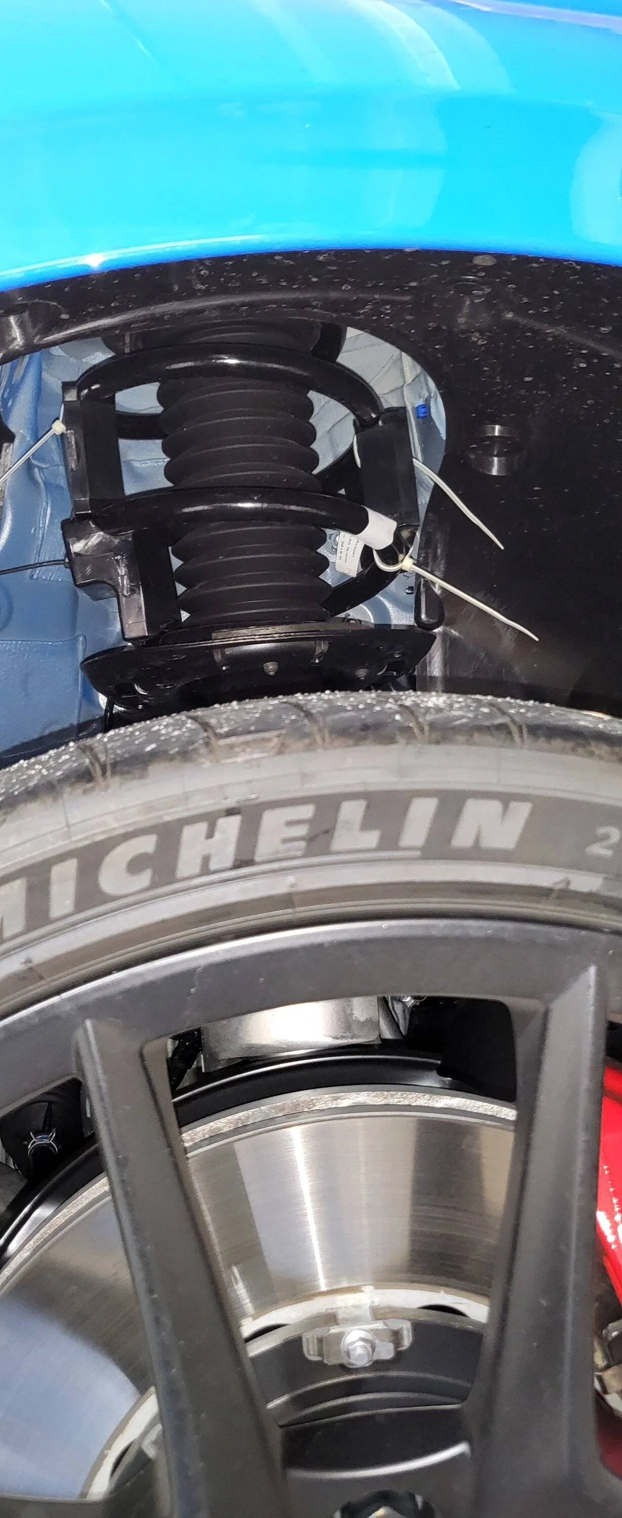

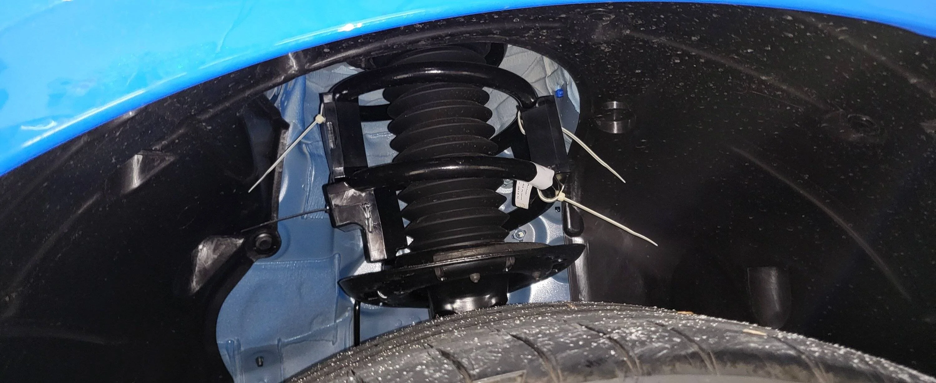

STEP 2: Locate the three blocks secured by 4 zip ties.
11th Gen Honda Civic Here's how to remove shipping blocks from FL5 Type R (my dealer forgot to remove them at delivery) 20221115_202248
11th Gen Honda Civic Here's how to remove shipping blocks from FL5 Type R (my dealer forgot to remove them at delivery) 20221115_202309
STEP 3: Cut first bottom zip tie on the front block (I don't think order matters, this is just what I did)
11th Gen Honda Civic Here's how to remove shipping blocks from FL5 Type R (my dealer forgot to remove them at delivery) 20221115_202406

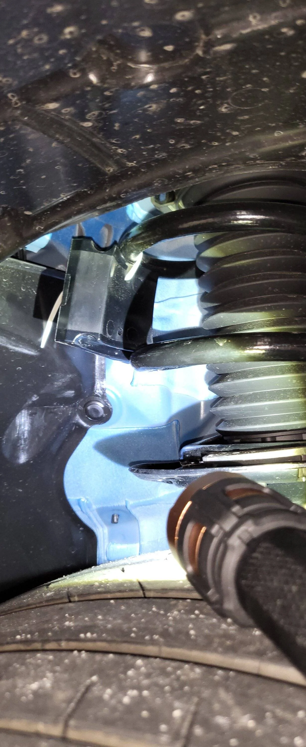

STEP 4: Wiggle block to create space to get to top zip tie; cut top zip tie
11th Gen Honda Civic Here's how to remove shipping blocks from FL5 Type R (my dealer forgot to remove them at delivery) 20221115_202632
STEP 5: Wiggle first block free after cutting top zip tie.
11th Gen Honda Civic Here's how to remove shipping blocks from FL5 Type R (my dealer forgot to remove them at delivery) 20221115_202706
STEP 6: Wiggle bottom rear block to access single zip tie
11th Gen Honda Civic Here's how to remove shipping blocks from FL5 Type R (my dealer forgot to remove them at delivery) 20221115_202800
STEP 7: Cut zip tie and remove block
11th Gen Honda Civic Here's how to remove shipping blocks from FL5 Type R (my dealer forgot to remove them at delivery) 20221115_202855
STEP 8: Wiggle top block to access zip tie
11th Gen Honda Civic Here's how to remove shipping blocks from FL5 Type R (my dealer forgot to remove them at delivery) 20221115_202917

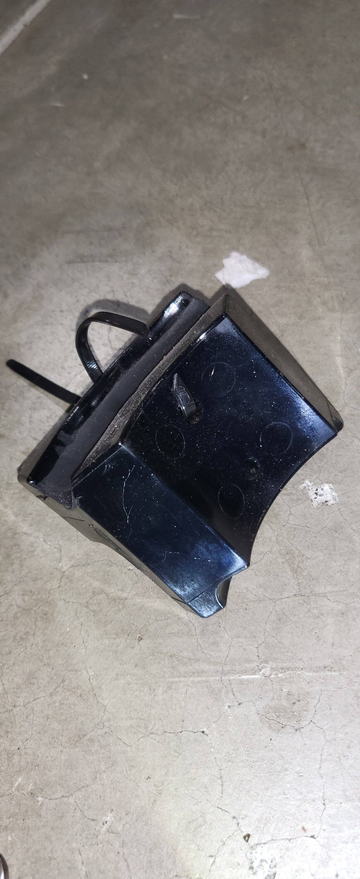

STEP 9: Cut last zip tie; wiggle/pry block free
11th Gen Honda Civic Here's how to remove shipping blocks from FL5 Type R (my dealer forgot to remove them at delivery) 20221115_202951
11th Gen Honda Civic Here's how to remove shipping blocks from FL5 Type R (my dealer forgot to remove them at delivery) 20221115_203112
