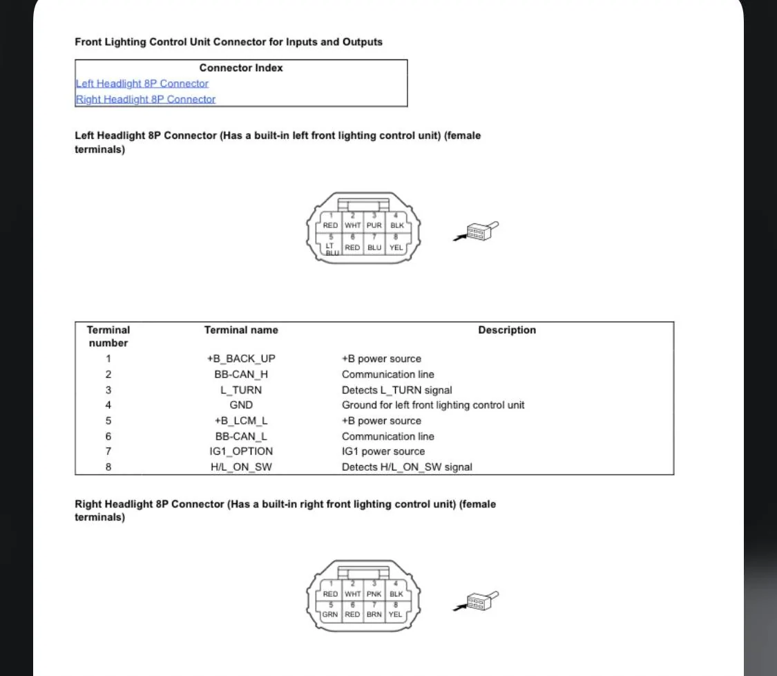

This is one of the many pages related to the 2022 civics
Are these similar to the pins for the 10th gen? Can you please share the link to this doc?
Pretty sure the pins on the 10gen are analog. You should be able to find that info on CivicX. The plug is the same but it only has 7 wires.
Some higher trim levels of Civic 10th gen have LED headlights. Mine is one of those trims.
Mine too but I still don’t think there is any communication to the BCM or any control other than on off. There’s clear communication on the 11th generation.

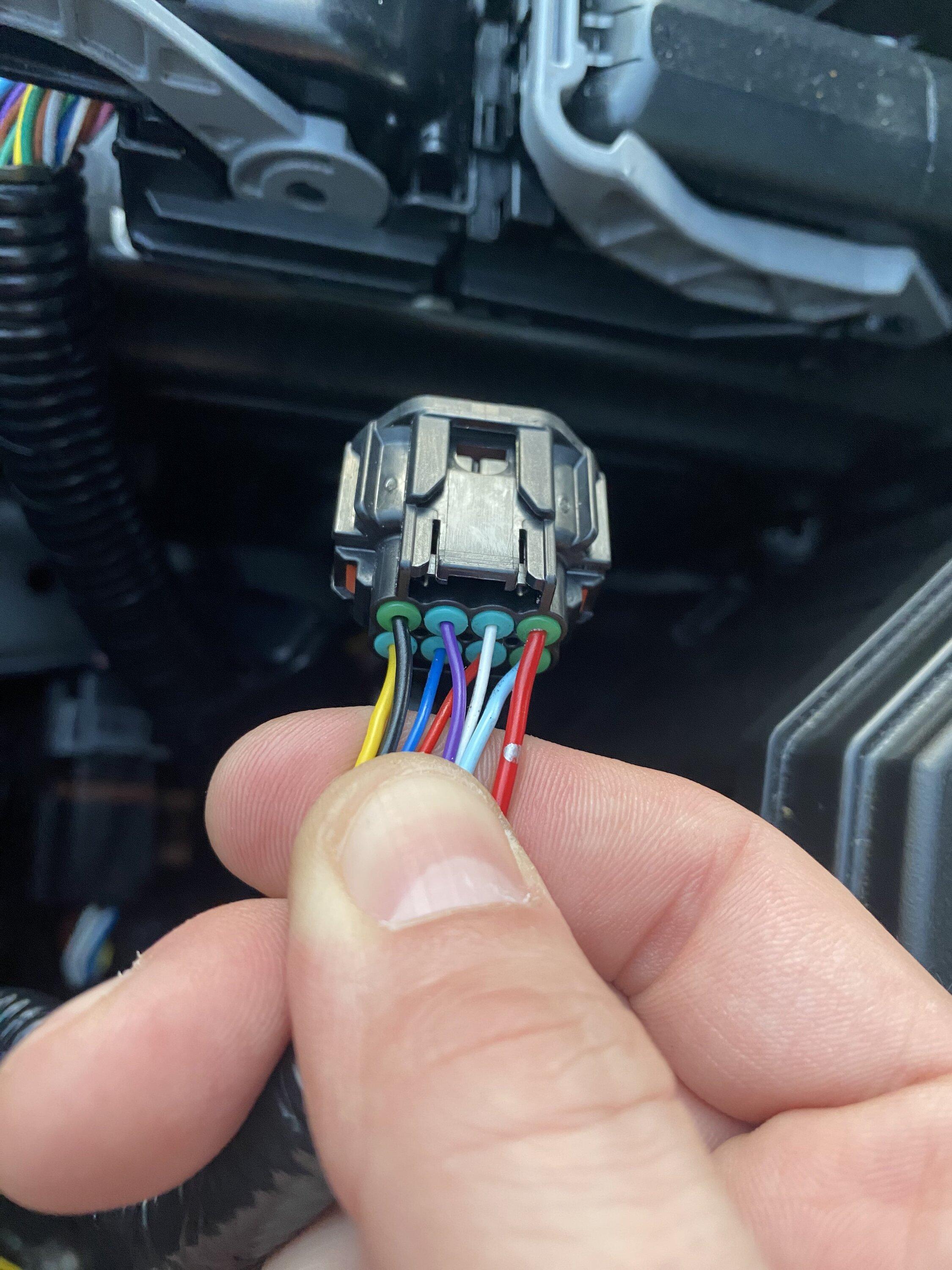

Hey All,
Here is a picture of the Left Light Wiring Harness. Picture from 2023 Honda Civic Sport

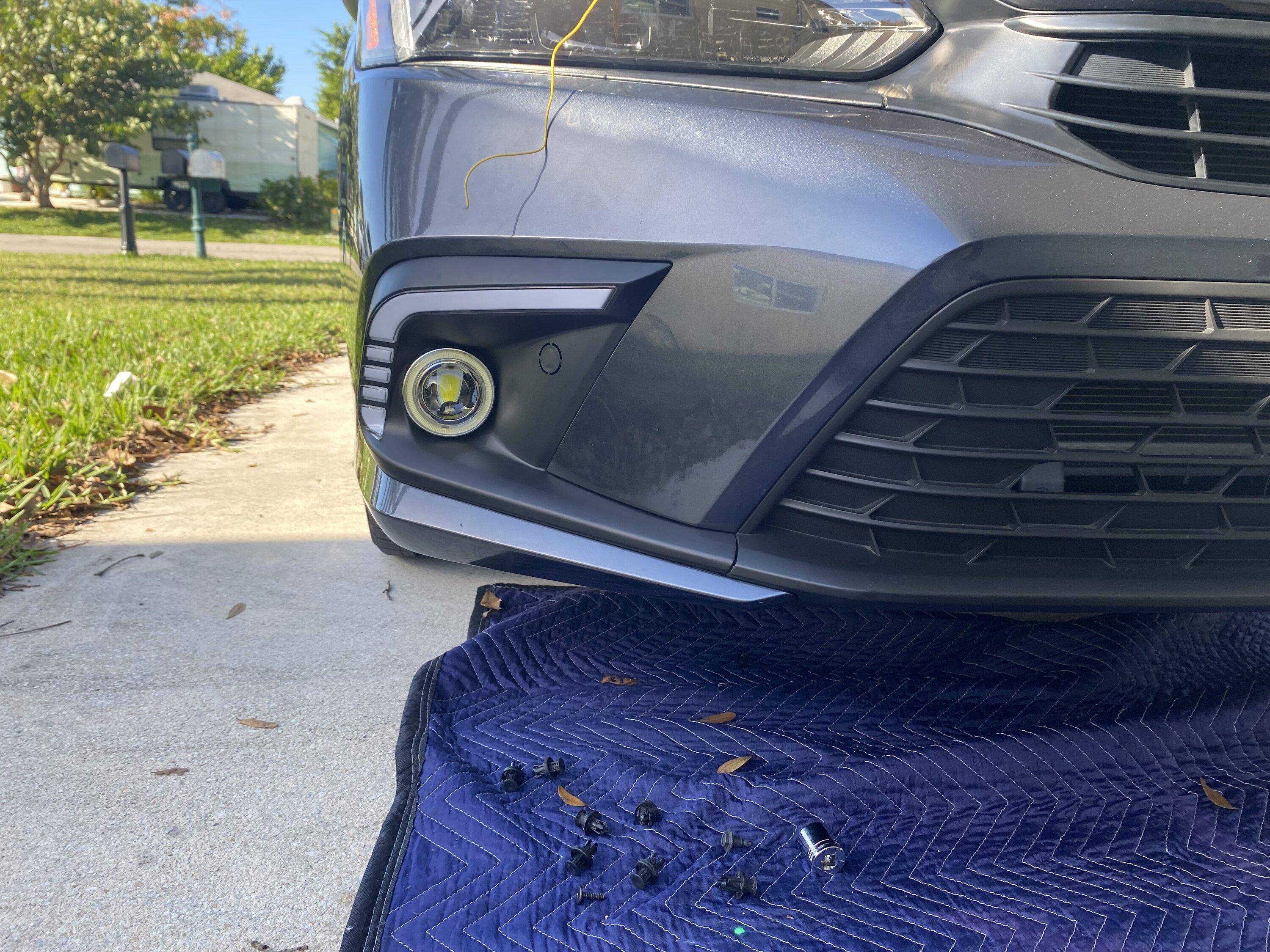

I personally have installed these and just need to finish up the wiring. It is a fog light with halo ring and also signal.
11th Gen Honda Civic Headlight schematics? Img Light
I was hoping someone could provide some advice in tapping into the existing wiring harness. I would prefer to reduce the amount of cutting and splicing into wires as possible. Does anyone recommend these Posi Taps over T-taps to reduce damage to existing harness? Or any other suggestions?

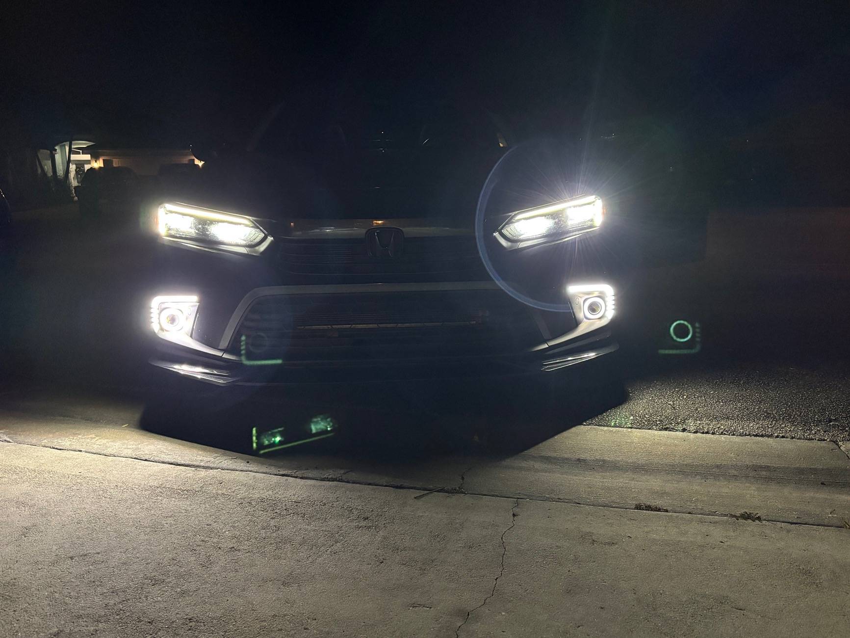

I'm trying to hook up this exact same set of fog lights to my 22 Honda Civic did you ever figure out the correct wires to connect these things to?
Hey, sorry for the late reply. I did end up getting it hooked up how I wanted it. I didn’t want to use the wire that changed the lights to blue. But I got them to work with the daytime running lights the signals and ran the wire for the fog lights. As of recently, one of the halo lights has dimmed significantly. I thought it may have been the wiring, but I’m pretty sure the halo ring is dying out. I think I can replace it. I just haven’t looked into it.
