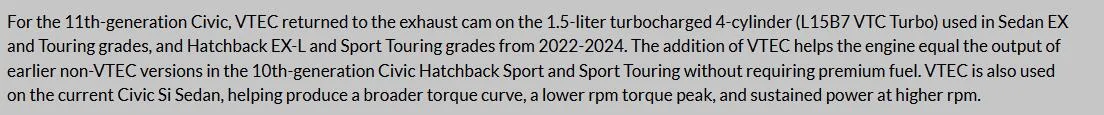

VTEC is only on the exhaust side of the 11th Gen 1.5t. Its not even noticeable when you hit VTEC like on older cars. Changing the VTEC actuation on the 1.5t might not give you the same results as it did in the past with like a K series having it on both intake and exhaust. If you're looking for more power, you're better off tuning and getting more boost.

If you have a sport touring with the L15B7, you do still have VTEC on the exhaust side in the 11th gens, unlike the 10th gens.
And it doesn’t “kick in” at a set RPM like old VTEC. Wide open throttle at any RPM and large amounts of throttle at low RPM will engage the VTEC. It’s entirely to spool the turbo faster, not necessarily for increasing air flow.
