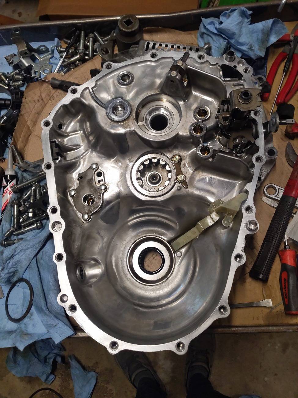

On a side note, I tried to download the factory service manual someone posted on the forum. It didn't work, but I'd like to have access to something with reassembly instructions. Any chance someone with a copy can take a look and share here? I know they can not hit or miss on detail but something is better than nothing...going to try and get the trans back in this weekend most likely. Thanks in advance!

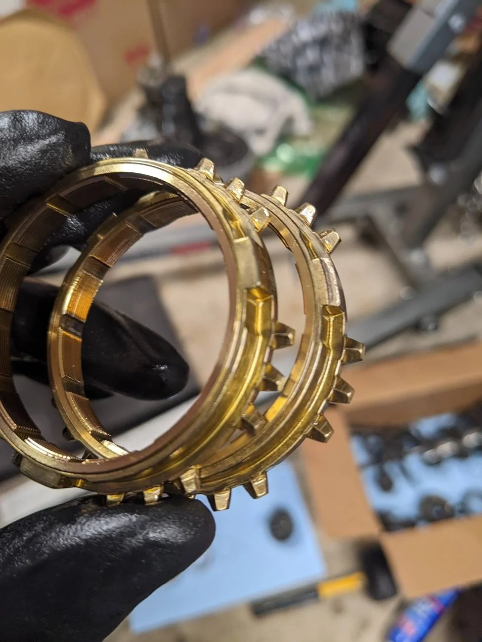

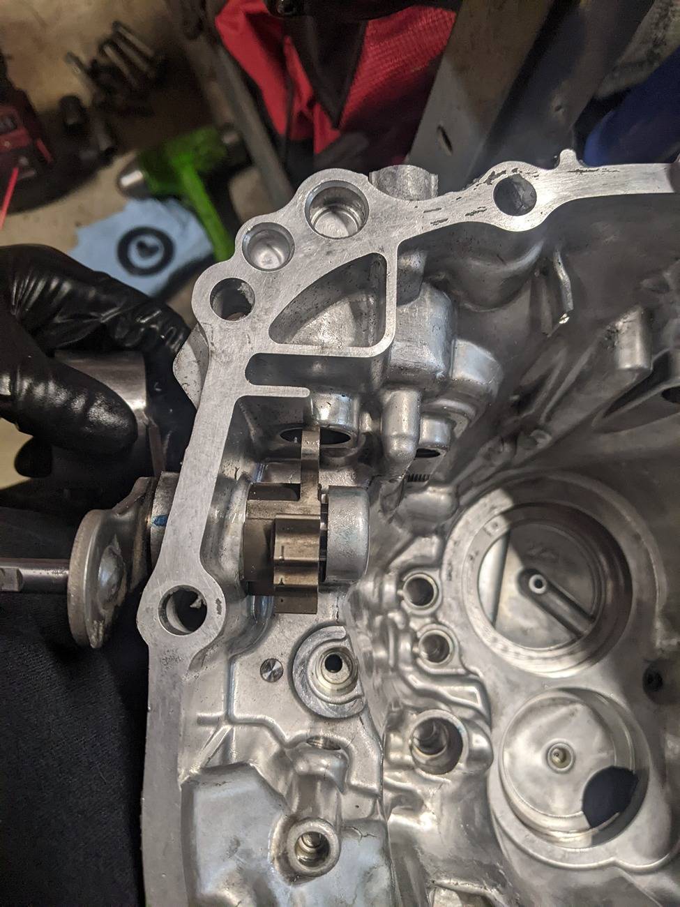

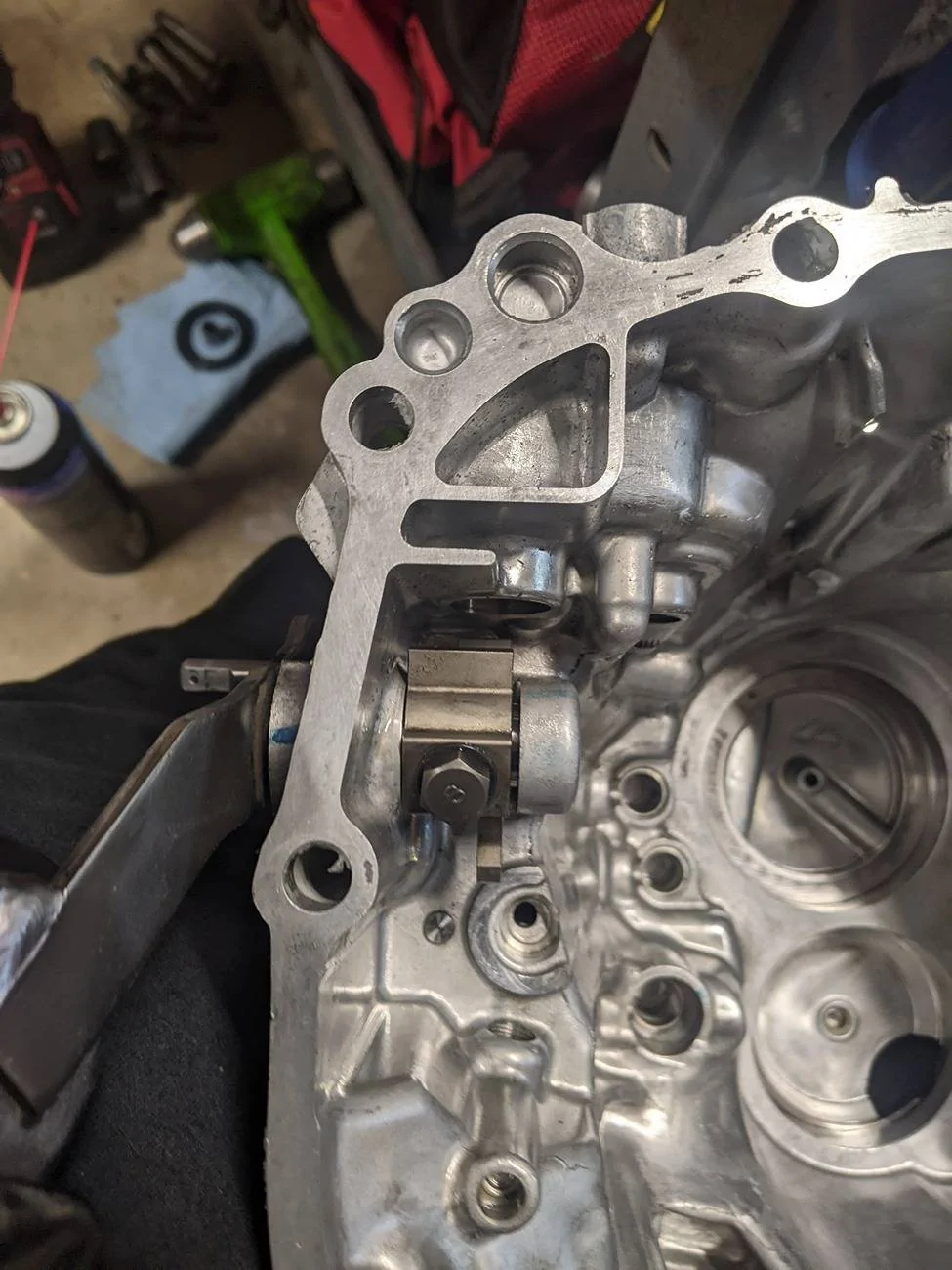

Well first attempt at putting the outer case on was a fail. It was holding up on the reverse gear best I can tell. I can't tell exactly where the shift mechanism should be and I wiggled it around while tightening the case, started to try and tighten it down and heard a pop. Turns out I messed up the reverse synchro. I was able to steal the one off my parts trans, but I tried to reassemble dry this time and it still feels like it's hanging up somewhere. I may just have a trans shop finish assembly. What are the odds someone has had one of these apart and can give some guidance? They seem almost identical to an FK8 trans.

Sounds like you have some fun projects in the past! The love is gone at this point but it'll come back once I can move past the trans issues. Woke up early this morning to give things another go before work. Thought I had it this time but once it was all together one of the shift arms wouldn't move, so hopefully I didn't mess up something else. Three local trans shops said they don't do manual trans anymore, one quoted me $2500-3000 at which point I could just buy an eBay special. ( There are like 3 or so). I did find a few shops out of state, one shops says $2300 to rebuild and about $300 shipping. Just hate to give up when I feel so close...I may call some Honda dealers near by to see if any will take a swing at it

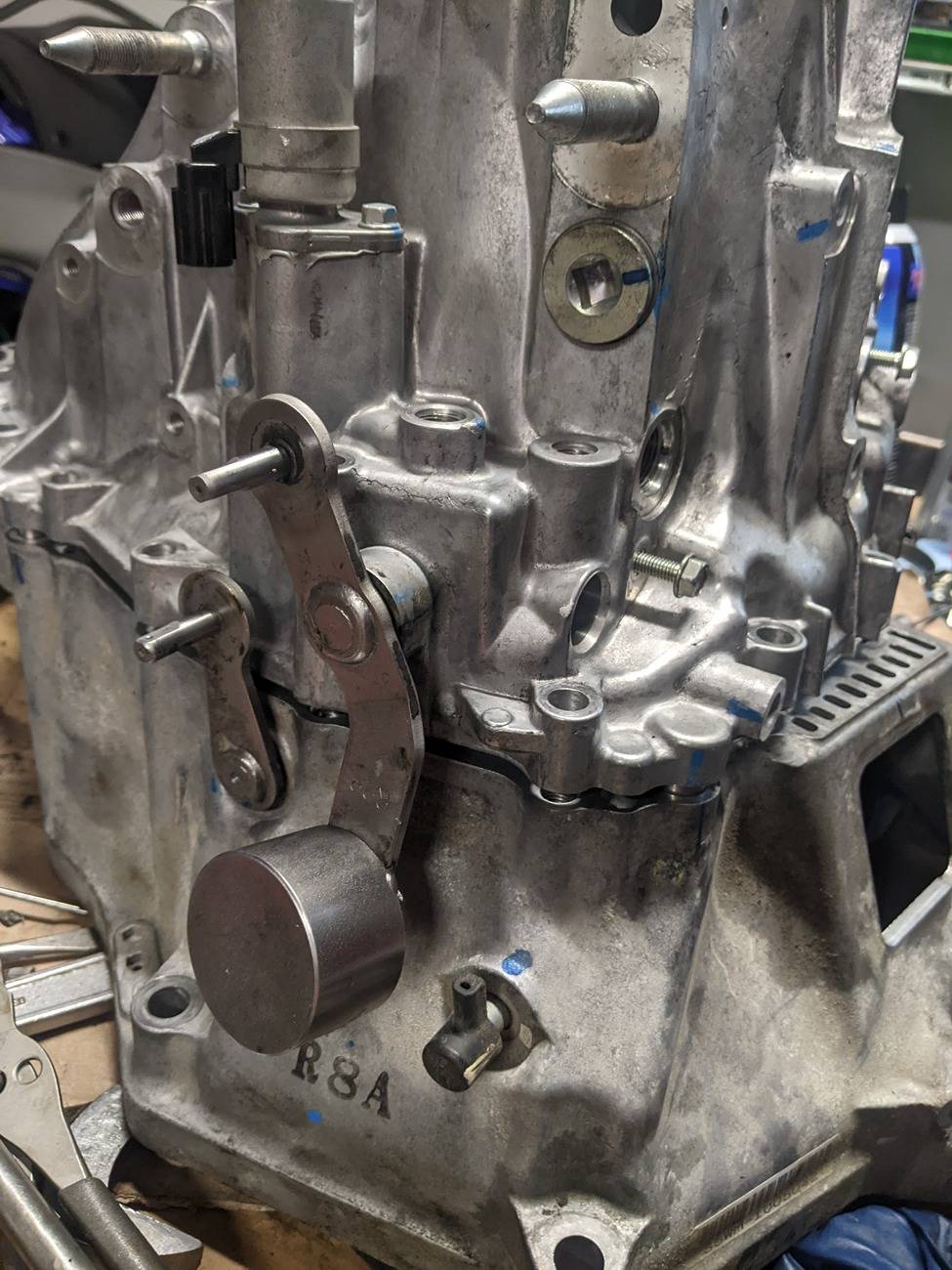

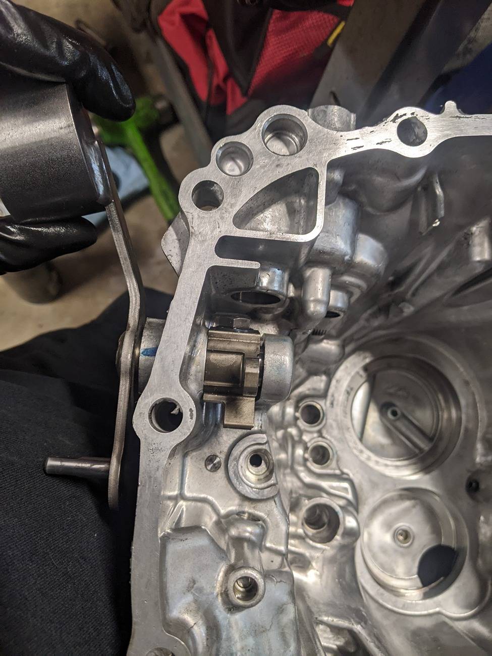

Ah man, that is rough to hear. Access to Honda factory information would definitely help the reassembly; I glanced at another subscription service I have access to but it isn't clearly lined out with reassembly. I grabbed three screen shots of images shown, related to the shifter, maybe this helps you out.

Thanks for the screenshots. I feel like I am overcomplicating it but something is off. I'm going to take it apart and try again tonight. A friend of a friend works at a Honda dealer and said he would help me out this weekend if I can't get it.

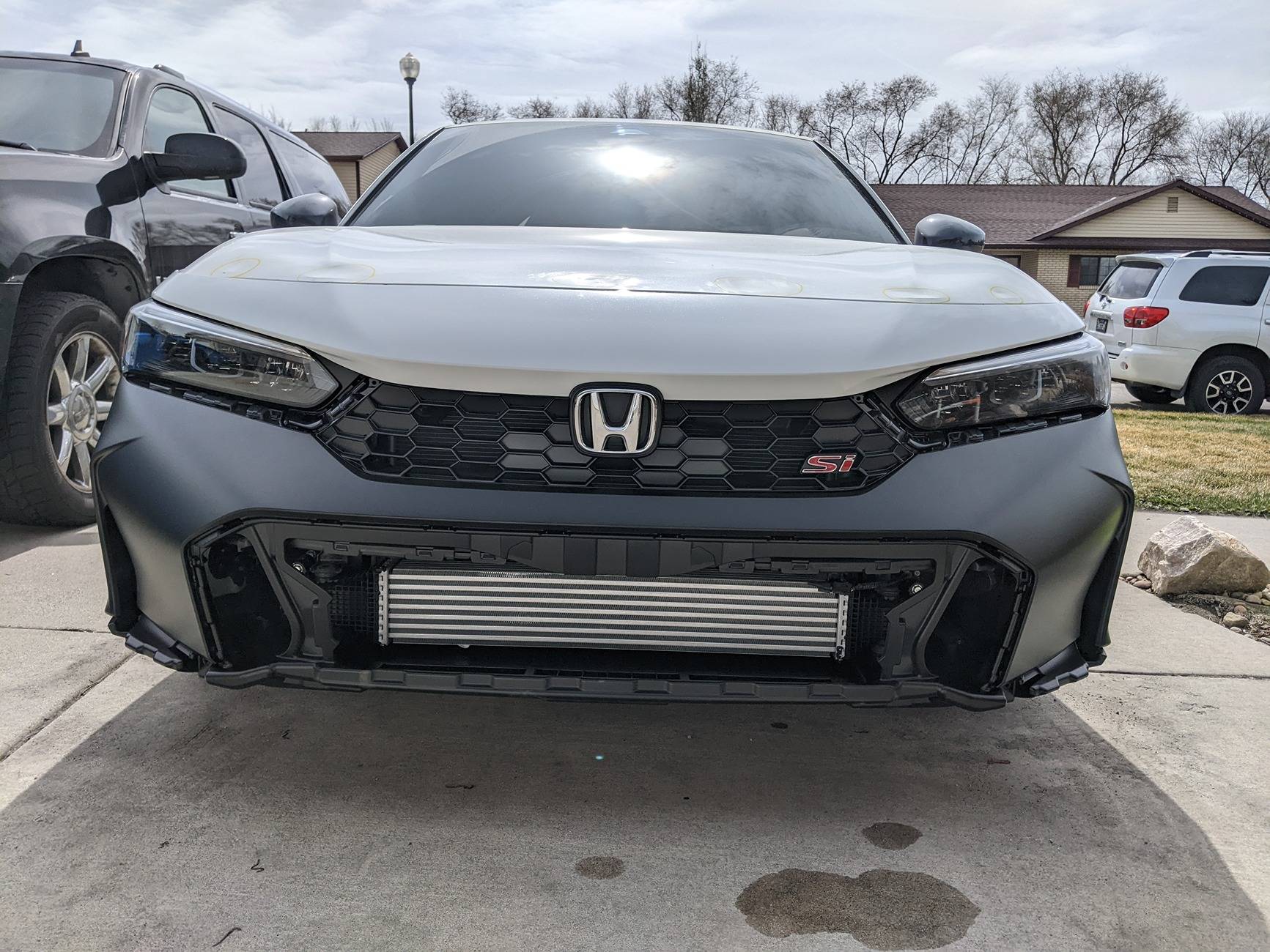

To add some context to the title of this thread...I looked/ bid on several FL5s over a couple months span. Finally decided to bid on a 2025 si when those all went too high. I won that, then a couple weeks later this one came up and I decided to bid. Long story short, Yes I am ambitious, in this case I bit off more than I could chew lol. I'm making good progress though. The Si got dropped off for paint yesterday. It only has 300 miles, pretty crazy. Super nice car but I was always going to want the Type R.

A friend of a friend in a local S2000 group works at Honda dealer. I tried to set it again yesterday and the shift arms still didn't feel right. This dude said to bring it up to his place tonight so we could take a look. Hopefully he has the magic touch!
