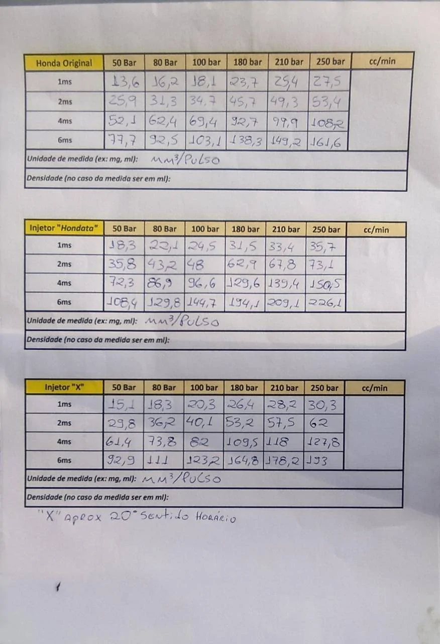

1530´s flow around 1435 IIRC. I did a bench test on stock, 1330s and 14xx and I have all the data on them on multiple pressures and multiple pulsewidths with different test fluids. and it never showed anywhere near 15xx

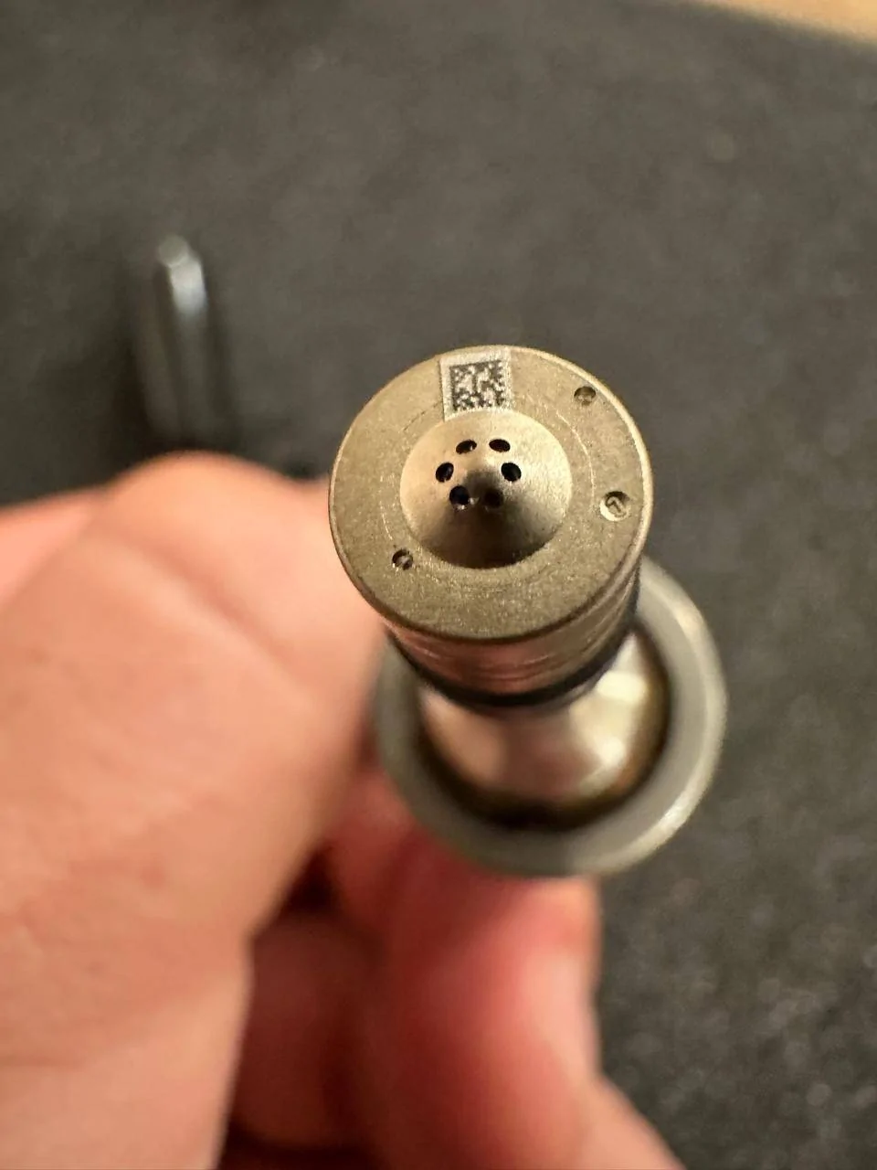

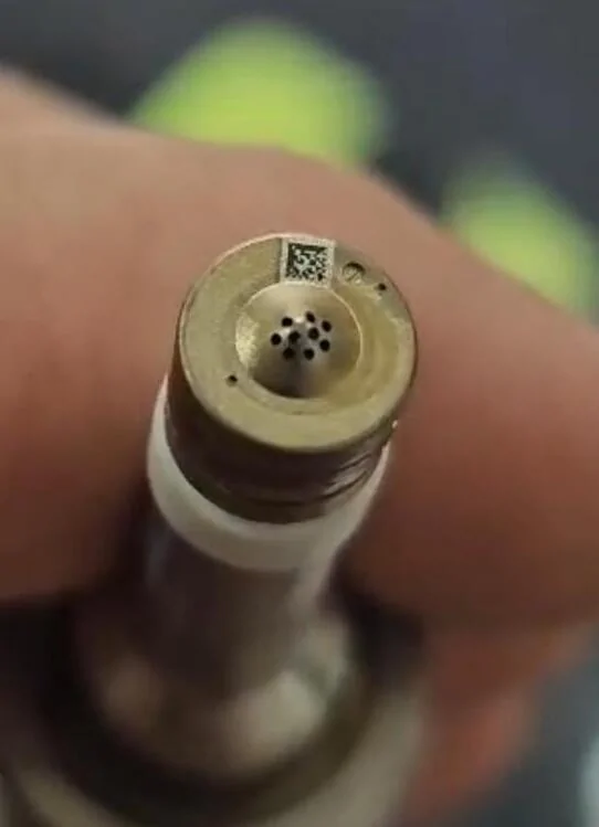

I can´t publish all the data but I can share some stuff once I find the papers. The person who ordered the test owns the data at this point.
The spray pattern is very good because it is an OEM injector with 2 additional holes in it. It´s done properly and precisely. I examined it under a microscope and it is very well done. I´d say it was done using EDMbut I´m not sure. The flow was very similar also across all 4 injectors of the 14xx set.
The 1330´s are a repurposed injector originally from another platform. I can´t remember what is the original application (could be ford 3.5 ecoboost but I´m not sure I have to check my papers) but even if I could I would not reccomend them since the atomization is good on the bench but the spray pattern is very different from stock and this is never a good thing on DI.
I didn´t test XDI parts because I didn´t have the time at the moment and now the timing is bad for me but I can say that Uwe (the guy behind the company) came from Bosch Motorsport and I had many people there say great things about his knowledge on everything DI related so I would be more inclined to believe that people who experienced problems most likely had bad tuning.
A cool thing about injector development is that it is very hard to simulate how evaporation happens inside the combustion chamber so a great part of developpping injectors is making half a dozen different injectors and putting them to test to find the best one.
Another thing to add is that the k20c1 combustion chamber seems very efficient at atomizing the fuel into the air charge when comapred to EA888 engines for example. This makes using big ass DI injectors a reality that is not possible into many other modern egines. Look at the numbers John Pierro has made using DI only, it´s crazy.
14xx´s

1330´s

According to my tests:
OEM 1031cc
Hondata 1330 1232cc
Hondata 1530 1447cc
11th Gen Honda Civic Fuel Injector Recommendations 1733354861761-cj
I would like to add that I am just sharing this for general knowledge and even though I disagree with the injector flow numbers shared by Hondata, the 1530´s or 14xx whatever, are still my favorite injector for this platform. I run them on my personal car as well as the Hondata HPFP because I know what kind of pump it is and I know it´s the most reliable option.
