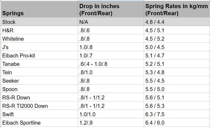

I called Fortune Auto this morning and their sales guy ran in back to talk with R&D. R&D said that during in house testing they found the softer front rate allowed for the front to have increased turn in and less understeer, while making the back end a little bit easier to rotate.
I'm still waiting on my delivery so I can't say how balanced the car is out of the box but my general impression is the rates Honda chose were pretty well received.
Given this is the current (nov '24) rate choice of the rest of the aftermarket it's either brilliant or a weird choice. Note that H&R and Whiteline do go a little softer in front, 7%, but not 48% softer. We can also see a pretty solid progression of lower = stiffer and if they are claiming a 1.5" max drop that 2.5k seems -really- soft.
I would be curious if they took the car out on a track or just drove around spirited backroads or canyons to determine this. As you stated, with the 2.5k rates I can easily see this causing more roll and dive under braking when track driving. Hell when I tracked the stock suspension it had a lot more roll than I was expecting.
