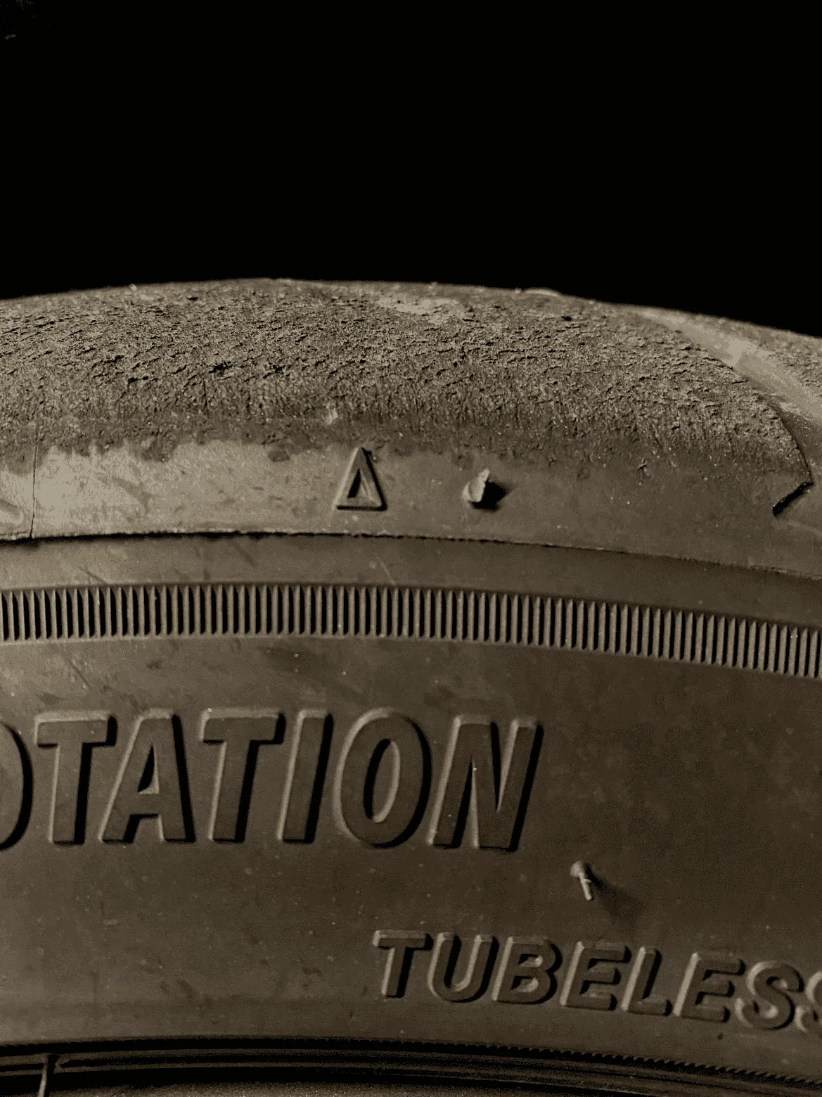

i wouldn't go past the maximum negative camber (without pins) on a street car. you'll probably get around -1.6 +/- 0.2. beyond -2, you're looking at aftermarket suspension parts and uneven tire wear. just not worth it on a street car IMO.
after each session, look at the triangle located on the sidewall. tire wear shouldn't go past the triangle. if it is, bump up the tire pressure. that will stiffen the sidewall. you may find that you may need go to as high as 40psi. with the stock 4s tires, i don't think you'll need more than 40psi to prevent extreme sidewall rollover.

Excellent tip thank you.
