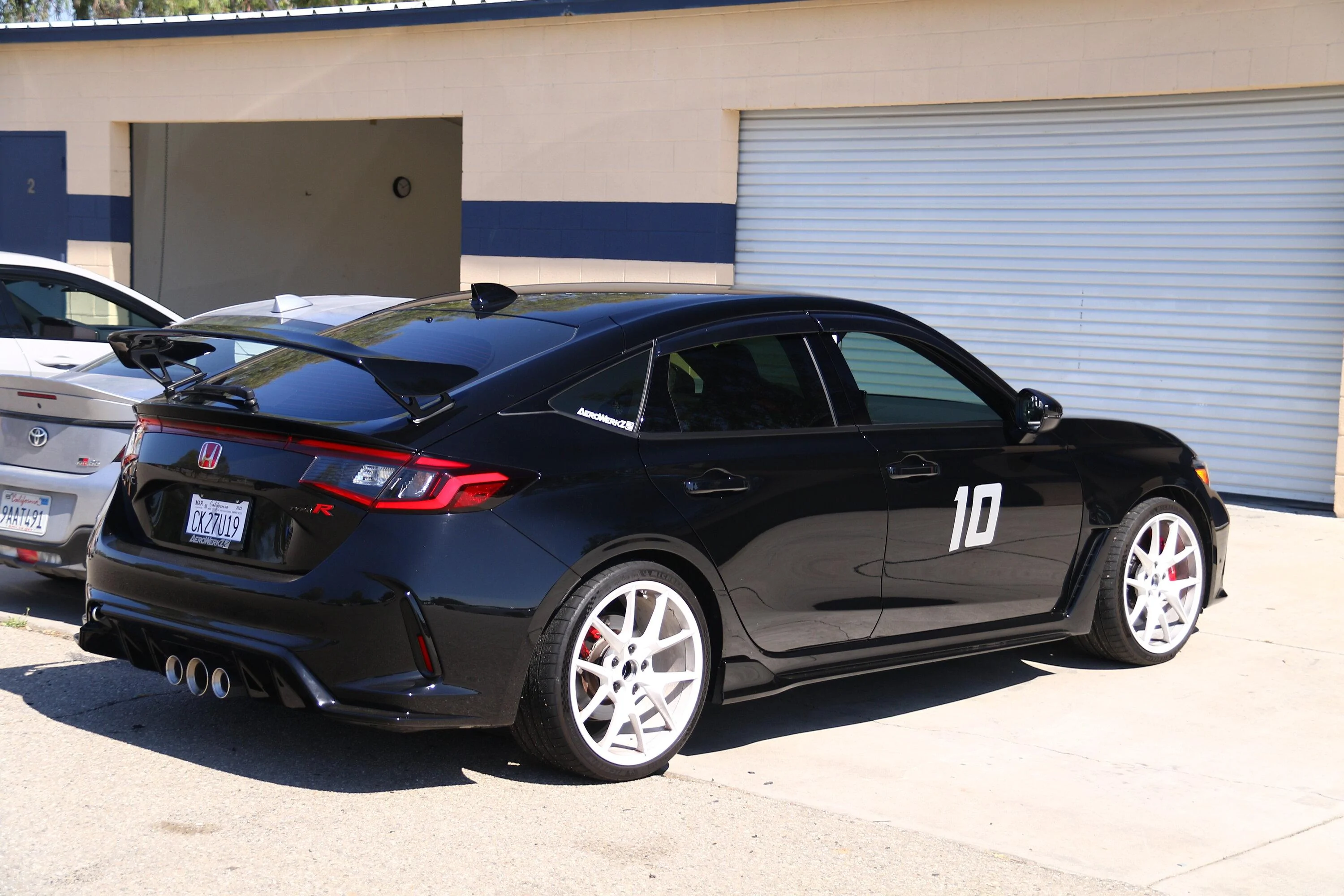

side note and update regarding my wheels... I pulled them off to put on a wheel balancing machine and both wheels are bent like an oval... im sure its due to the powdercoating i had done...
Anything's possible, I suppose, but I would be surprised. Powder coat typically bakes around 350 degrees; aluminum melts at 1,200. :dunno:
By the way, I love your set up. The white wheels look great on black -- I'm considering doing the same if/when I get my FL5.
Edit: Before someone corrects me, yes, different alloys have different melting temperatures.

thanks! i loved the look of the oem wheels in white and its such a bummer that they got bent/warped into an oval.. i'm actually so depressed that it happened. I had the oem centercaps out in paint to get color matched too.. however i am swapping to te37 sl's 18x10 +40 so hopefully a meatier tire would help a lot
