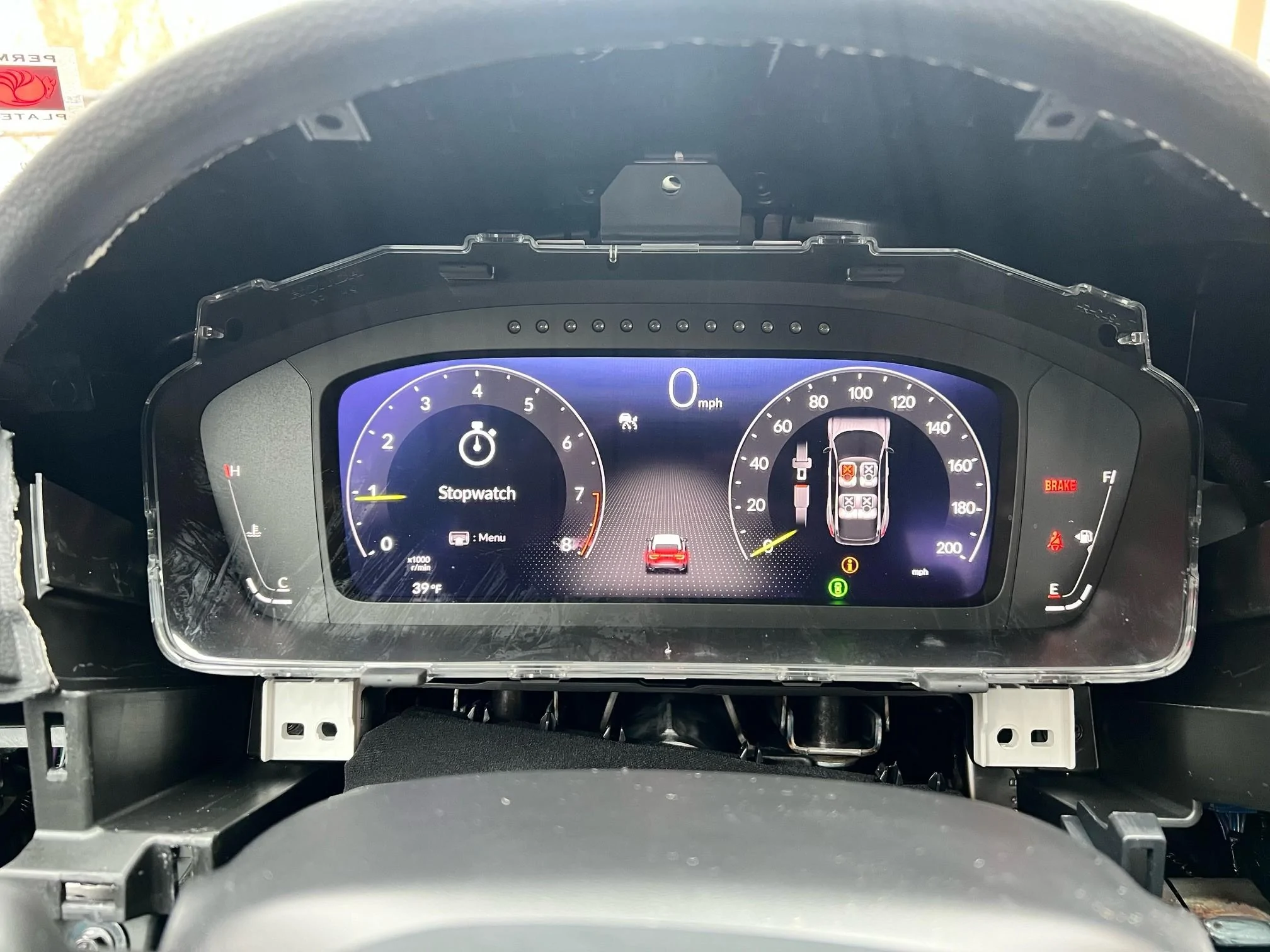

Got bored and bought some parts from a crashed '23 Civic Type-R. Most likely will sell off most of the parts, but I wanted to try something different. Am I the first to do this? Not sure, but figured why not share with the group. The digital cluster found on the FL5 is a lot nicer than our US spec single digital left gauge (RPM).
Results:
The cluster actually started right up without any issue what so ever. Sadly all the switches for the SI due to a single digital screen are different than the Type-R or even to this matter the Canadian SI's
Note: Active damper system warning did come on since the FL5 does have that system equipped.

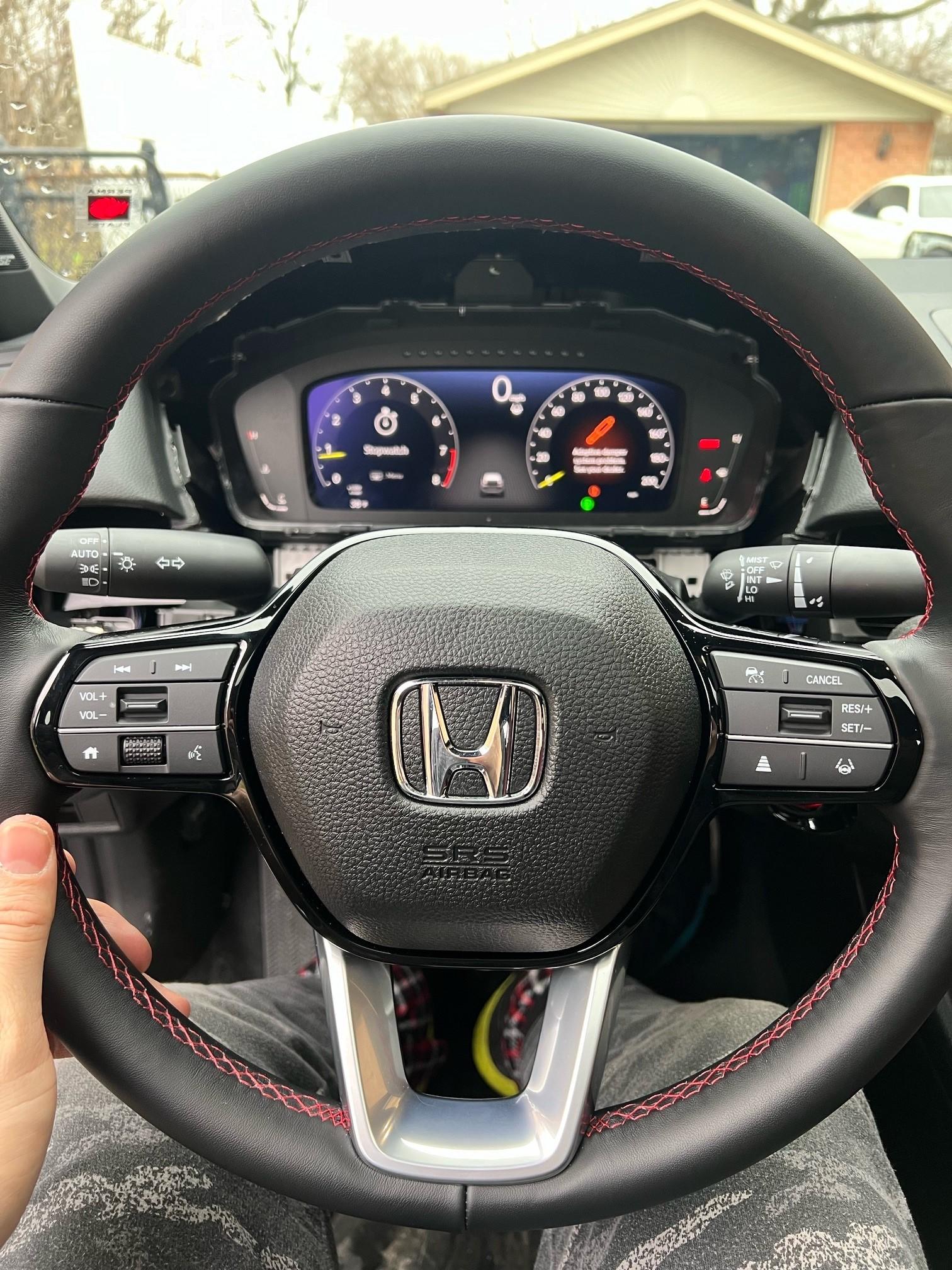

So, what is next? . I purchased a Type-R wheel with switches and I will let everyone know if the actual cluster can be used with those controls.
To be 100% honest, if I found a Canadian Civic Si cluster that would most likely be the best route for our US SPEC Civic Si's. I plan again to sell off all the type-R parts I have collected. This is just something fun for me to do.
Hope you enjoy this small semi-useless thread, but it is always fun to try to new things. Cheers ?
2/14/24 - Update:
I was able to order Type-R steering wheel controls, cluster works perfect. I also ordered the type-R mode switch panel, sadly even after reviewing wiring this does "NOT" currently turn the cluster into R-Mode. My guess the functionality is store in the actual radio behind the dash and then uses can bus to send a signal to the cluster. Funny thing is if you look at the wiring it's a single pink wire that goes from the switch to the cluster. When you press *R-Mode* all you're doing it ground the switch. However, after wiring the switch the cluster still never changed. Little bit of a bummer, but I did not expect it to work.

Here is what I have so far (knowns).
1.) Shift lights work, they go all the way to almost all reds, however the shift buzzer does not sound, maybe is it because I can't get all lights to show up? The two middle red bulbs do not illuminate due to max rev's of the si. I bet if you had a honData and increased rev range ot mathc a type-R it would work!
2.) Adaptive cruise works. In fact,it displays the vehicles in front of you and beside you, not sure if the Canadian SI does this as well, if not cool feature..
3.) RPM + Tach both work.
4.) I need my type-r steering wheel to arrive so I can control the cluster more
5.) Adaptive suspension warning stays on
