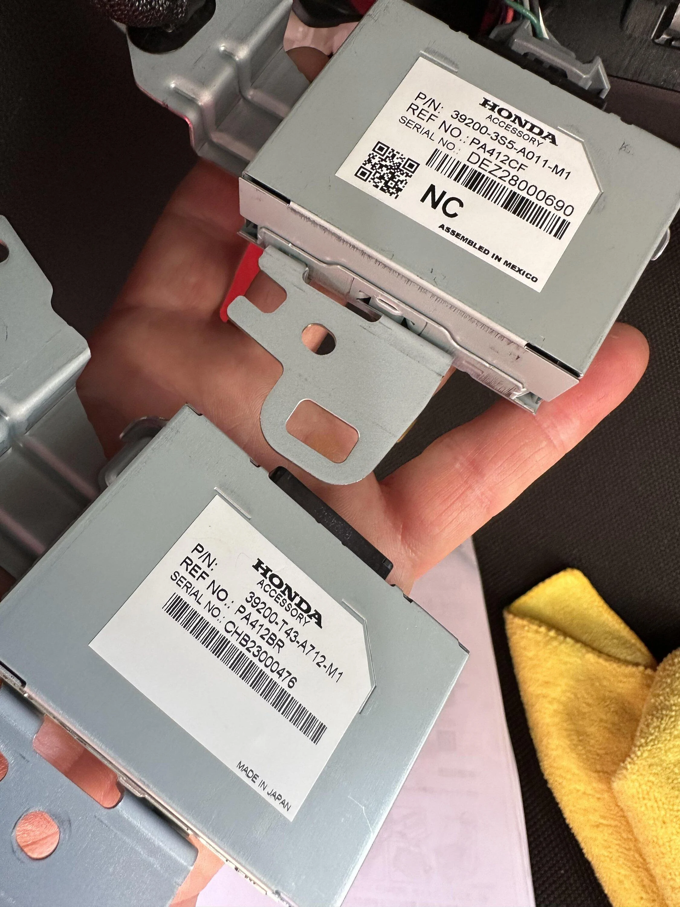

Sure did .. swapped it out yesterday so much better than the CTR module ... not sure what the Japanese engineers were thinking but in +R mode its way too artificial. Now on the other Hand now that I have had a day with out any module plugged in and then another day with the ITS Module on the car and driving around this it is very natural sounding and I almost had to check to see if I was getting any "pumped in sound" well worth it for me since not having anything plugged in was making my OCD trigger :rofl:

Very well! This is the go to for those who hate the Type R fake noise then. Does it work in each mode or is sport and +R mode now have the same sound?
Comfort has zero sound similar to the CTR
Sport has a very slight low tone ( I’d say about 1/3 of what the CTR is for sport mode )
+R now sounds very natural and very in tune with the natural exhaust tone of the car and sounds nothing like the CTR downshifts are the area I notice it the most…. And reving it out you can actually hear the natural engine noise now vice the electronic generated nails on a chalkboard sound that comes from the CTR in +R mode :thumbsup:

Just for reference; proper ITS sound box part # is: 39200-3S5-A01
Ordered for $67 today. I will update with impressions, and hopefully put this to bed.
