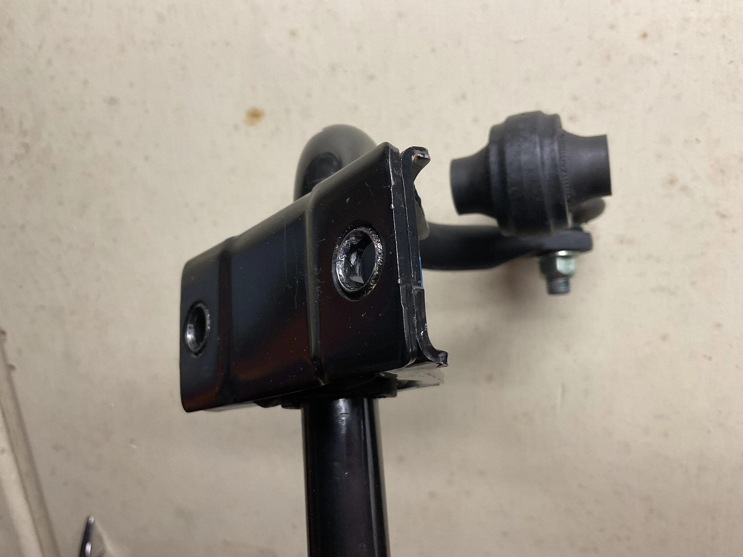

I read on the other forum that is a direct fit but it needs the brackets.Can anyone confirm if the 17-21 FK8 Type R rear sway bar is compatible with the 22+ Civic SI?
Yeah they are, they’re stamped together at the bolt holes and stay on the bar when you remove it. You could drill out the stamped part I suppose. I installed an Eibach bar which came with its own brackets and bushings.I read on the other forum that is a direct fit but it needs the brackets.
Apparently the brackets are integrated on 2022 Civics.
Can someone confirm this?
Yeah they are, they’re stamped together at the bolt holes and stay on the bar when you remove it. You could drill out the stamped part I suppose. I installed an Eibach bar which came with its own brackets and bushings.![]()
Sure thing! I had the whole package, bushings, Accord end links and all.I've been running the FK8 rear sway for several months now and it really balances the car out on rotation. I ran the Tail of the Dragon in June and the car handled VERY well even with the crappy OEM all seasons. You will definitely need the brackets and if your bar doesn't come with the CTR endlinks, I would upgrade to the aluminum Accord units. The stock Civic Si endlinks are hard plastic.
