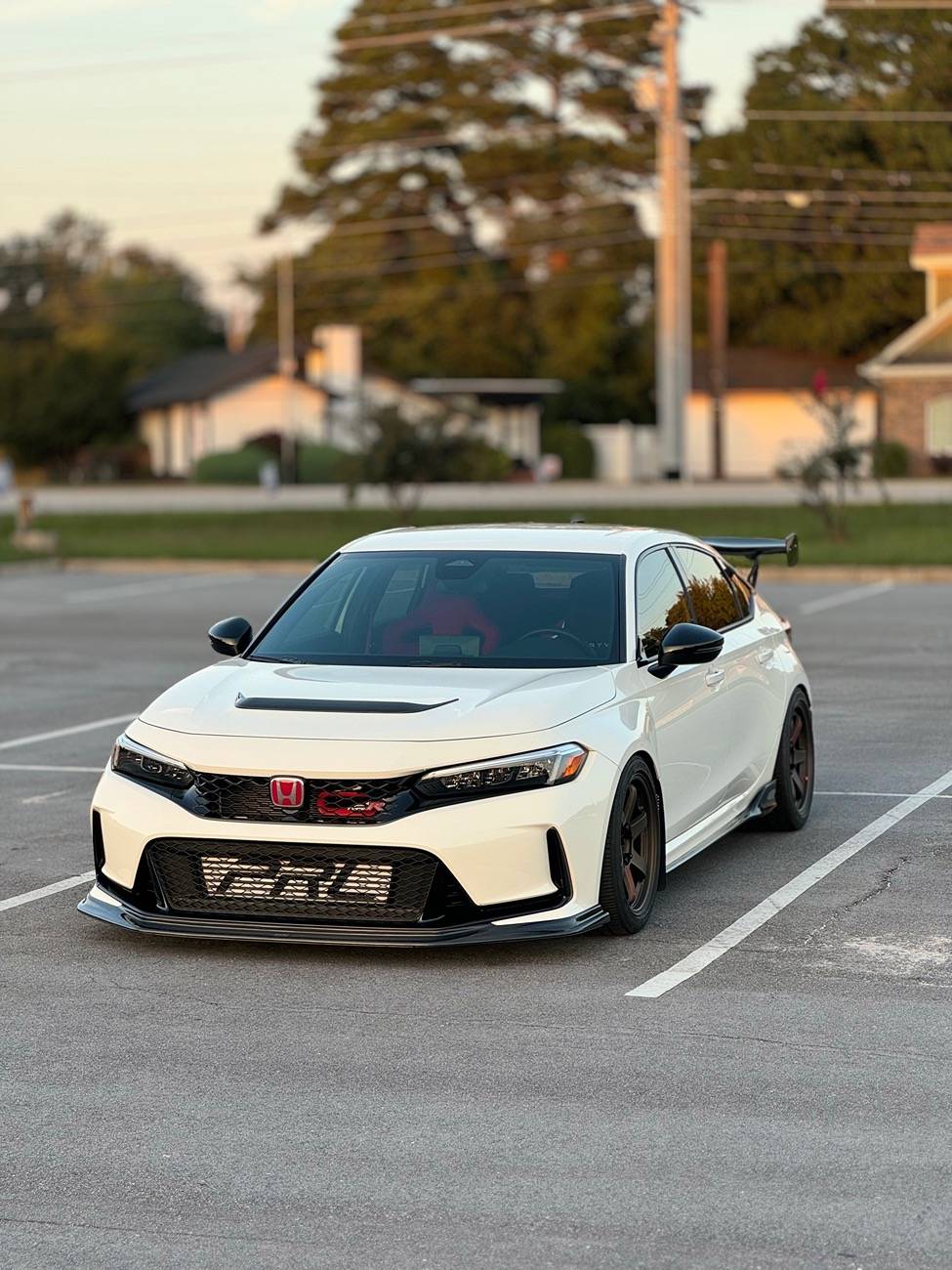

Currently running Eibach’s Sportline kit with no problems. TE37 SL’s running the “Golden” spec 18x9.5 +45 for a clean, flush fitment with Falken Azenis 275/35 tires. Also running aftermarket rear Camber and Toe arms to dial in the suspension and get the alignment back into factory specs.

This is beautiful.
Thanks for the inspiration. I'm assuming this isn't your daily?

Yes! How it should be.
Adding the rear camber and toe arms make a difference with tire thread? Looking to drop, but not sure if adding camber/toe arms is worth it. Want less bounce when in R+

Nice build! What wing is this?

I did notice that the insides of my rear wheels had more wear due to lowering the car, which naturally increases your camber. Wear wasn’t excessive, but still drivable and safe for daily driving. Fronts were doing just fine. When I got my first alignment, it was barely close to factory specs since the factory camber arms are fixed and not adjustable at all, so I decided to buy adjustable camber and toe arms to fix that.
I’d like to note that if you only install adjustable camber arms, you’ll be able to bring your negative camber into factory spec, but adjusting your camber moves the toe alignment. With the factory toe arm, the adjustments isnt enough, so by doing both camber and toe arms, factory alignment specs was achievable. Can you still drive without camber/toe arms? Yes. But for me, I want my tires to last long and wear evenly.
In regard to the bounce, you can either get the Type S ADS module which will soften up your factory dampening system. From what I know, Spoon lowering springs (updated version) and Eibach’s Pro kit have mild spring rates that isn’t too aggressive if you’re not going with coilovers.
Thank you! Carbon Fiber wing is by Garage Unique and is a direct bolt on to the factory mounts, or other aftermarket risers that still uses the OEM mounting points.

this is perfect to me. Did you go with the sportlines because you were changing to 18s?

I already had my 18” wheels before installing my springs. Even with beefy 275/35’s, I didn’t like the horrendous wheel gap it had with OEM springs, so I decided to take the more aggressive approach and get Eibach’s Sportlines over their Pro Kit. No regrets, especially since I’m not rubbing at all.
