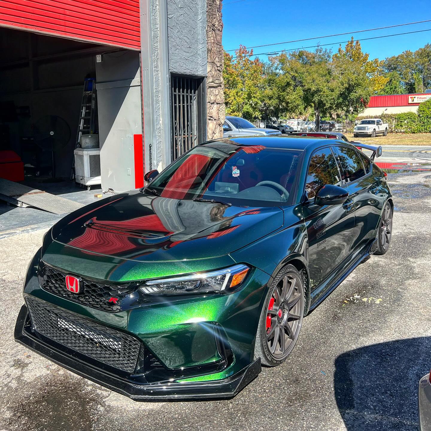

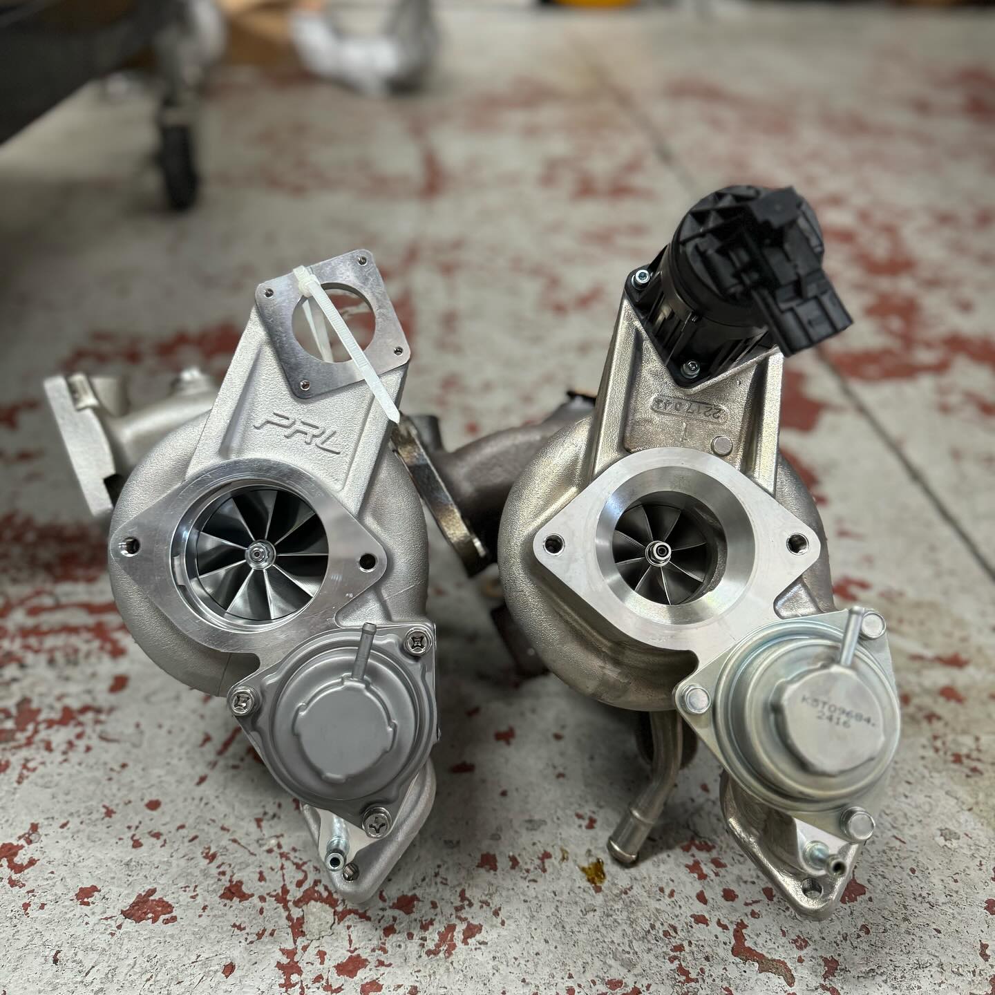

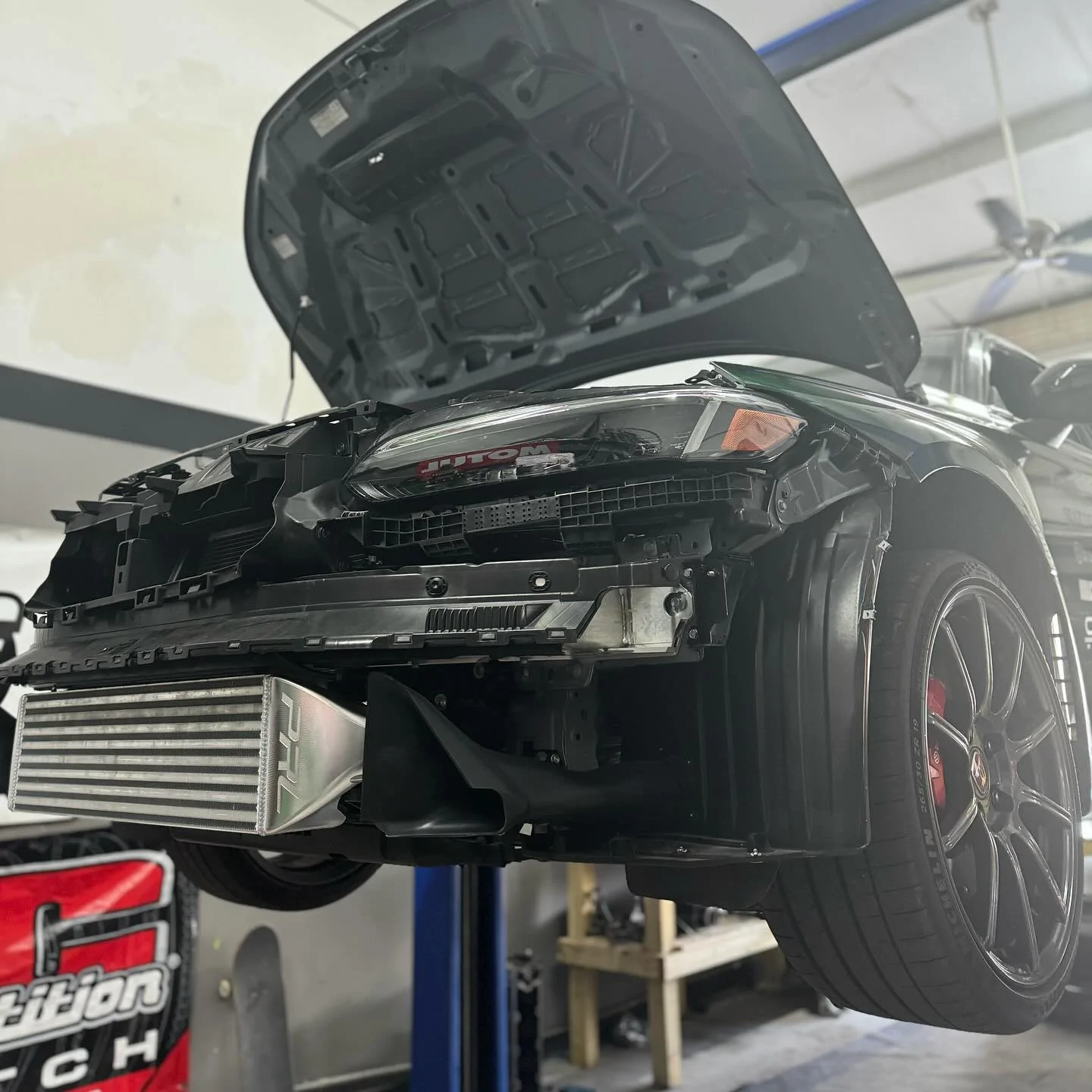

Hey guys, just got dyno done and I have seen other people's ctrs with less mods making more power. Its not a huge deal to me I am still happy with the gains, just wondering if by your guys experience if I should be getting more power. Should I try another tuner? Btw dyno was done on 93 not e85.
Tuned on 93 - 434whp/375tq
Full Power Mod List currently installed
Prl P700
Prl Intercooler
Prl Front Pipe
Hondata Jailbreak + Tune
Pipercross Intake
Hondata Fuel System + Hondata fuel pump kit
Cobra Sport Valved Exhaust System
PLM Catted Downpipe
