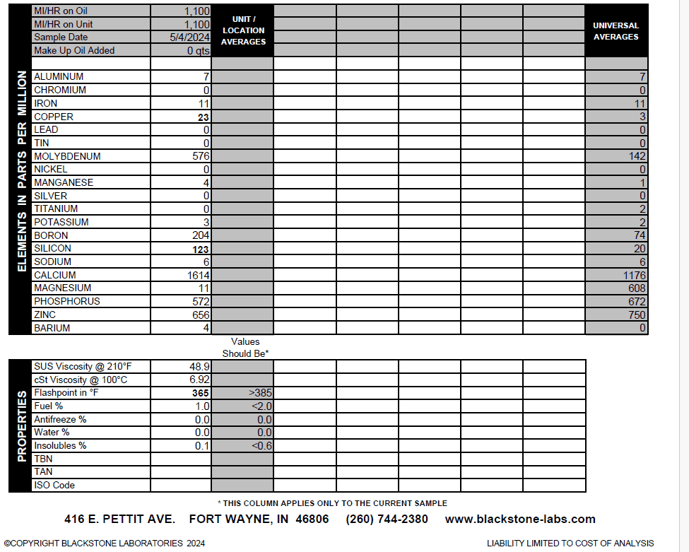

Here is my 1100 mile break in oil from my FL5

I’ve also heard this, but I have yet to see anything that substantiates this claim. With that said, it makes sense and there’s likely some truth to it. Additionally, I think there’s likely truth to the claim that Honda uses a special break-in oil. In other words, I don’t think it’s an either/or thing. I think it’s both/and. I don’t know why people feel they have to pick a hill to die on with all this.
I’d personally just follow what Honda recommends for the break-in period and the 1st oil change. Beyond that, do whatever suits you.
