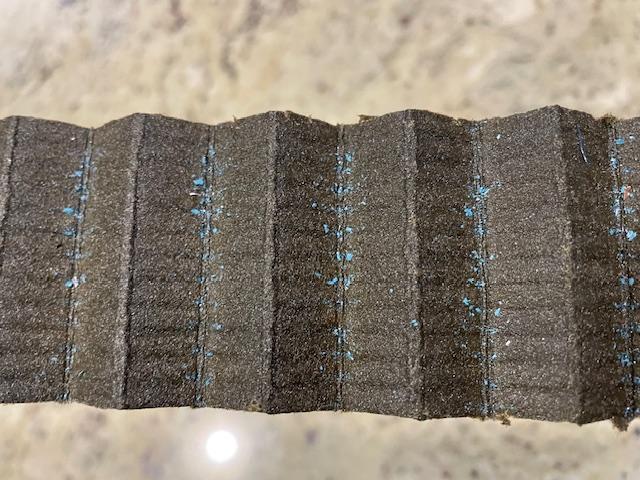

I just did the first oil change on my '24 Integra A-Spec and found this when I cut open the oil filter and examined the filter media.
11th Gen Honda Civic Debris in oil filter IMG_3480
I have never seen anything like this in any filter I have cut open in the past much less one from a new car with only 1,000 miles on it. Have any of you seen all this debris in their oil filter before and what do you think all those blue flecks are? The entire filter was full of this stuff along with a fair amount of aluminum particles but thankfully no steel bits. At least the OEM Honda filter appears to be doing a good job of filtering the oil.
The oil was also very black and smelled heavily of fuel. I have been driving this car with mixed throttle openings, rpm and engine loading but not lugging, hammering it or running it to red line throughout the 1,000 miles. Is this normal for these 1.5L turbo engines? Seeing as the oil life minder says the original oil still has 90% life remaining, if I hadn't changed it now who knows how bad the oil would have been by the time Acura would have allowed me to have them change it with their free service and then they would have left the old filter in place. With this much debris at 1,000 miles by the time the filter got changed with their free service after two oil changes it would be plugged up and the bypass valve would open so it would have offered no oil filtration at all.

Oil is black after only 1000 miles? That’s kinda crazy. Using the stock air filter? How does the air filter look?

Yes and yes. This is the first thing I've done to the car so everything is stock including the air filter. I checked and the air filter and box is spotlessly clean. I've only owned the car for a month now.

What do those blue particles feel like? They’re difficult to see in the pics. They look like plastic.
I did a Google search for “plastic particles in engine oil filter” and it brought back a lot of info. Might need to narrow the search to “…Honda engines.” Sorry, that’s all I have. I’ve never seen this sort of thing before today and I’m afraid its going to take quite a bit of research to come up with a possible explanation.

They look and feel like thin plastic shavings or possibly paint. They do not crush easily or turn to powder when pressed and rubbed between my fingers.
My biggest fear is that there are larger pieces of this stuff that are getting caught in the oil pick up strainer in the sump and could eventually clog it so the engine would get starved of oil.

Why are you changing your oil at 1000 miles and cutting apart the filter? Honda specs a certain factory fill oil that helps with break in that shouldn't be changed too early. Those are most likely pieces of silicone/RTV and the filter did its job of stopping them from going through the engine and turbo.
You have a brand new car with a warranty. Stop looking for problems.

I agree with CTR, you are probably overthinking this. There will be some minor debris that is caught by the oil filter during the first 1-3 oil changes. Less of a concern with the 1.5T since they are not known to have RTV issues, however, if you were driving a BRZ/86 with the 2.4, I would start being concerned.

I also believe these new engines do not come with any special break in oil or additives because if they did Honda would specify an oil change at 500-1000 miles to remove that contaminated oil and replace it with their regular oil. Also there is no way these engines are already broken in or don't need to be broken in. The amount of metal trapped this filter media is proof of that.
My main concern right now is finding out what that blue stuff is and if it is normal. When rubbing it between my fingers it does not break down into smaller pieces and does not feel rubbery like RTV. It resembles plastic shavings or paint more than anything else.
I am also sending in a sample of the oil now so once have the oil analysis back I will take the filter media and the analysis to my dealer to at least get it into the records on my car that this was found early in case there are issues with the engine in the future.

Just out of curiosity, how did you cut open the filter? OEM filters are blue.

I used a standard oil filter cutter with cutting discs that slice through the can and don't leave metal shavings or paint residue. I had initially thought that I had possibly contaminated the media with paint from the can but once I saw how the majority of the blue flecks were on the inside creases of the media I knew it wasn't paint from the can. I also checked the can and cutter and it was a clean slice with no paint flaking off the can or paint particles left on the cutter wheels.
