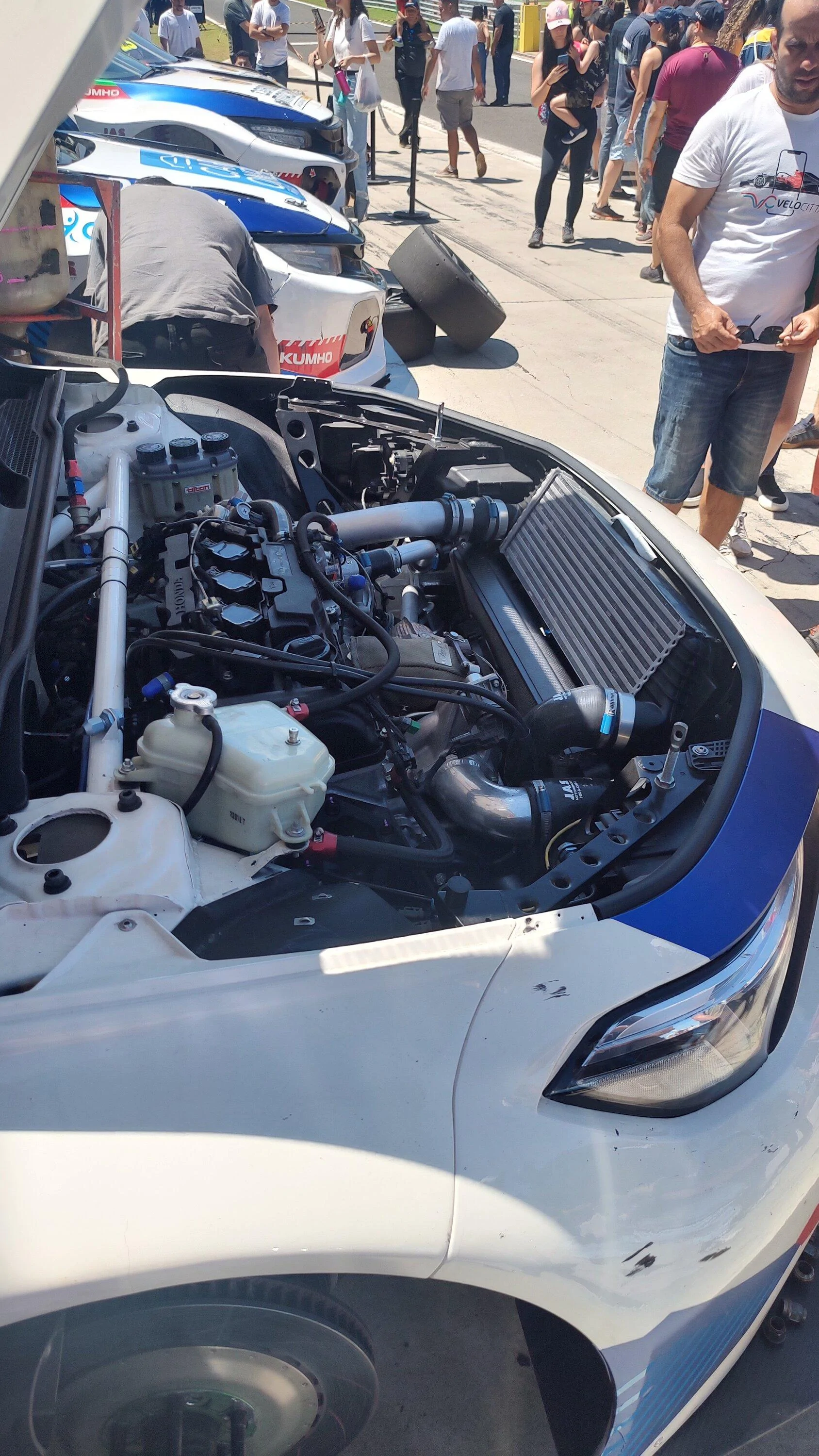

It may just be an illusion but it looks almost as though the engine has tilted back some to make way for the V mount set up on the TCR.
On Sunday I'm going to a TCR race with pit lane access. Coincidentally just today I received this picture that shows exactly what I wanted to see haha. Indeed the engine seems tilted back. I can't even see the left engine mount.
Amazing, get all the photos you can get! Bring a zoom lens hahaah
Yeh makes sense, I think TCR mandates a 60/40 weight distribution which is a little further back than what the stock car is (which is 62/38) - the tilting of the engine should help some, and then plus all the cage work would bring it to 60/40. FWIW I don't believe this to be the better way to set up a FWD - I prefer something closer to 65/35

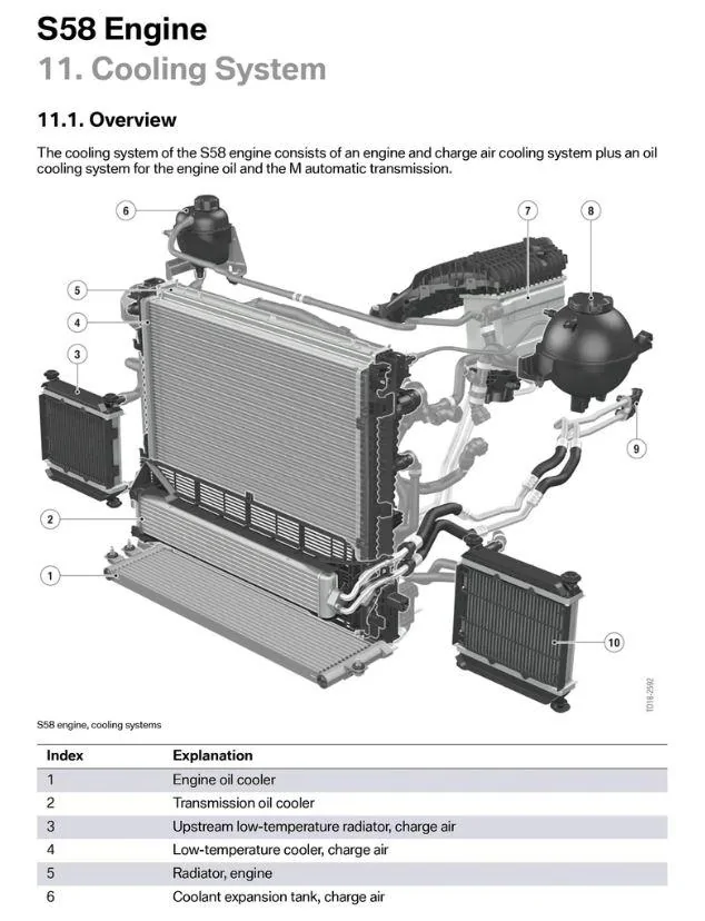

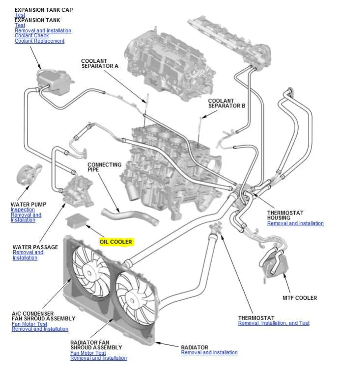

Just thought I'd share some cooling system diagrams comparing our cars and the system on the BMW M3/4 S58 engine.
FK8/FL5
11th Gen Honda Civic DE5 HPD/JAS Motorsport TCR - What cooling modifications were done (comparison to the HPD FK8)? FK8 Cooling Diagram
S58
11th Gen Honda Civic DE5 HPD/JAS Motorsport TCR - What cooling modifications were done (comparison to the HPD FK8)? S58 Cooling
Our system relys on a single front mount radiator (not including the heater core) to cool the engine and both the engine oil and the transmission fluid.
The S58 on the other hand has a seperate air/oil cooler for the engine oil, 4 seperate frontal radiators for the water, and a water/oil cooler for the transmission fluid - which equates to a total of 6 cooling elements!
Granted - the S58 is producing more power and it runs a water/air charge cooler, but the supporting cooling system is light years ahead in terms of cooling capacity.
On a more comparative level, the Golf R has 3 seperate radiators for the water system and produces about the same power as the K20C1 - only I couldn't find a cooling system diagram online.
Moral of the story - we need more radiators people.
FK8/FL5
S58
This is amazing. I looked for this same S58 doc and the explanation for each cooling circuit is just so cool to read. To be fair, since 2 of their frontal radiators are for charge air cooling, we should count our IC and say we have 2 cooling elements. Still a bit short hahaha

I have a question for you. I know the FL5 OEM radiator is larger than the FK8 radiator, but not by that much. However the coolant capacity has increased a lot! Is it because of the radiator alone?
FK8:
11th Gen Honda Civic DE5 HPD/JAS Motorsport TCR - What cooling modifications were done (comparison to the HPD FK8)? Screenshot from 2023-10-24 03-22-13
FL5:
11th Gen Honda Civic DE5 HPD/JAS Motorsport TCR - What cooling modifications were done (comparison to the HPD FK8)? Screenshot from 2023-10-24 03-22-32

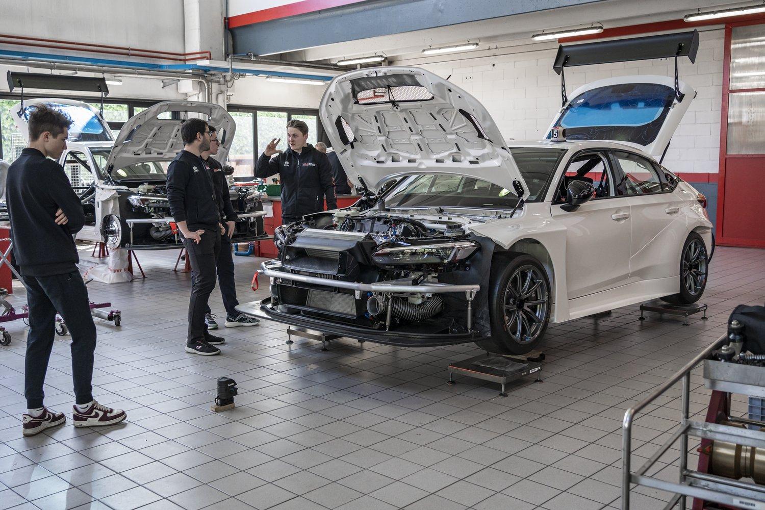

The TCR CTR uses a sequential transmission, so the factory transmission heat exchanger is not there. I could easily see the small transmission cooler on the FK8 TCR, but not on the FL5 - even though the brochure in post #1 says the FL5 should have one. Could this be the reason they changed the FL5 transmission fluid between races and not of the FK8s?
Everything was so quick because the mechanics had to work on the cars before the next race that happened like 1h later. Most of the time of the visit the cars had their hoods down. On the last 10 minutes the mechanics started working on them and then I managed to get a few short videos of the engine bay and wheel wells, trying to annoy them as little as possible before I had to go upstairs to the paddocks.
I'm probably just uploading everything to a google drive because the forum won't allow me to upload such large files =/
So, this race happened on a circuit called Velo Citta, which is a fairly technical circuit with lower top speed. Coincidentally, my last trackday was exactly at this race track. My wife was driving her Civic Si that we had just installed parts and set up for better rotation. We have been training with our race car that is a hilariously loose car. From the paddocks, it was nice seeing her rotating so easily around those corners. Our instructor also drove my fk8 and told me the Si was rotating a lot easier.
11th Gen Honda Civic DE5 HPD/JAS Motorsport TCR - What cooling modifications were done (comparison to the HPD FK8)? VID_20231022_090906043_exported_9525
Now, during the afternoon TCR race I was at the same spot at the paddocks and could see a few cars struggling to rotate at the very same corners that I happened to see my wife's Si doing so easily. One of them was the only FL5 on the grid. Later I learned that that FL5 was the slowest car on the qualifying session (+1.5s).
When the mechanics lifted the cars and removed the wheels, I quickly realized the FL5 was "missing" a rear sway bar. It has 3 adjustable positions, so it's adjusted to the driver's preference for each track. But there was no endlink there - I can only assume the driver asked it that way. No wonder he seemed to be struggling to rotate. The other 3 FK8s were all set up with some RSB setting.
What motivated me to write about this is where the RSB was located (see below). JAS put it going through inside the cabin hahaha. On the left you can see a ride height potentiometer.
11th Gen Honda Civic DE5 HPD/JAS Motorsport TCR - What cooling modifications were done (comparison to the HPD FK8)? VID_20231022_103311460_exported_2306

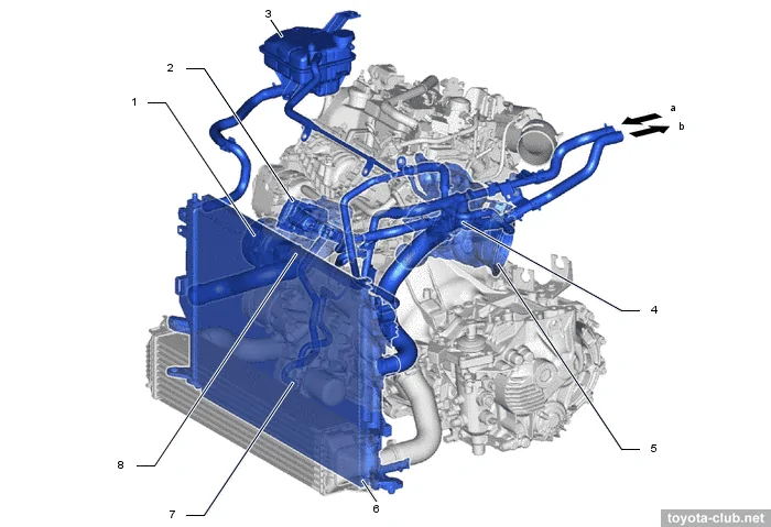

Wow, you can really see just how barebones the K20C1 is compared S58. I think the K20C1 was the first real high performance turbocharged engine Honda put out so maybe they just don't have the same experience as BMW since they have been on forced induction for awhile now. But the K20C1 has been out for 2015 so hard to not see why they didn't invest in better cooling. For how small I4s are its kind of ironic that I don't even think you could fit all of those coolers in the engine bay lol.
I was curious to actually see the cooling diagrams of other similar engines to the ours. I looked at the G16E-GTS (GR Corolla) and it seems pretty barebones too. I'm not in any GRC circles so I wonder if that has engine overheating issues too. I know it the differential can overheat and will keep the car in 60/40 FWD mode.
11th Gen Honda Civic DE5 HPD/JAS Motorsport TCR - What cooling modifications were done (comparison to the HPD FK8)? 1698156485864
1 - water inlet housing with water pump, 2 - throttle body, 3 - reserve tank, 4 - water outlet housing, 5 - turbocharger, 6 - radiator, 7 - oil cooler, 8 - thermostat. a - from heater radiator, b - to heater radiator
This is the source incase anyone wants to go digging

I just noticed they are running the factory intercooler in the V mount set up. Amazing.
Did you see the brake caliper position in this picture? They inverted it from the FK8 TCR!
I assumed it was the OEM intercooler when I saw the plastic end tanks, but was not sure. The intake is also interesting - it doesn't have that aluminum inlet pipe over the turbo. It's a hose that travels right behind the crash bar and collects air (without a visible filter!) from the right side of the grill with a plastic deflector:

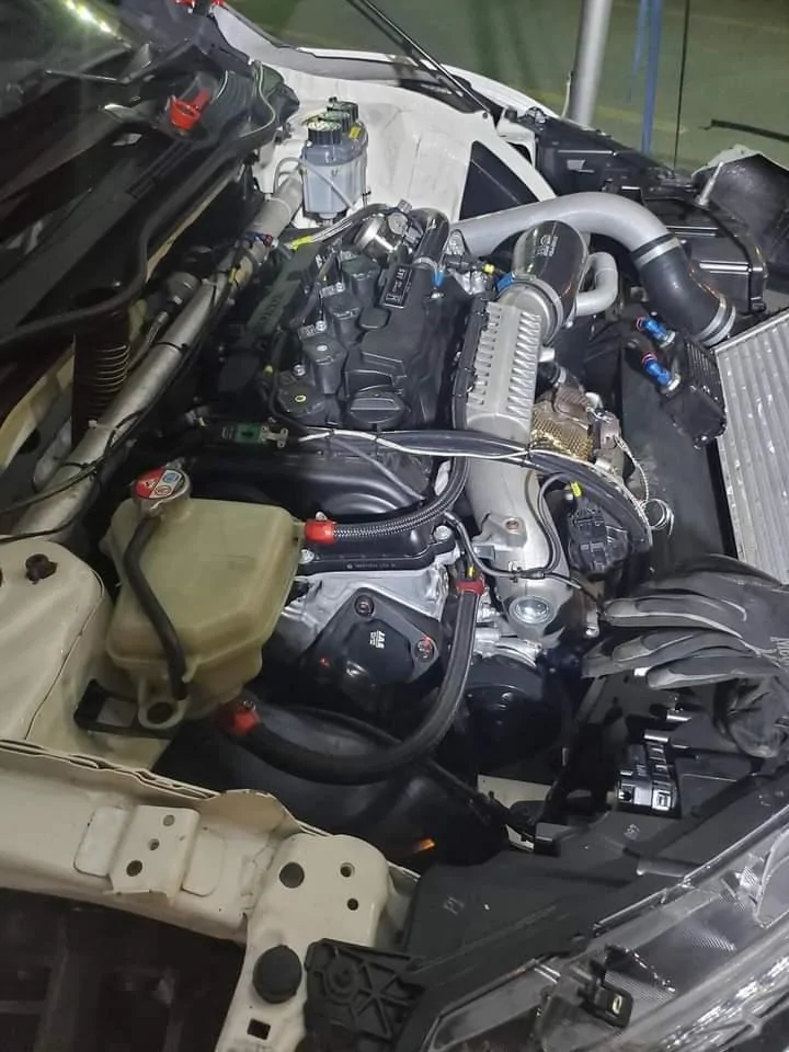

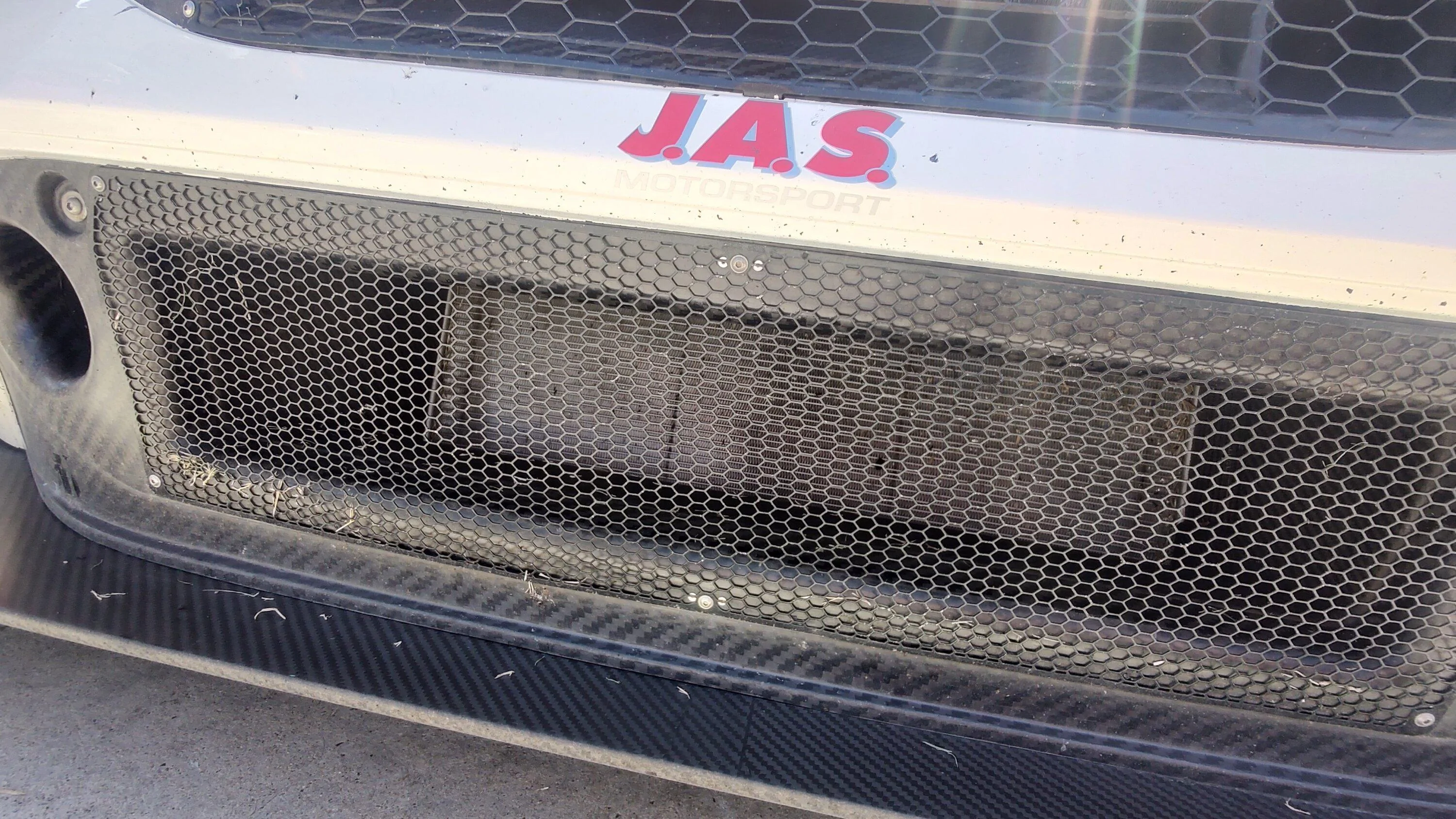

Back to the topic, here's a pic of an FL5 TCR car:
11th Gen Honda Civic DE5 HPD/JAS Motorsport TCR - What cooling modifications were done (comparison to the HPD FK8)? fuus7hkwwaq-jaa-1-
Lol look at the brake calipers on this picture at JAS. The caliper was always mounted behind the axle! I only noticed it at the track.
The radiator is actually small, just slightly tilted back. I'd say smaller than OEM, and it's crossflow! It has one small fan and no shroud.
11th Gen Honda Civic DE5 HPD/JAS Motorsport TCR - What cooling modifications were done (comparison to the HPD FK8)? IMG_20231022_102115468_HDR
