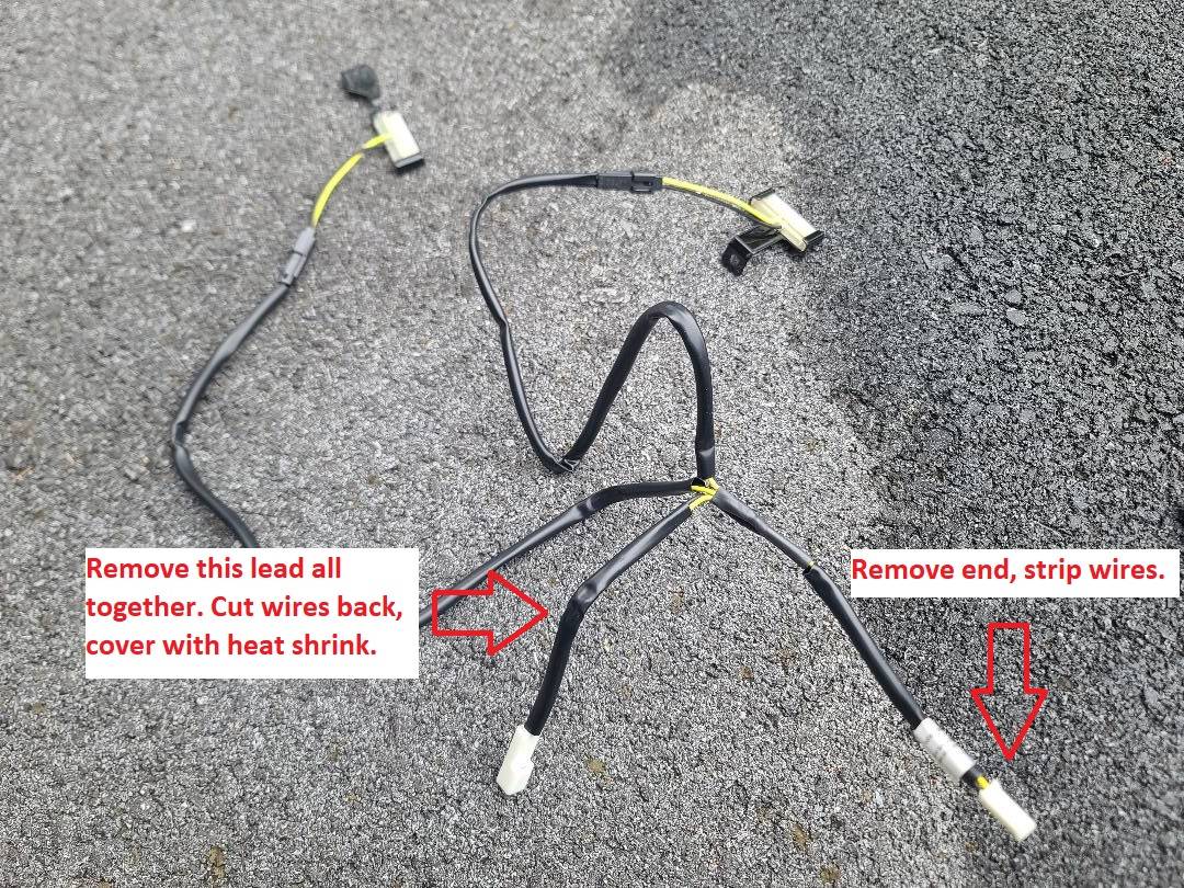

Step one, prepping the wiring harness. The Subaru light kit comes with two LED lights, and a harness. The black leads will be kept, but the white ends will need to be removed. This is how the wiring harness is without modification.
11th Gen Honda Civic Dash illumination kit (subaru) install on 2022 Civic. DIY wiring befor

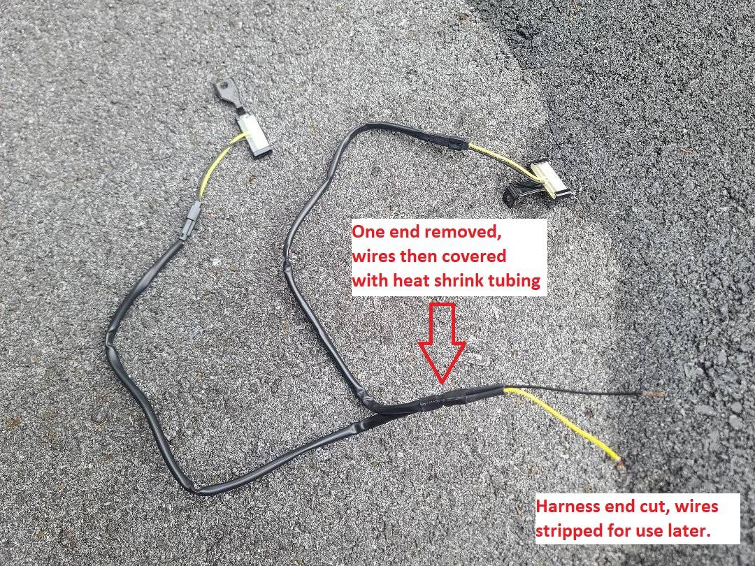

Once the harness is modified as outlined in the picture above it should look like this.
11th Gen Honda Civic Dash illumination kit (subaru) install on 2022 Civic. DIY wiring after

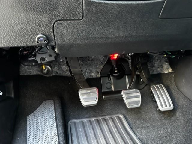

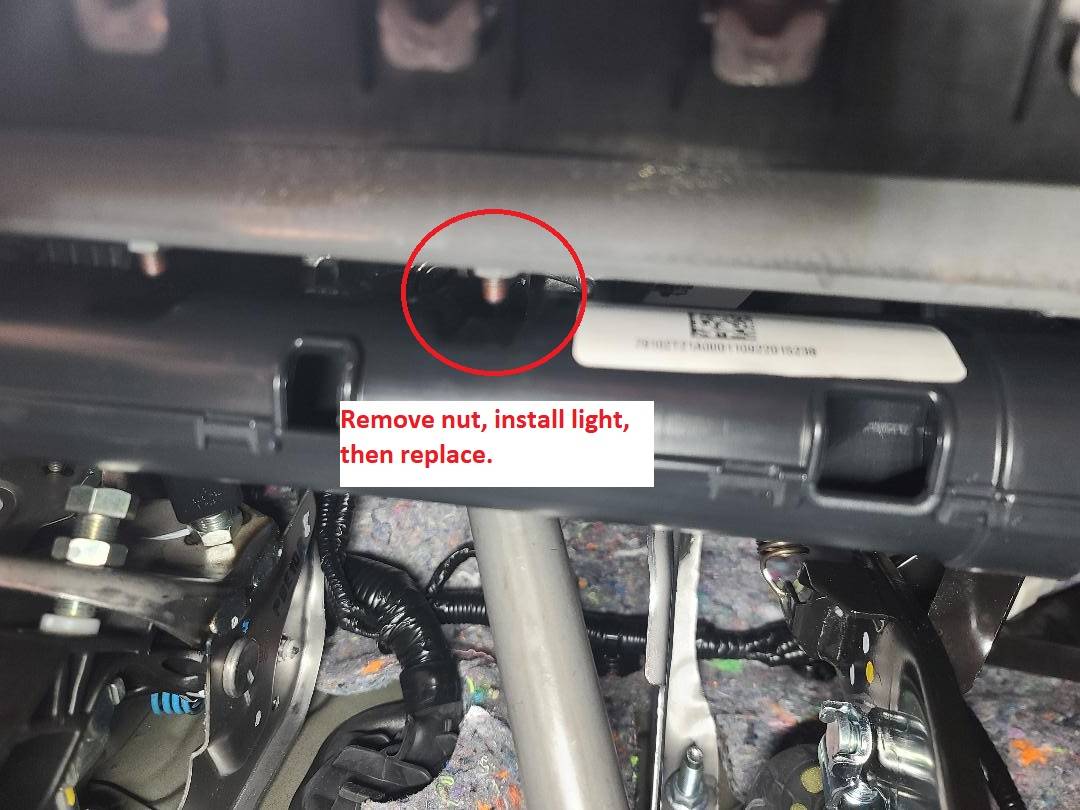

Drivers Side mounting:
Look under the dash, you will see a single stud with a 10mm nut on it. Remove this nut, install the light, and replace the nut.
11th Gen Honda Civic Dash illumination kit (subaru) install on 2022 Civic. DIY ds mounting loc
Once tightened you can now bend the light bracket to look like this.
11th Gen Honda Civic Dash illumination kit (subaru) install on 2022 Civic. DIY dirvers side mountin

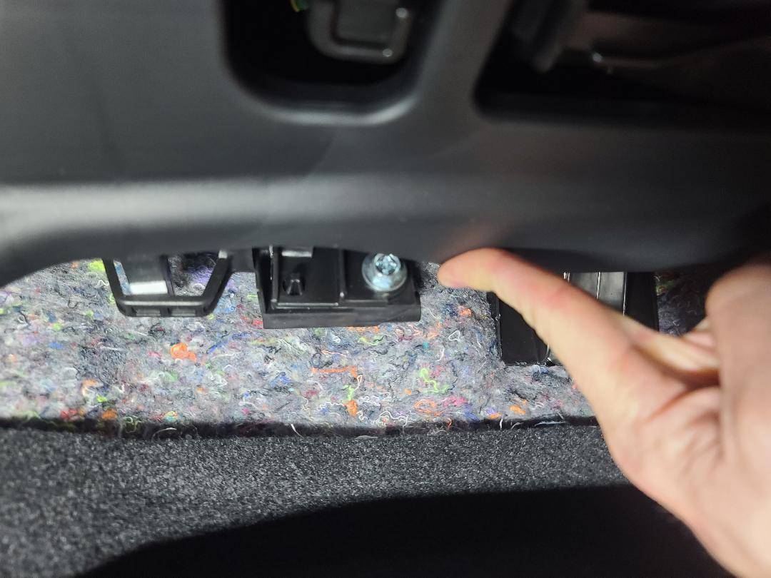

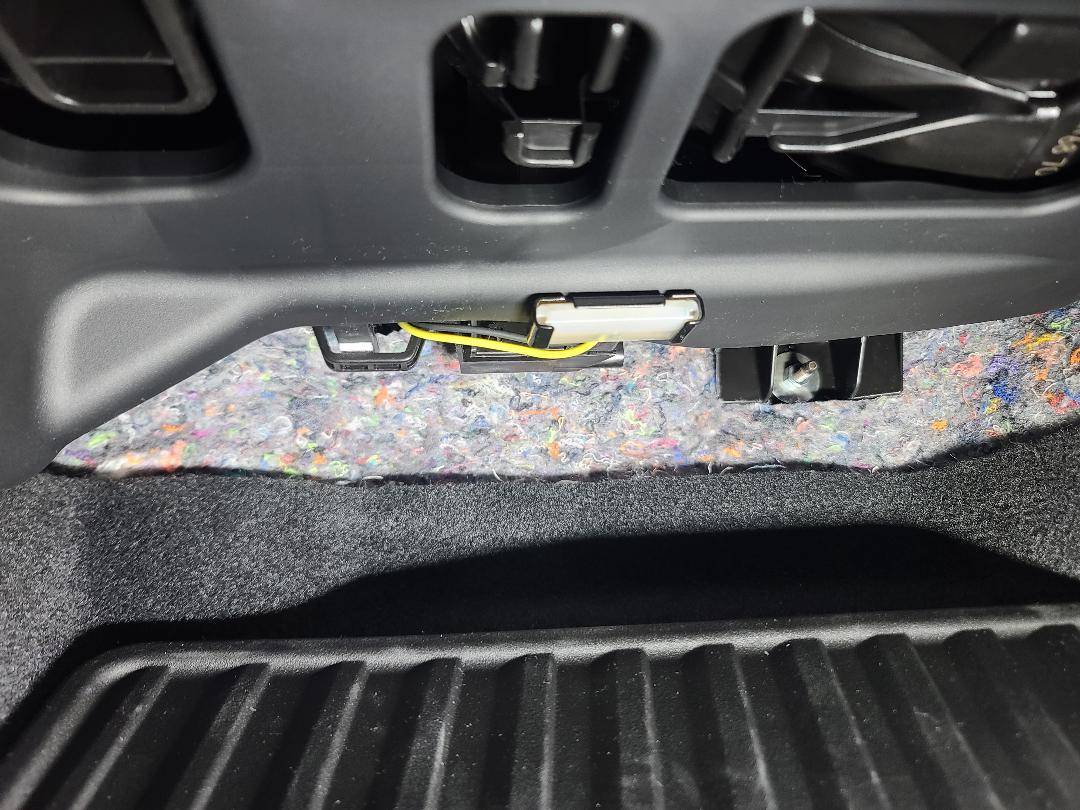

Passengers Side mounting:
Under the pass side dash locate this single 10mm bolt, and remove.
11th Gen Honda Civic Dash illumination kit (subaru) install on 2022 Civic. DIY pass side mountin
Install the light, and replace the bolt. Note; this goes into plastic so do not over tighten. I used a screwdriver to put the bolt back in and a wrench to remove. Once installed it will look like this.

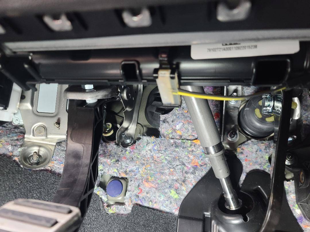

Start with the harness under the drivers side dash, and feed the longest lead behind the center console and plug it into the pass side light. (Passengers side is now finished)

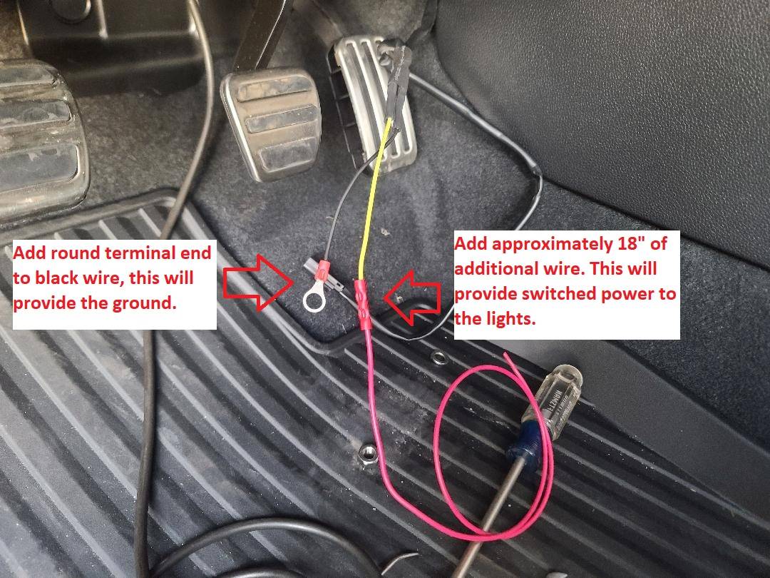

Now you can add your round terminal end to your grounding wire (black colored wire). You are also going to want to add approximately 18" of additional wire to the yellow wire, which will provide power to the lights from the fuse box.

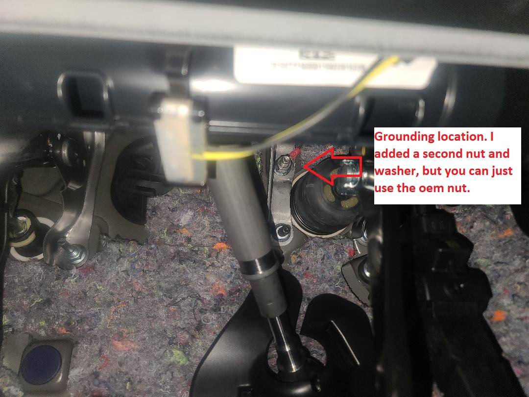

I found a strong ground on this firewall stud. I added a second nut I had in my garage to make things easier, but you can just removed the OEM nut, add the terminal and replace. The black wire will be long enough and does not need to be lengthened.
11th Gen Honda Civic Dash illumination kit (subaru) install on 2022 Civic. DIY ground location

Now you can run the harness to your drivers side light and plug it in. I used zip ties to attach the Subaru harness to an OEM harness which runs nicely along the firewall.

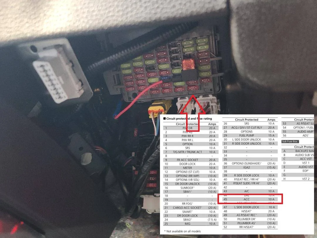

Last is connecting your power. I decided to have the lights on whenever the vehicle is on. With the use of a mini fuse tap, remove the outlined fuse, and replace with an additional 10 amp fuse. Connect the fuse tap to the yellow power wire and you are finished.
11th Gen Honda Civic Dash illumination kit (subaru) install on 2022 Civic. DIY fuse box

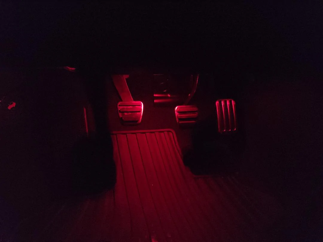

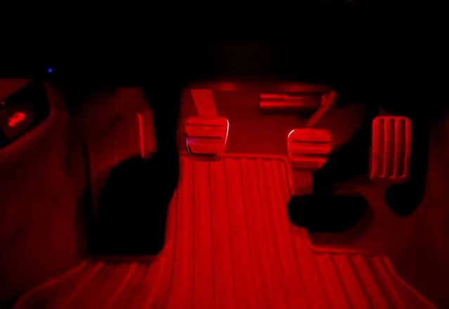

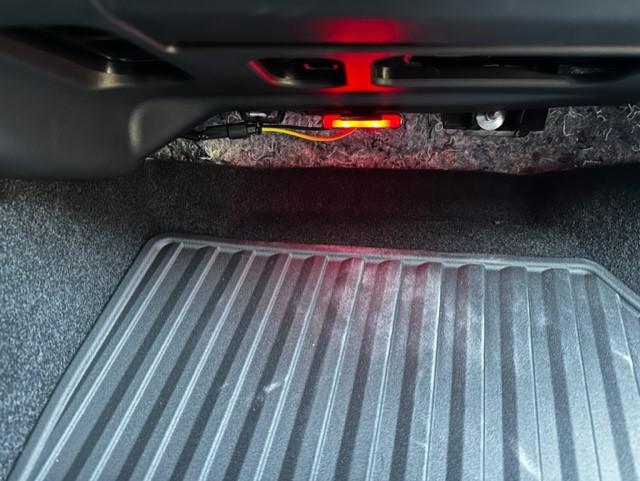

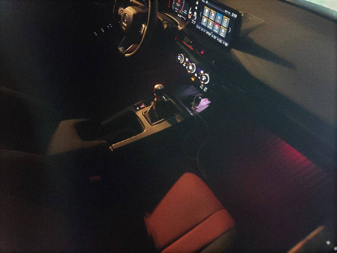

Enjoy your new under-ash illumination kit!
11th Gen Honda Civic Dash illumination kit (subaru) install on 2022 Civic. DIY ds lights on
