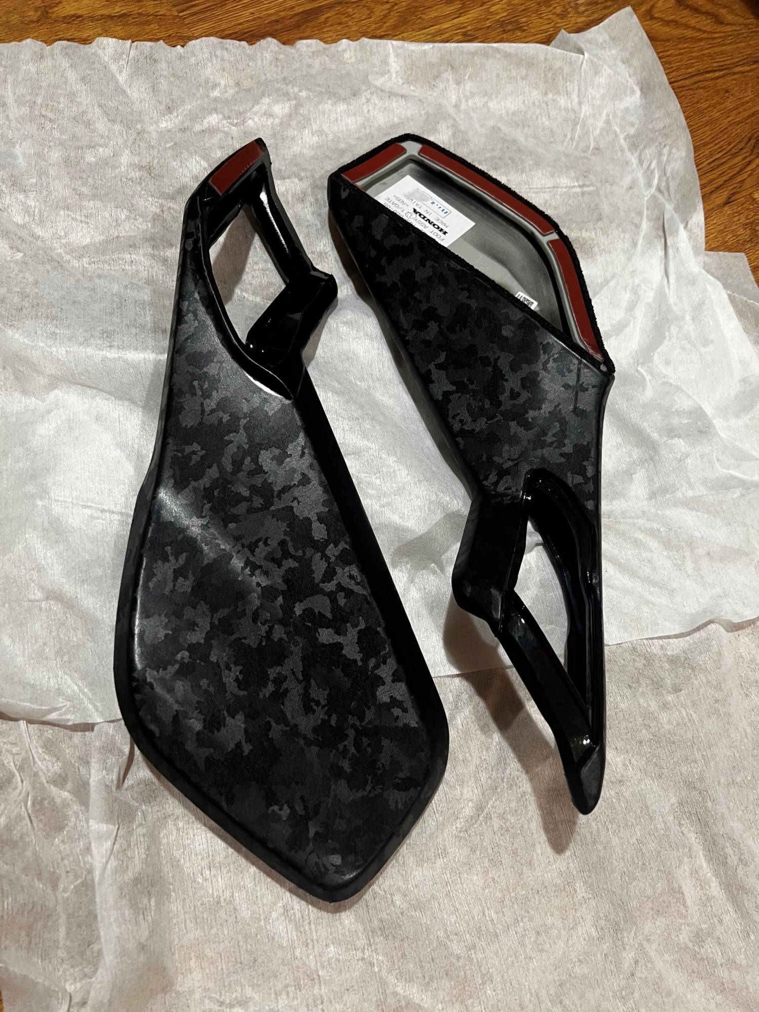

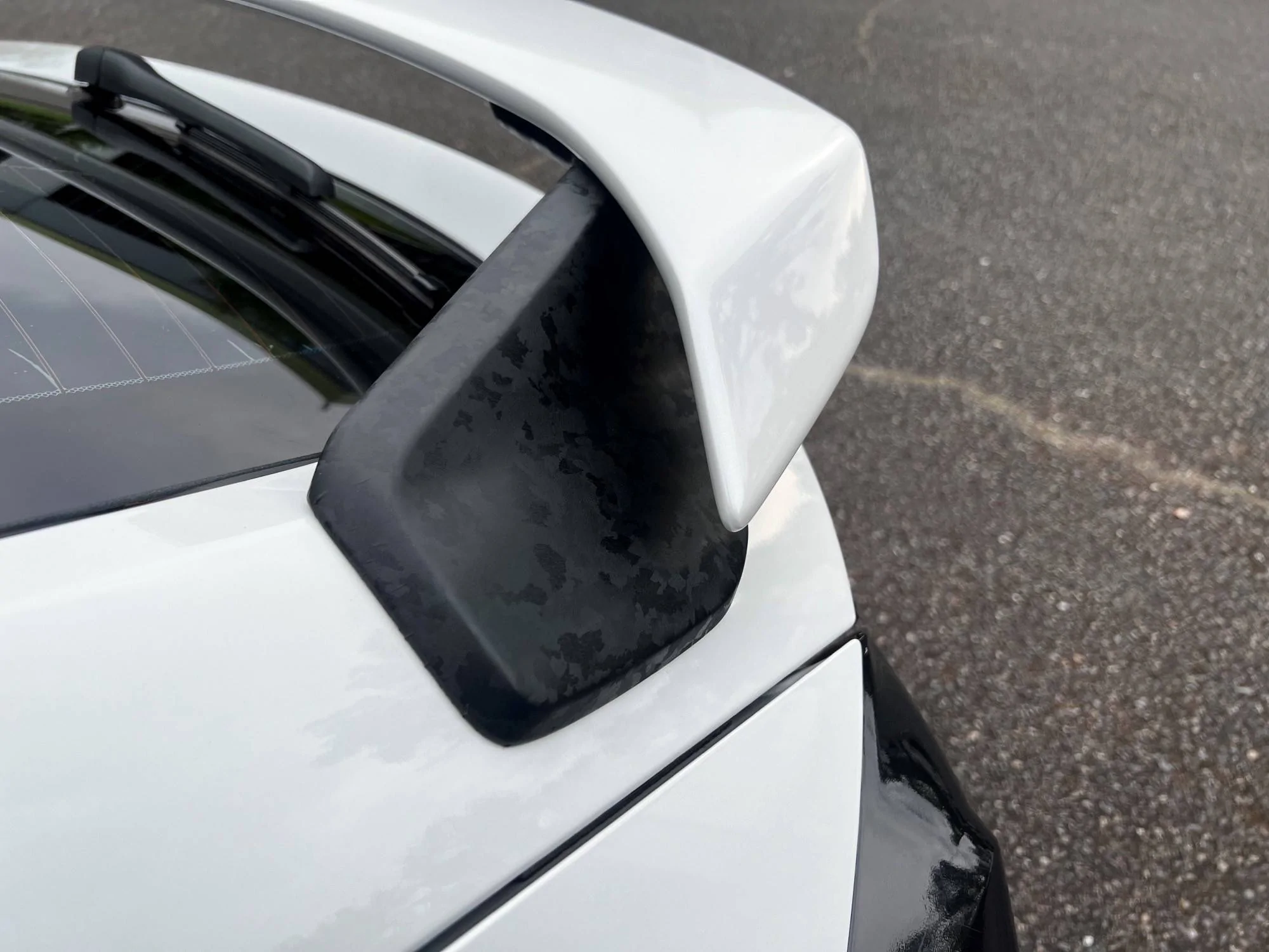

So, finished installing mine last night. You may have fitment issues with the metal struts that make up the structure of the spoiler arms. They have circular domes on them where the screws pass through to secure them down, and adhesive to seal it in place once it is positioned. So there's a slight chance they don't seat down all the way but that's about it. Figured I'd follow up since I now have actually done the installation.

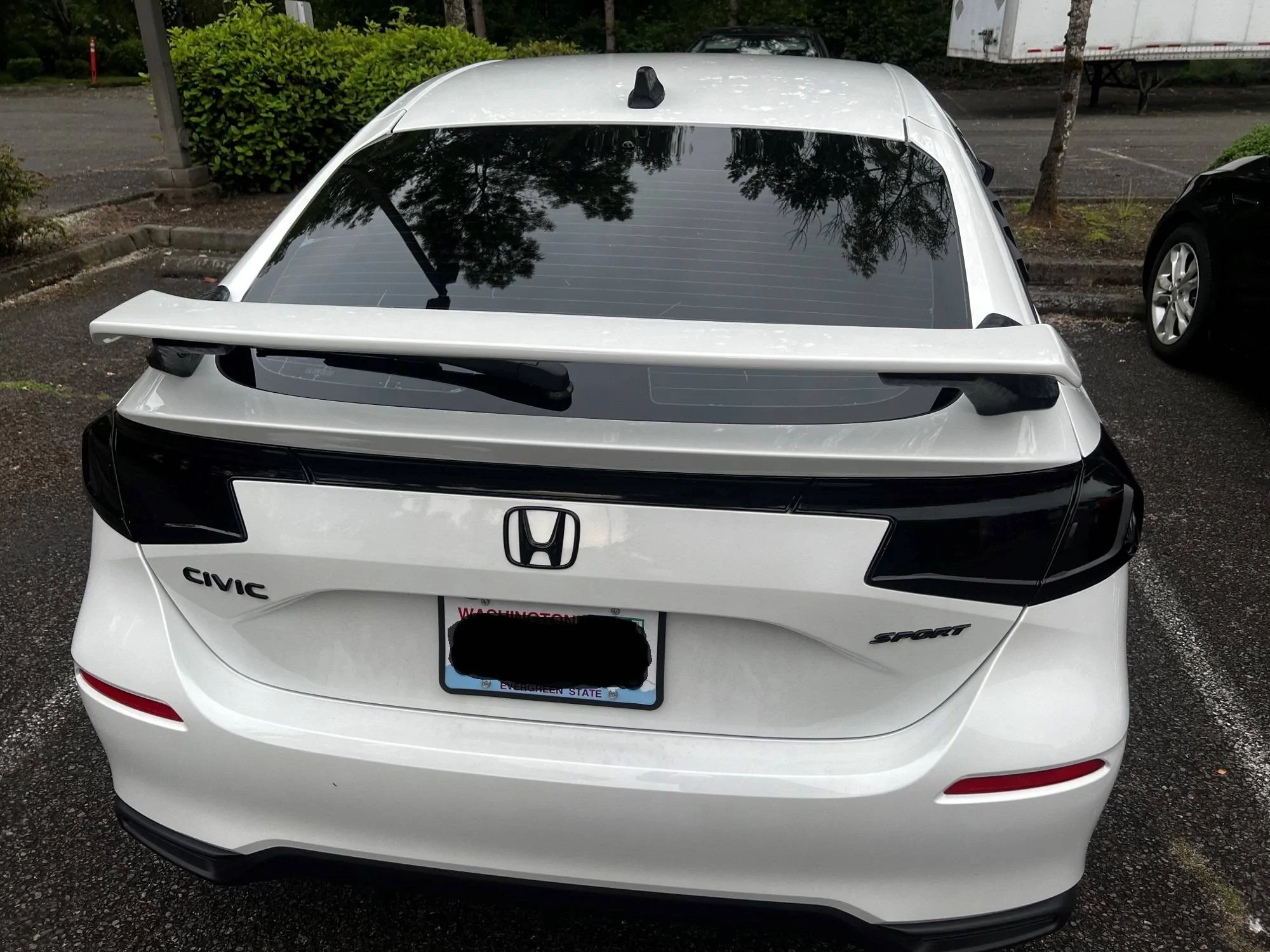

Spoiler Installed. Wish I had better pics but here's what I do have. I did vinyl wrap the arms (HPD Stickers are very stretchy but came off pretty easily).

Thank You for that .Looks Great ! I went ahead and ordered the right size hole saw.
