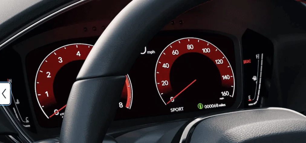

Very curious about this too. It looks like the part is just under $500 USD new. I'm pretty new to the cluster swap, but it seems most past issues were around systems not present (parking assist for example) triggering errors. I'm wondering if the US '25 Si has any new systems or system updates that would be an issue. Also curious if all warnings would still work. Not sure how you would test some of that, but maybe someone with more knowledge will chime in.2025 Si Cluster is available to order!
Who is gonna be the first?

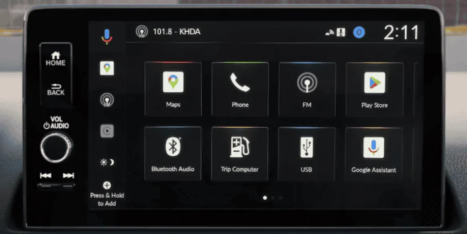

Fuel and temp back on the sides like the good ol days. I wanna know how the google integrated center screen works and what it needs to swap as well. I'm wondering if it's just a module swap or software install since it's the same screen.

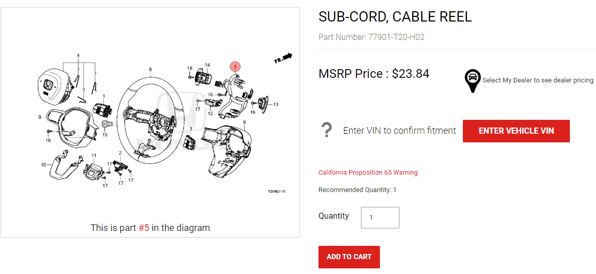

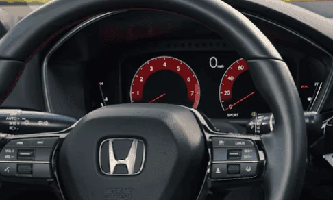

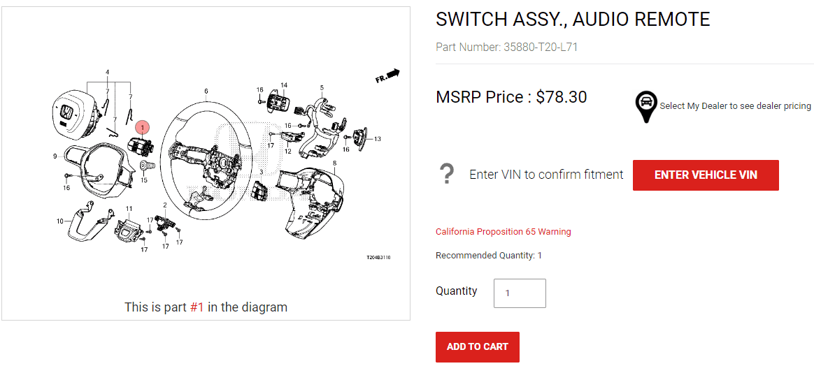

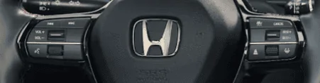

You will not only need the correct buttons but the harness as well that is inside the steering wheel. I already tested this on the FL5 vs '24 Civic Si. Other switches that may work is the sport trim level as they got the digital cluster. My FL5 cluster is still working perfect. Got 54.7 MPG today, (Average speed 54 mph). Who is ever in a rush to get to work right?![]()
That is what I used 77901-T20-H020 - Mine had an extra zero on the end.Part number for the sub-cord to the cable reel is 77901-T20-H02 . Is that the one you used?
Looks like around $600 for all 3 depending on where you shop online.
I ended up doing both. I forgot if I had to do both or just right side, however, I just took my wheel, transferred the wiring harness + switches. I have a scratch on my switch on the left side, so I want to get rid of it soon so it looks minty.Would you have to do both switches on the wheel or just the left one? @Xcelent maybe you can chime in
