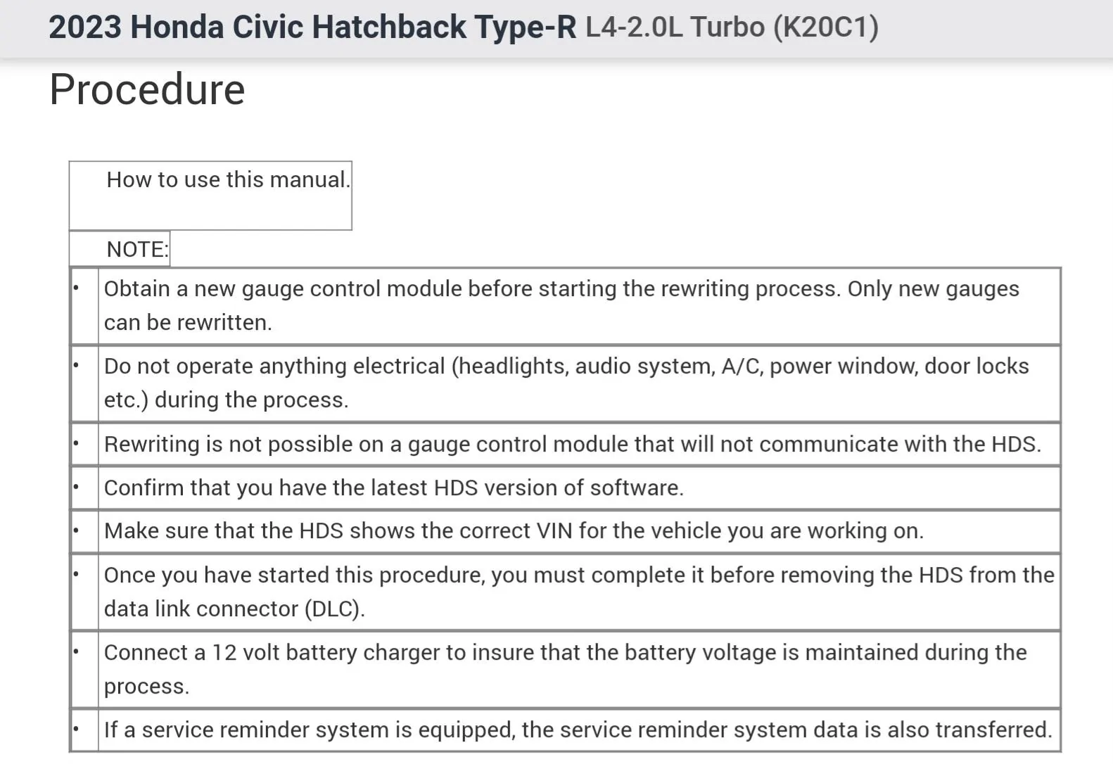

Mileage is stored on cluster. Page from Honda's procedure for installing new gauge clusters and rewriting odo mileage:
11th Gen Honda Civic Cluster swap Screenshot_20240130_104223_Chrom
That is very beneficial thanks for noting this! I was just going to test it, but now I do not have to!
