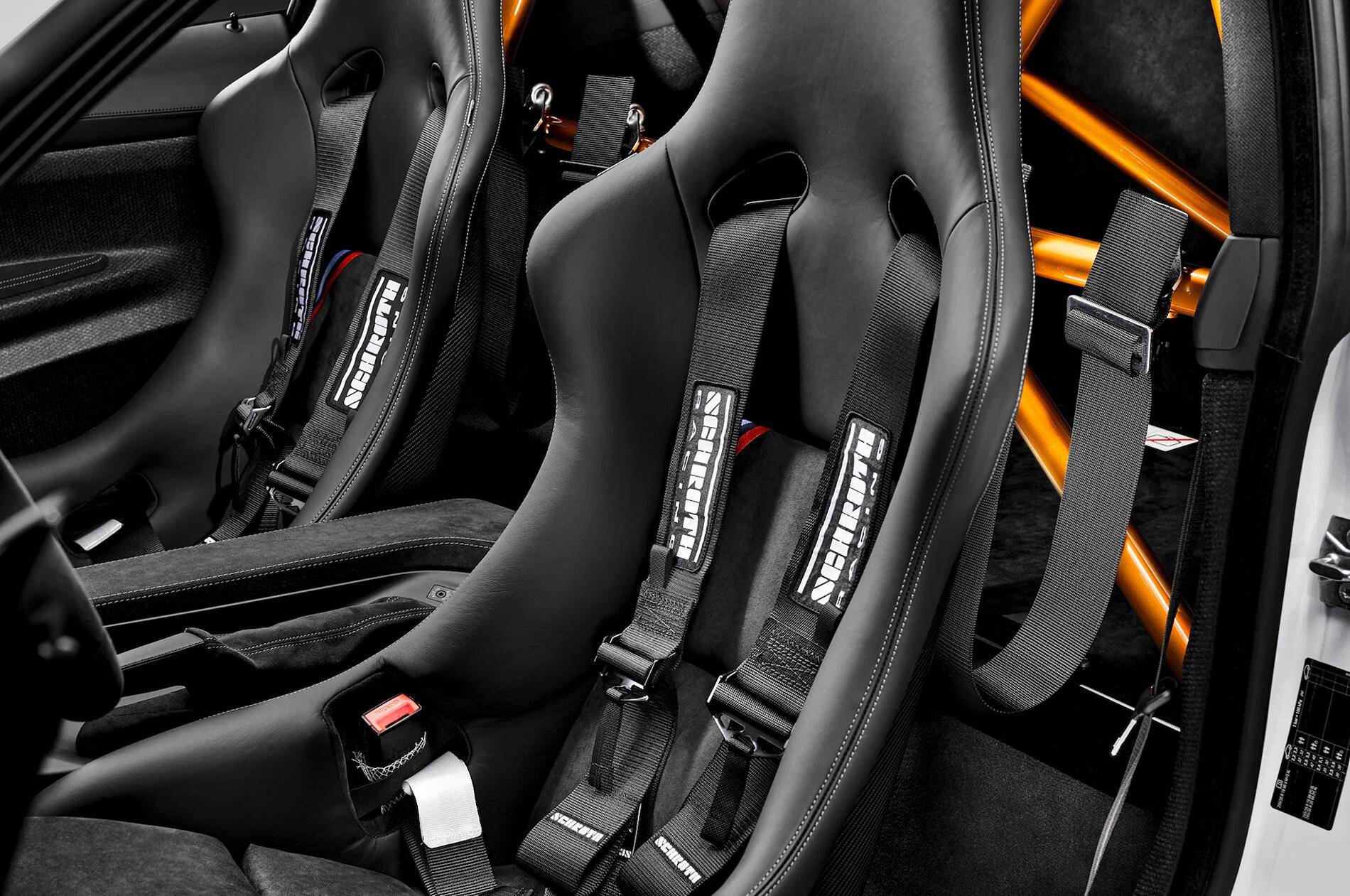

On the type R I would not do a reclining bucket, I would go fixed back all the way. On a coupe I understand why peple do fixed back so they can still access the back seat but if you gonna go bucket fixed back is the move, get all the goodness from having the bucket.
As far as sizing goes, bucket seats seem to be made in mind for people that shop at baby gap lol, they are all so damn small. Your waist is not really that big and even at 34 you could still probably fit in a nice recaro pole position, recaro also makes a bigger version of the pole position. All the mugen stuff looks super small to me though, maybe a leg of mine would fit, maybe. Also why too expensive, just get a pole position which is excellent and made by recaro just like the mugen stuff, it will just not have the ugly cartoon on it (why do people like that ugly mugen ball logo cartoon?)
Now the thing people don't talk about buckets enough. Just like putting a wheel with no airbag in the car a bucket seat is not really safe with a 3 point belt, you need to have the seat belt receive close to you body so that it can tighten properly, a lot of these buckets the hole for the belt is for a harness so the belt receive can't properly fit, some it fits but it will jam against your leg. You could use a seat belt extender which maybe fine. Its a shame that recaro does not make a seat like they did for the BMW GTS, or a seat like the porche gt cars that has a place where the 3 point belt receiver can be in the correct place
