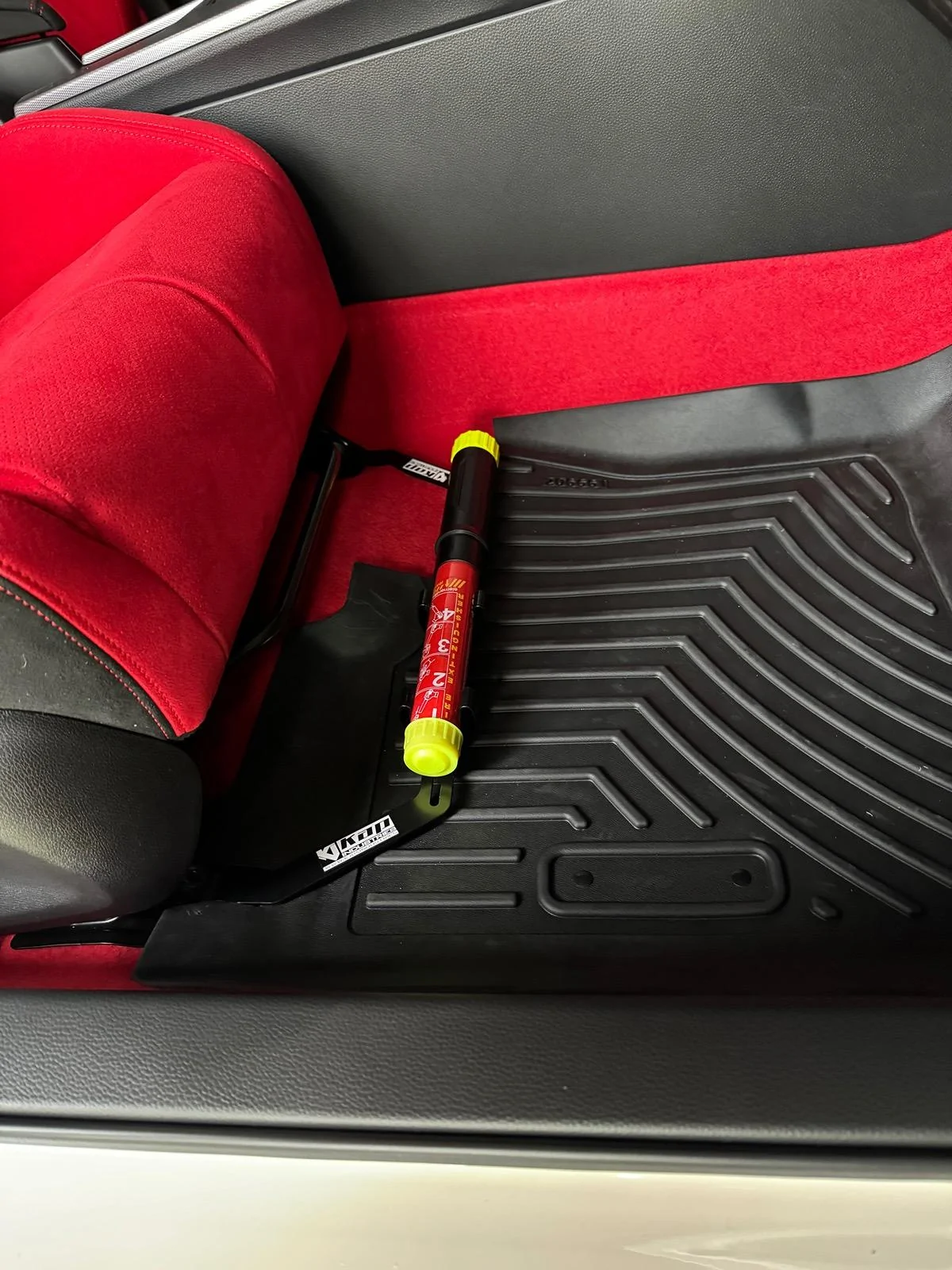

11th Gen Honda Civic Seat rail bolt size and torque IMG_7423
Bolts look to be M10x1.25 fine thread (ordered some and will test. They are aprox 30mm in length so ordered 35mm and 40mm. Looking at how much thread goes in, new bolts are definitely a must.
I need to cut the mat a little better, just countour around the floor moulding a bit better, this is with seat almost all the way back though and with that tiny estinguisher which I will replace with a proper on seeing how apparently these elements are crap
