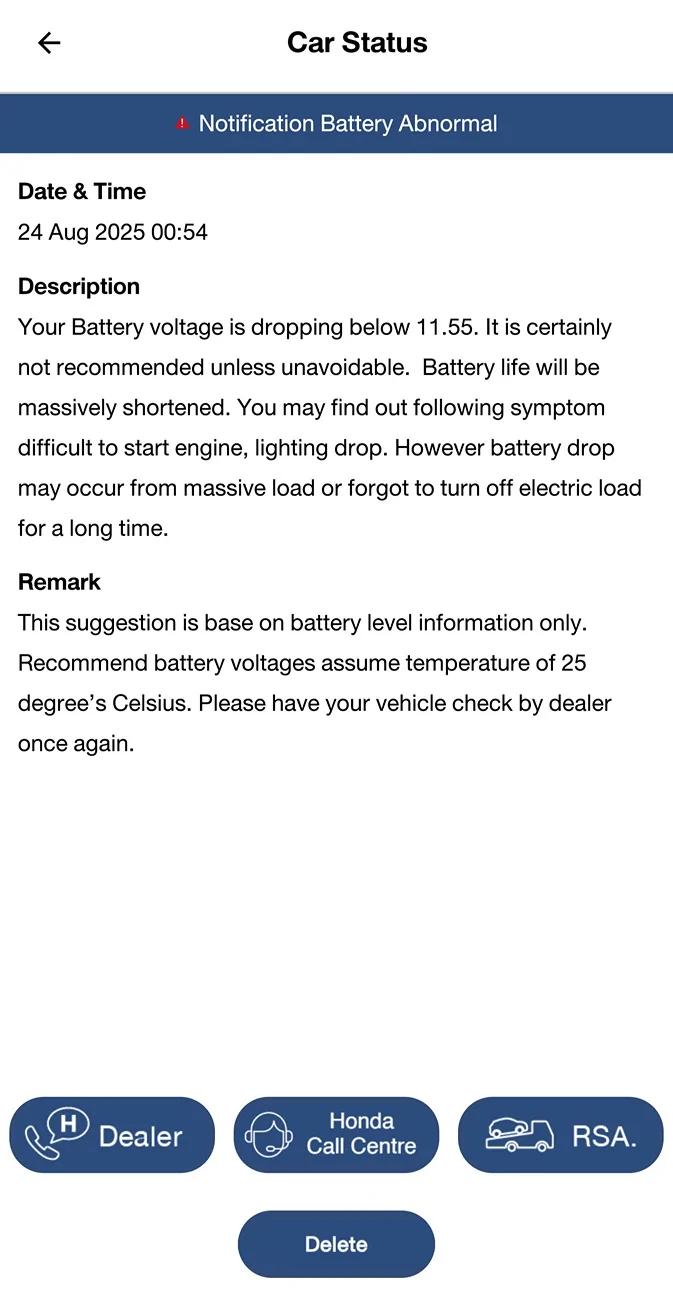

Hi all,
I randomly received a notification in my Honda app stating that my battery voltage dropped to 11.55, I'm not sure what caused this but it's the 2nd time it's done it since I brought then car 6 months ago.
The car has 8xxxkm on it and the only mods I've done are coilovers/wheels and some suspension geometry stuff, I have replaced the engine bay bolts with titanium hardware though the battery bolts still remain OEM.
Anyone had an similar issue or know why this could be happening? I'm going to take the car to the dealership on my next book off day but yeh just curious to why it's happening, I've never had any issues starting the car or lights dimming and whatnot.
