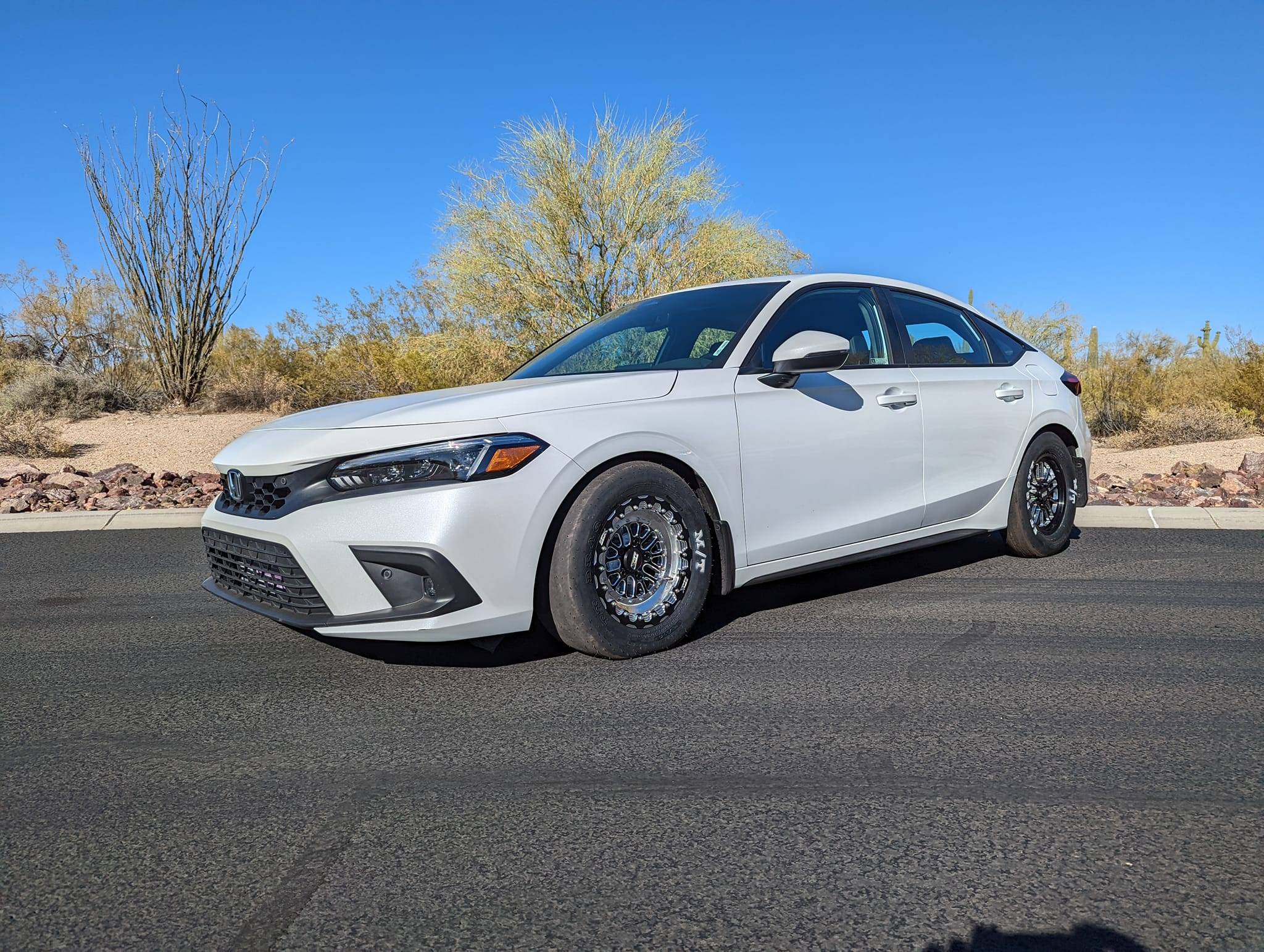

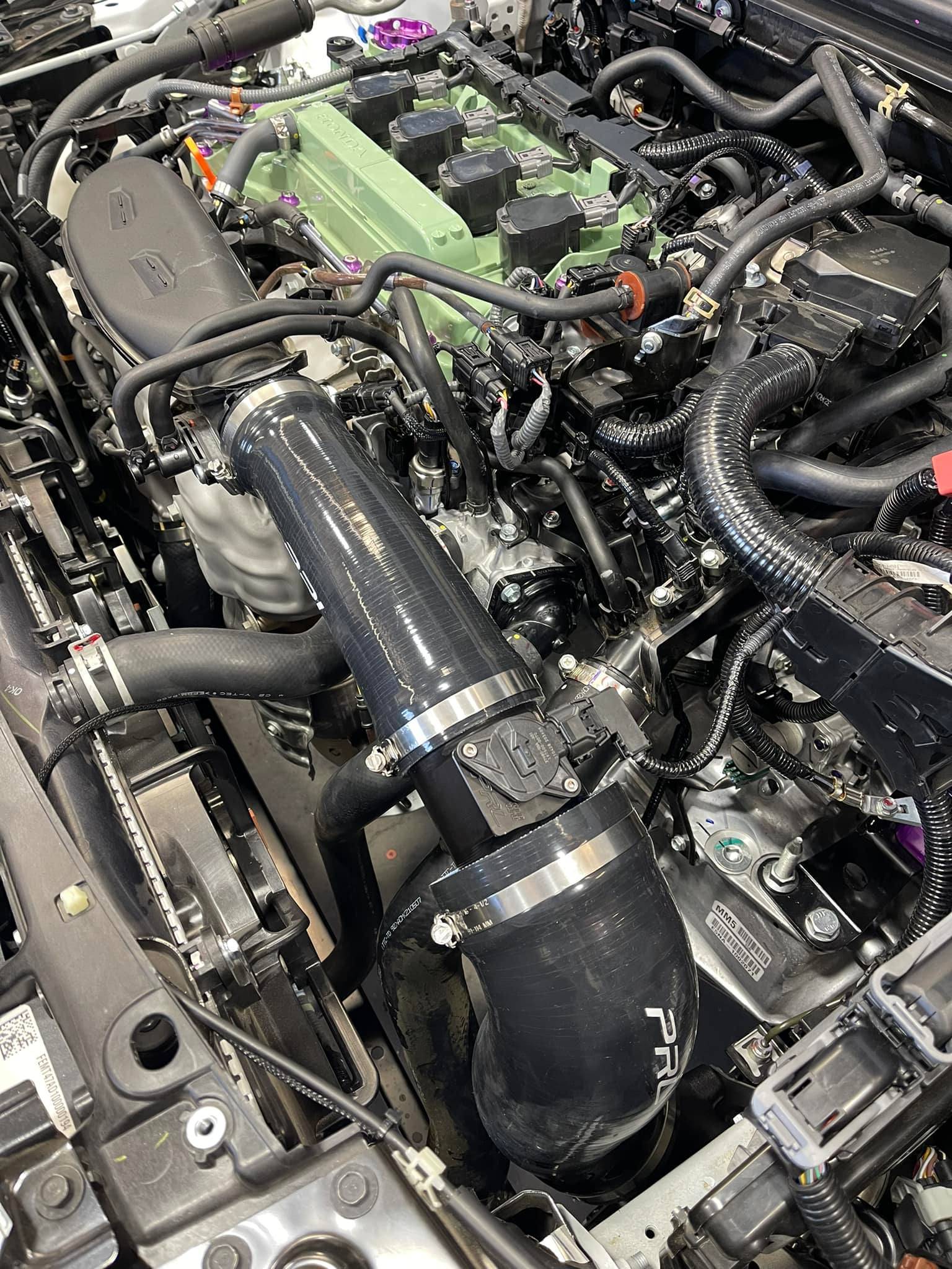

So we ended up stay with the stock turbo for now and will wait for the built engine for the big turbo
We did the Si cam and DI pump along with 10th gen Cobra intake which needed modified to work and tuned. We also installed the PRL flex fuel kit. Now to tune the car and get it to the track to try and run 11's

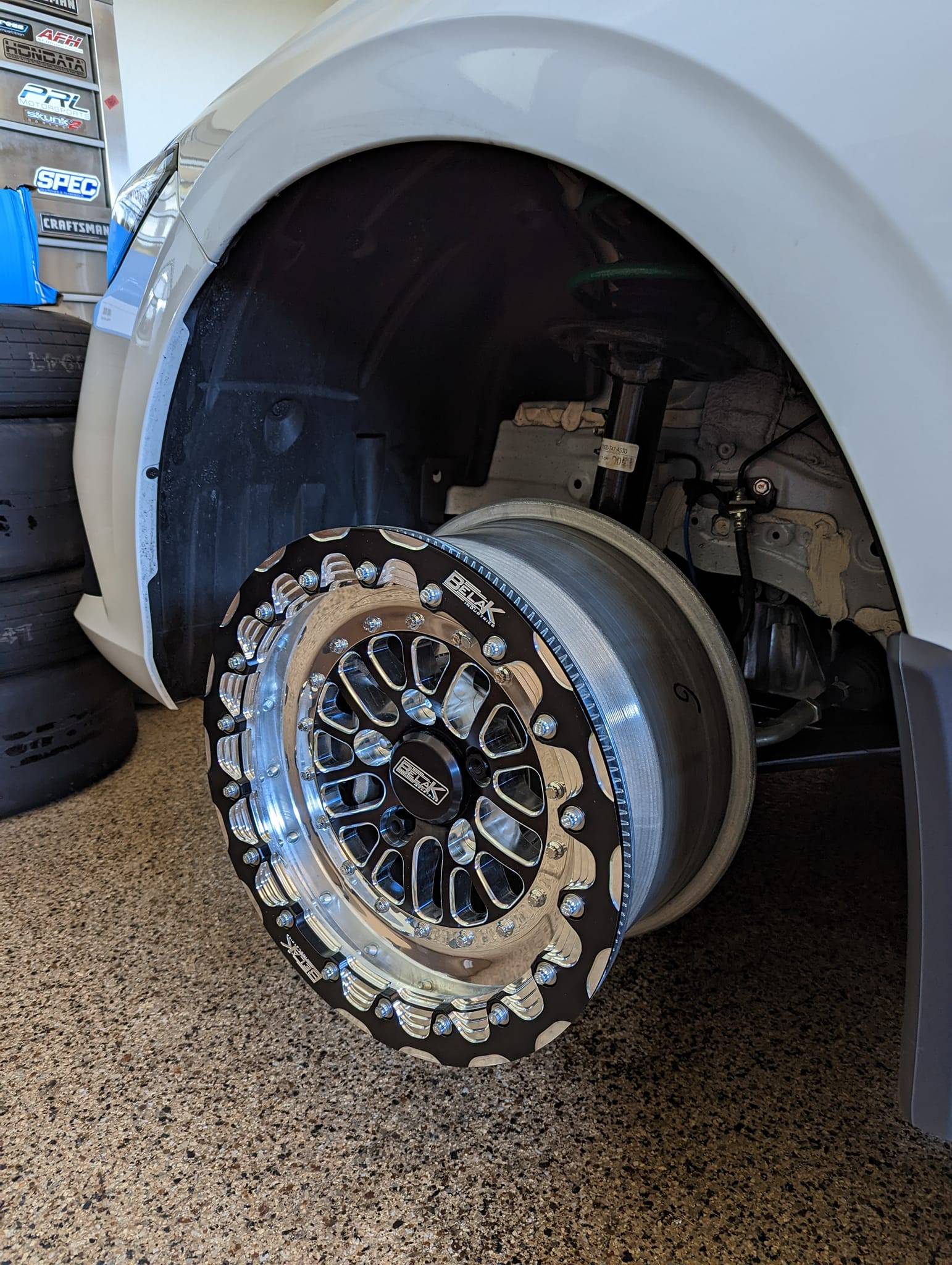

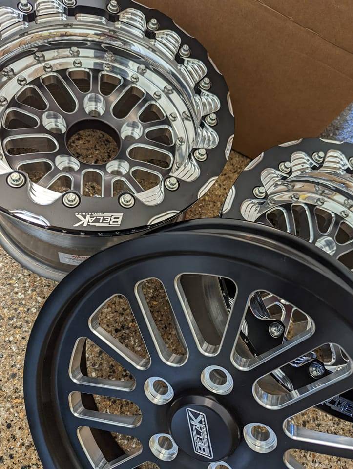

Our Belak wheels are here, just need to mount up tires and install
15x8.5 front and 15x4 rears

11th Gen Honda Civic Axion Industries 2022 Civic Hatch Sport Touring Street/Drag build 285710338_5958046777542255_5130262226796397924_n
15x8.5 fit perfect with no modifications

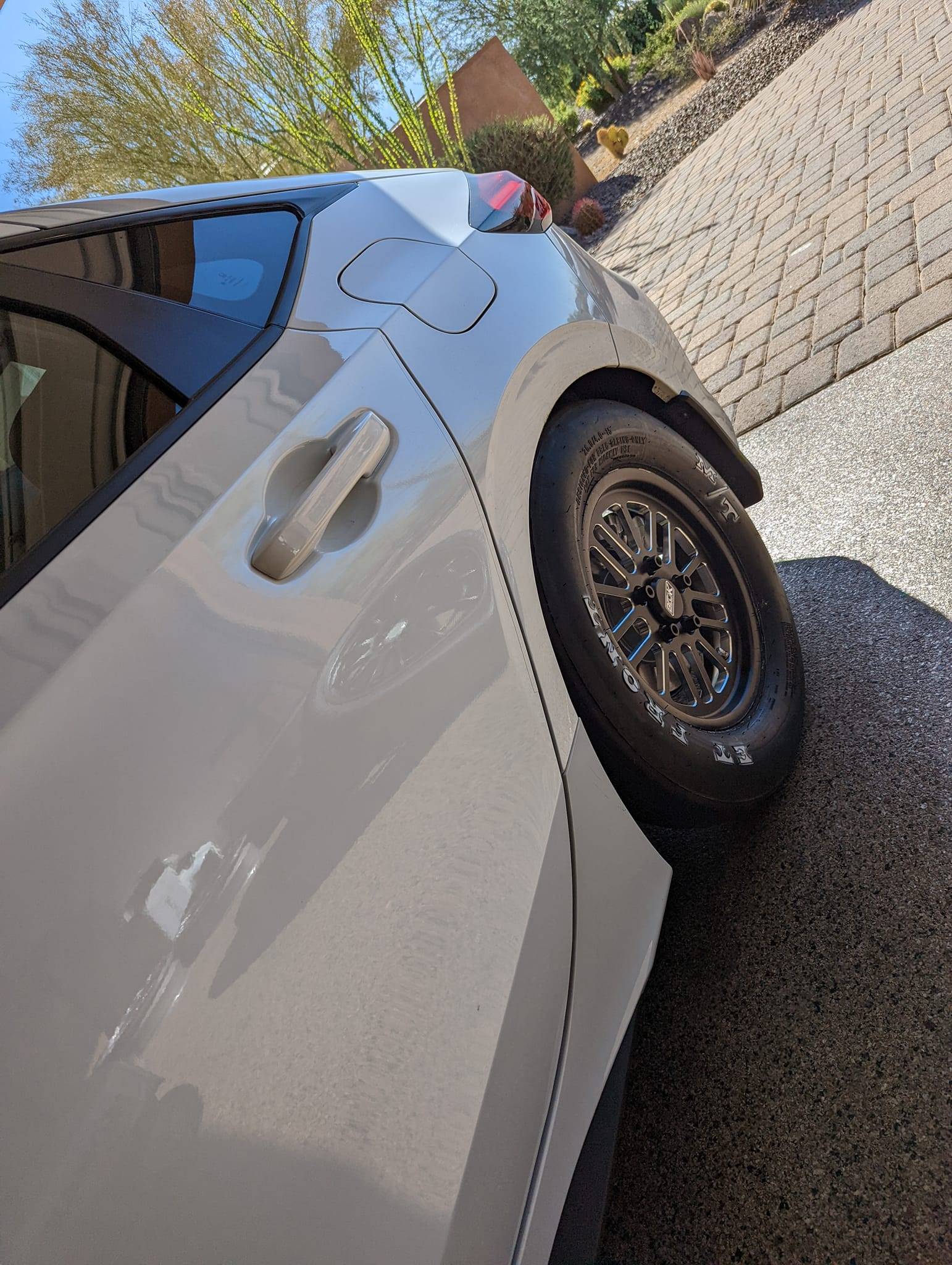

11th Gen Honda Civic Axion Industries 2022 Civic Hatch Sport Touring Street/Drag build 286721065_5974968809183385_2060591155719636846_n
Rears installed 15x4 got rid of tons of weight
