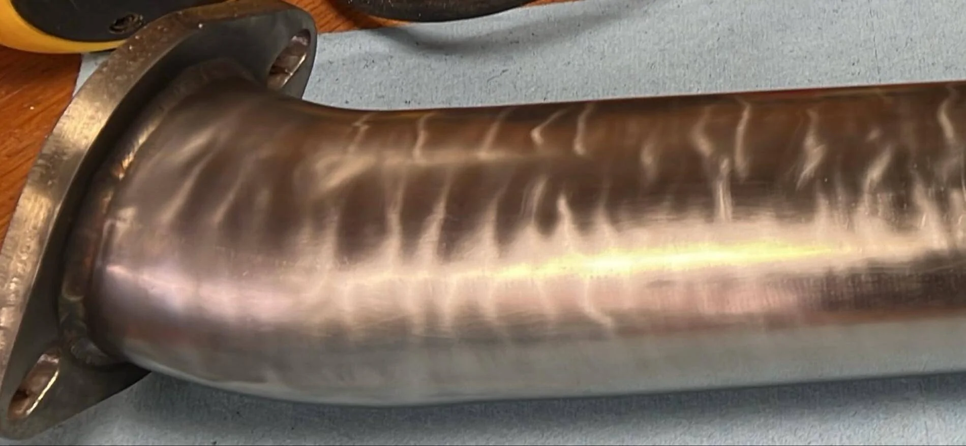

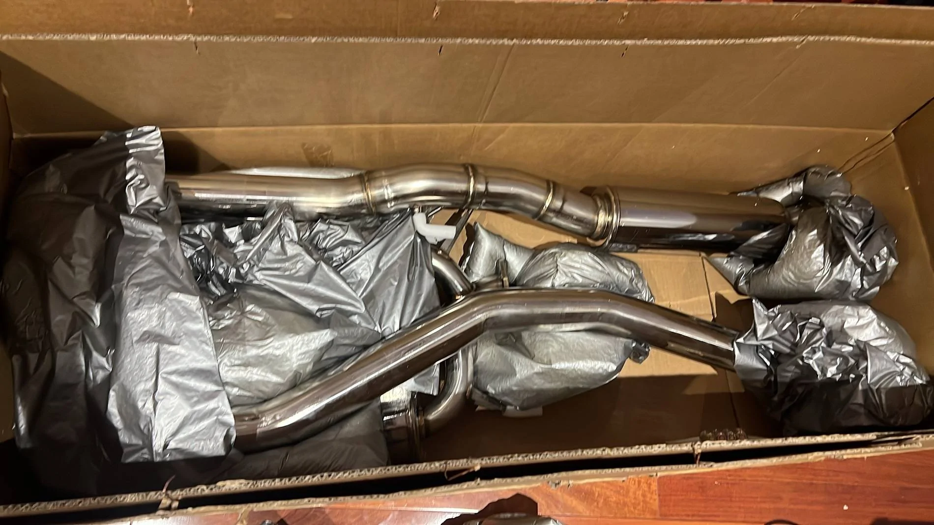

I got the MXP Comp RS awhile back (I didn’t find Mackin Industries offering any other of their exhaust lines for the FL5), for about $1,150 with free shipping. I weighed the pieces individually for a total of 40.88 lbs.

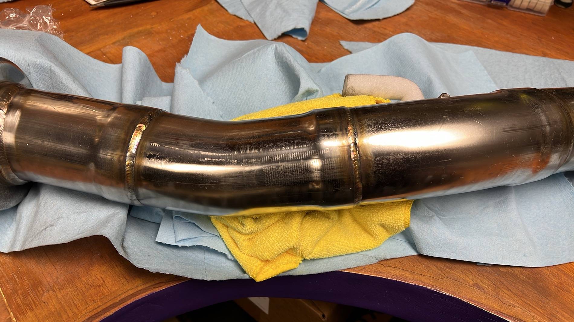

It arrived with some pretty rough machining marks and scratches, possibly some that happened in shipping as the parts were only separated by a few pieces of bagged foam, with just the mufflers and tips wrapped in plastic and the hardware/gaskets taped to the sides of the box.

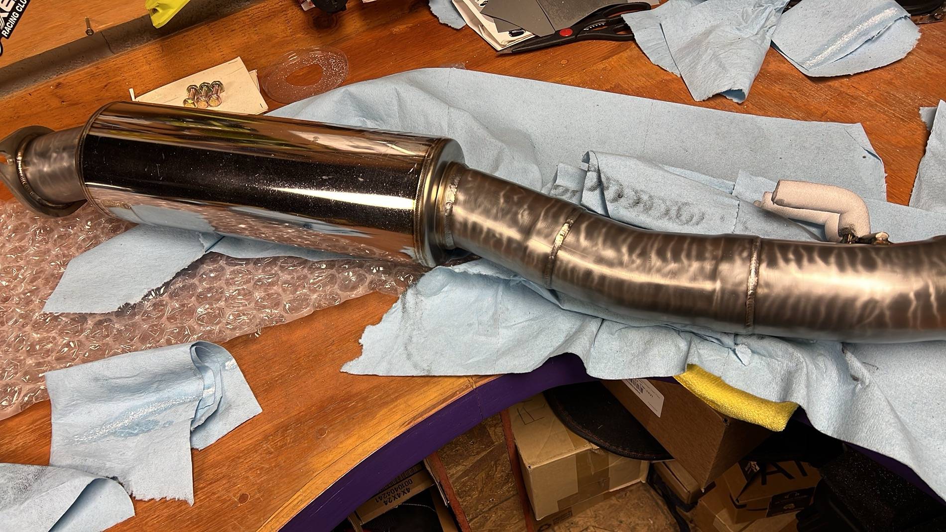

I went to work with a rotary tool and varying abrasive grits, although didn’t want to grind so much metal to fully get out the deep tooling marks and scratches, so gave it this flame-style finish partly inspired by guitar tops. The pipe without muffler became more subtle with more sanding/polishing after etching the flames, I left the midpipe with muffler more pronounced.

Cleaned up with CitriSurf 77

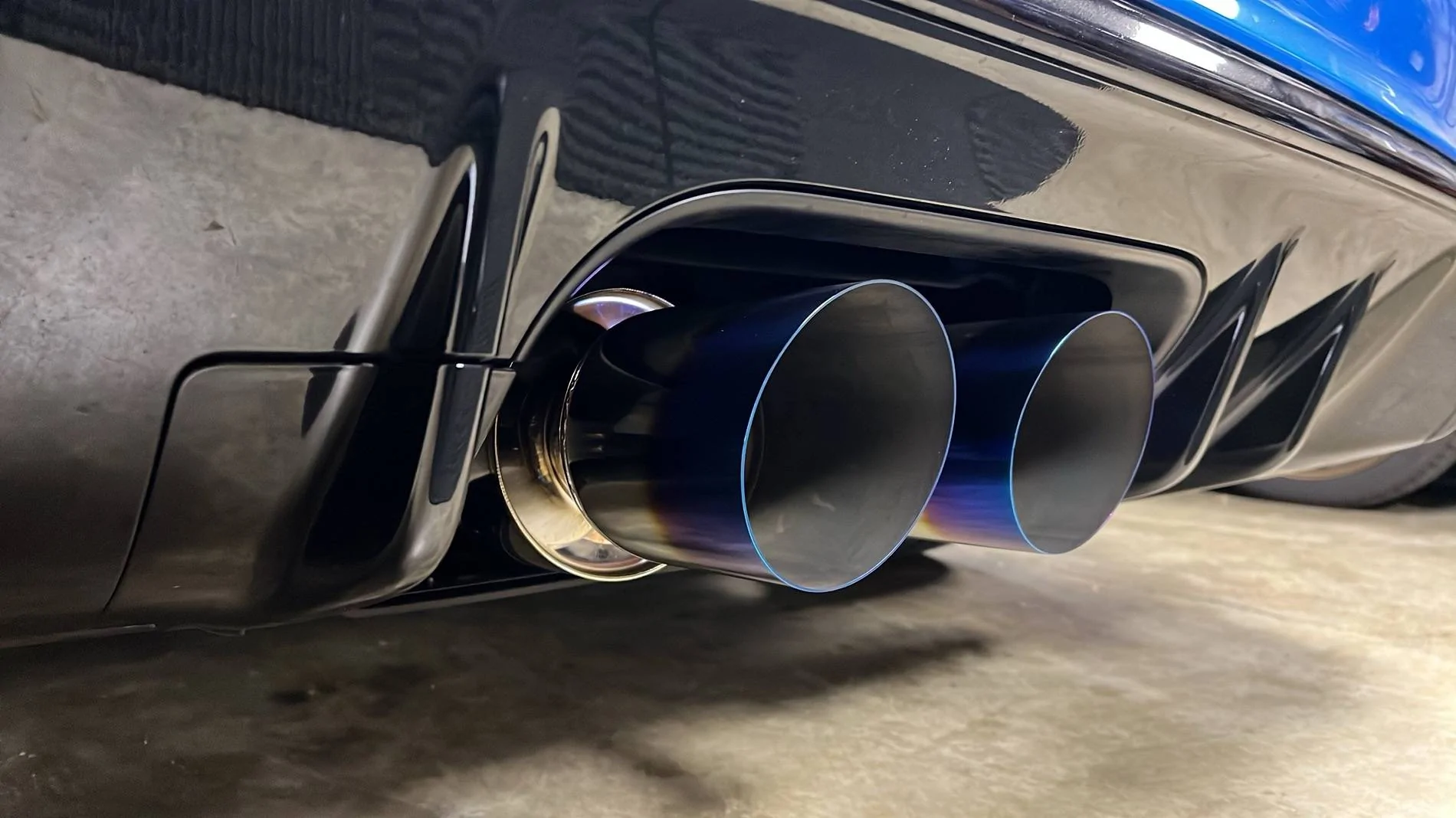

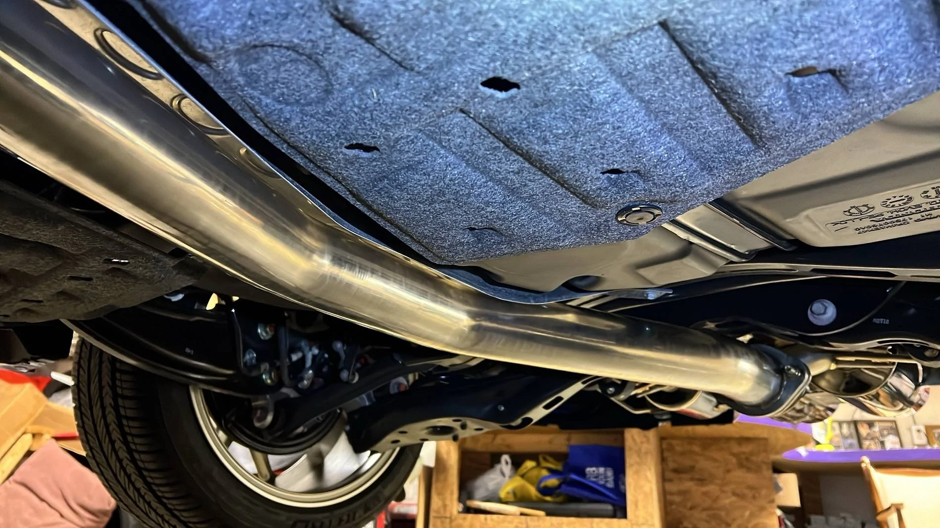

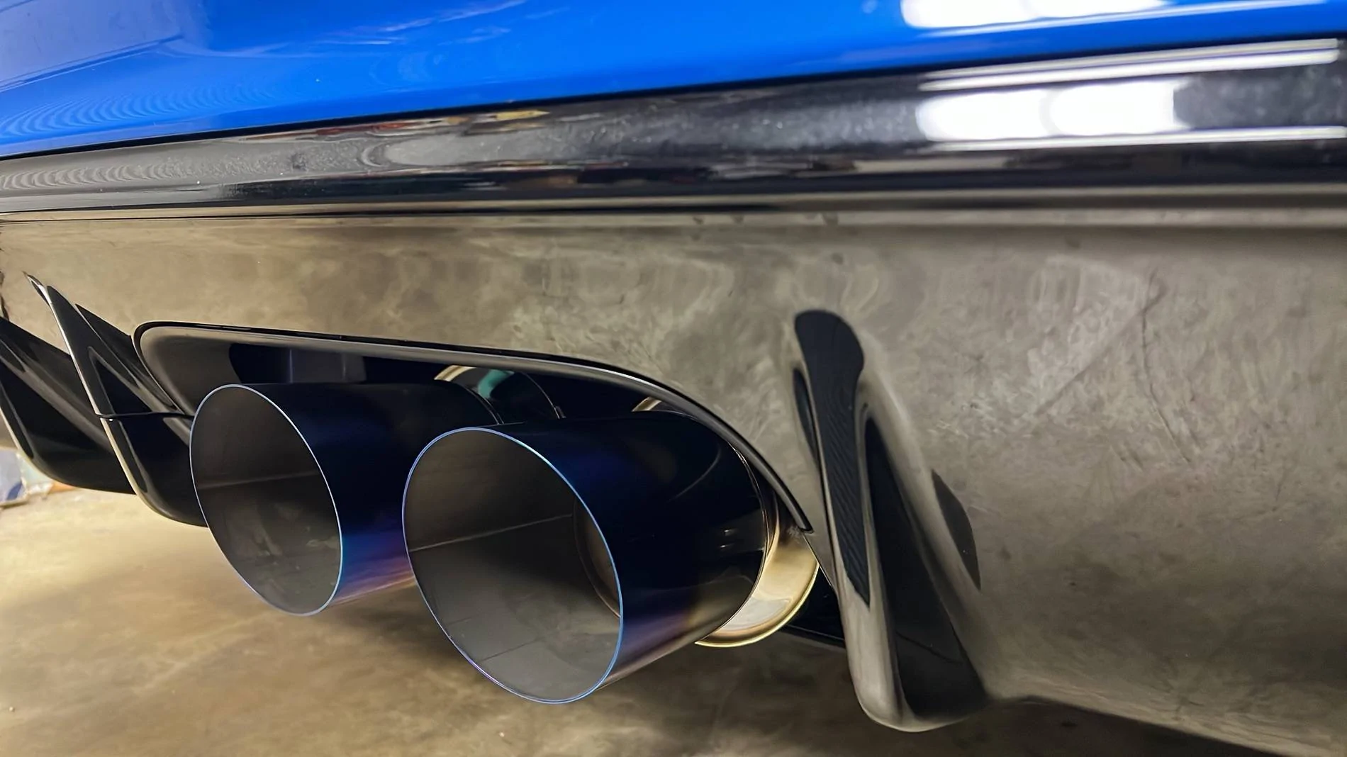

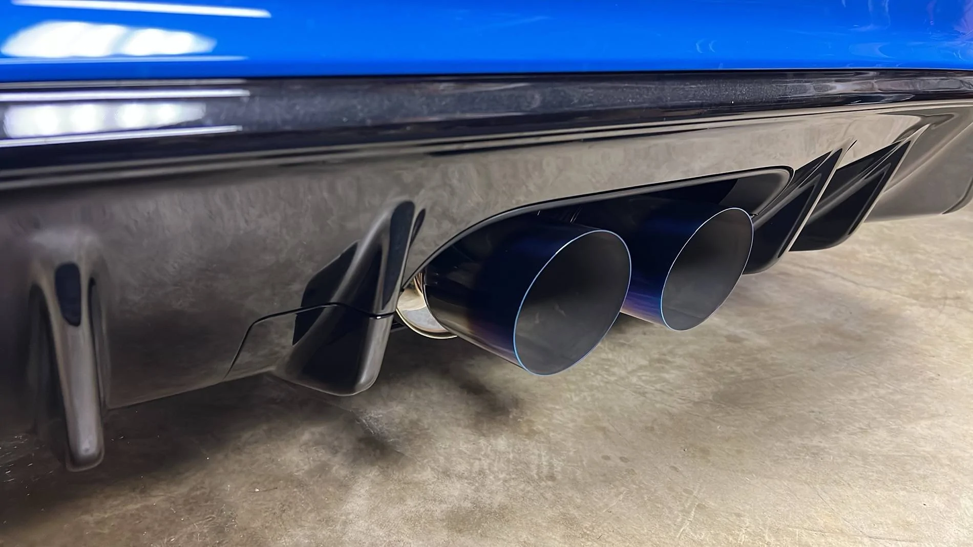

I finally got it installed behind my PRL frontpipe which I had put on in December. From inside, the tone, volume and how it responds to throttle is great, with the windows up or down. Before and with the PRL frontpipe, the stock exhaust was still masked by the bass and vibes from the PRL RMM, which I enjoy. But now there is noticeable sound coming from the rear of the car. It maintains a good sound when you fully open it up, and it doesn’t drone when cruising in an overwhelming boomy way, so I’m quite satisfied. Here’s how it turned out.

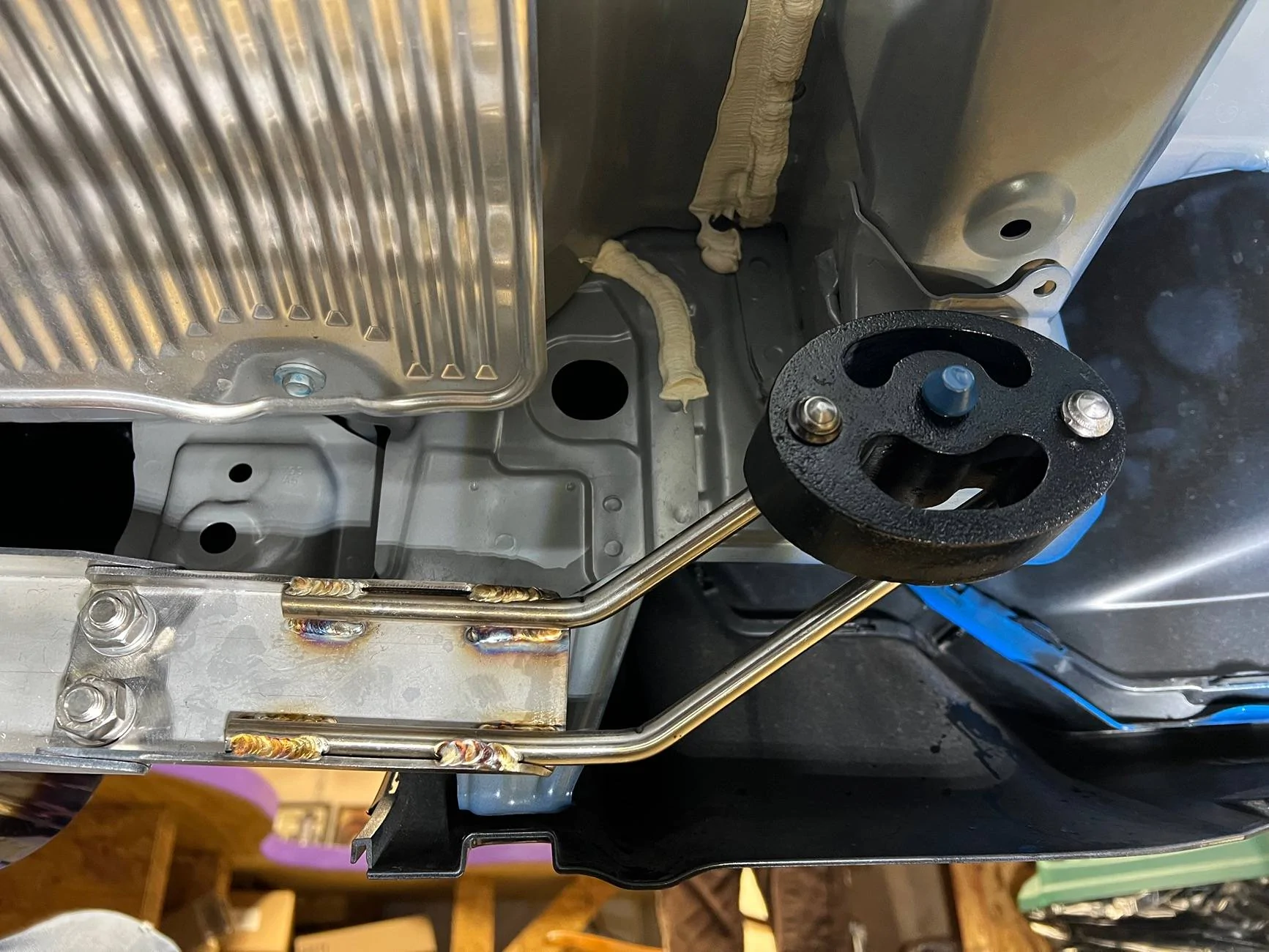

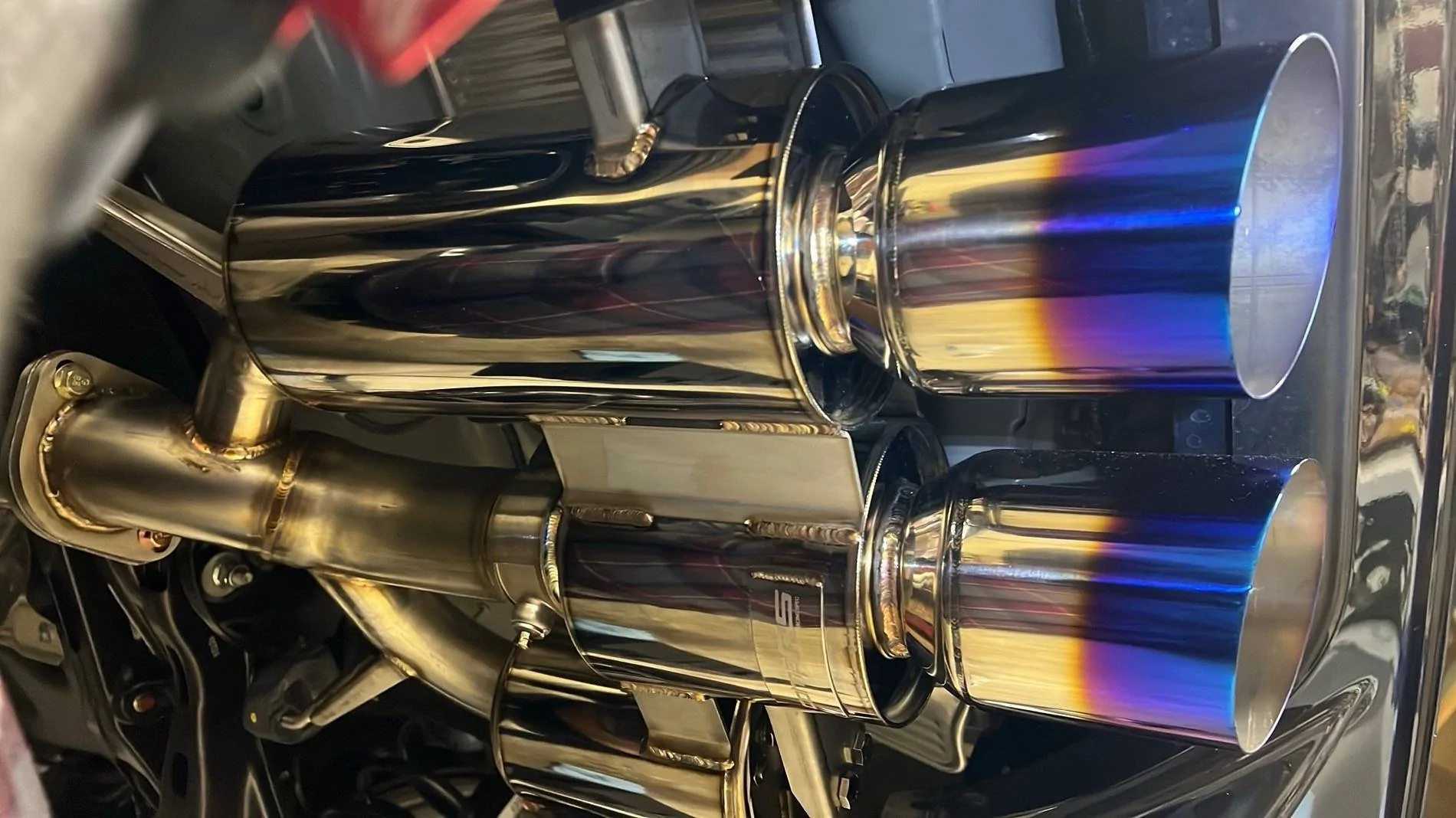

Got some polyurethane 3-hole and epdm hangers to help adjust the tip positioning. The outside holes of the poly hangers are offset from the center so I could flip one to counter the added weight of the Helmholtz resonator on one side. The epdm ones are also a bit shorter than OEM. Super happy with this exhaust.

Swapping the hangers isn’t necessary, but I think was worth it for my install. I could tell the passenger side hung a little lower than the driver and I wanted to correct that, and try to prevent sagging over time. It was really only a matter of a couple millimeters.
No valve rattle, but unlike other valved install info, connecting the controller to have it “reset” wasn’t necessary, the MXP arrived in the correct position to mate it to how the controller defaulted after shutting off the car. I don’t think you should have to twist/preload the coil at all to line it up with the notches in the top of the valve.
