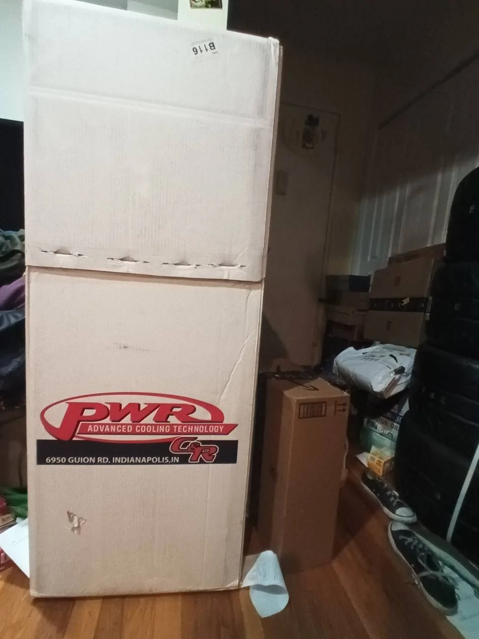

I have zero experience with PWR but based on history their intercooler should be great. I wonder how it stacks up against the PRL? ?
I mean they supply F1 and MotoGP teams, so I would think they are top notch.
It's about 10 pounds lighter than PRL and 4 pounds heavier than stock
