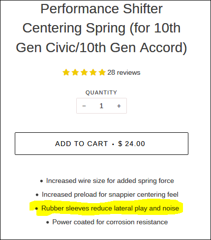

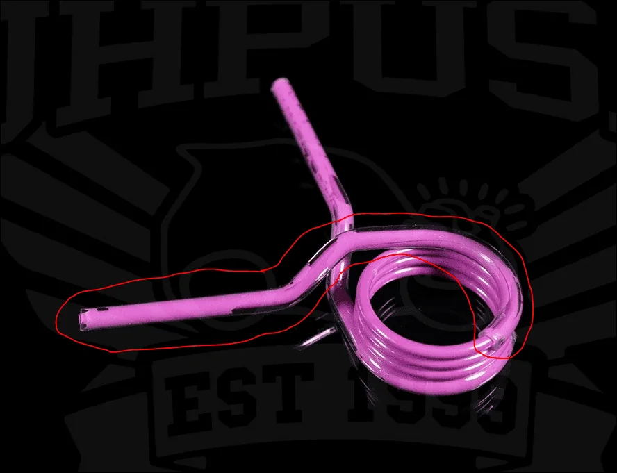

The newer centering spring has a transparent plastic sleeve on both ends of the spring for noise reduction. Can you check to see if yours has them? If not, contact Acuity for an exchange?
11th Gen Honda Civic ACUITY Prototype 10th-gen Shifter - My review upload_2020-1-3_20-30-9
From Acuity website:
11th Gen Honda Civic ACUITY Prototype 10th-gen Shifter - My review upload_2020-1-3_20-30-55
This is not accurate. The full shifters have never been sold with rubber sleeves on the spring. You are showing a spring we sell that works on the OEM shifter only. The rubber sleeves on that product are largely to take up poor tolerances on the plastic OEM parts so that the spring makes full contact at 4 points in Neutral. This reduces lateral play in the OEM shifter in neutral when compared to the OEM spring. Noise reduction is a benefit, but not the purpose. The spring used on the full shifter is notably stiffer and cannot use similar rubber sleeves as the forces involved would destroy them.
I do not believe that mine does. Ugh, that would still require me to disassemble my entire center again though, wouldn't it...
So the noise you're illustrating is the spring contacting the rest, as I had suspected. I think this is largely the result of how you are shifting. I also daily drive with one of these shifters (it has about 1.5yrs and 20k miles on the unit I have in my personal car). If I let it snap back to center on its own, you can definitely replicate the noise of the spring contacting the rest, as you have shown. This is to be expected though as you have a steel spring contacting an aluminum rest. That said, generally, when shifting, I am guiding the shifter from 2nd to 3rd and not letting it snap back under its own force entirely. It's not as intentional as it sounds, since it's basically just muscle memory in action, but that's the nuts and bolts of it. Our full shifters are meant to be race car parts that have enough refinement to be equipped to street cars. There is no doubt they are more aggressive, but that is the goal. It's not different than equipping stiffer engine mounts, or a stiffer suspension. Performance increases, and sometimes there are small, but noticeable increases in noise vibration etc. With our shifters, we have minimized this quite a bit, but it is hard to get away from it entirely given that it is made mostly with metals, as opposed to plastic.
