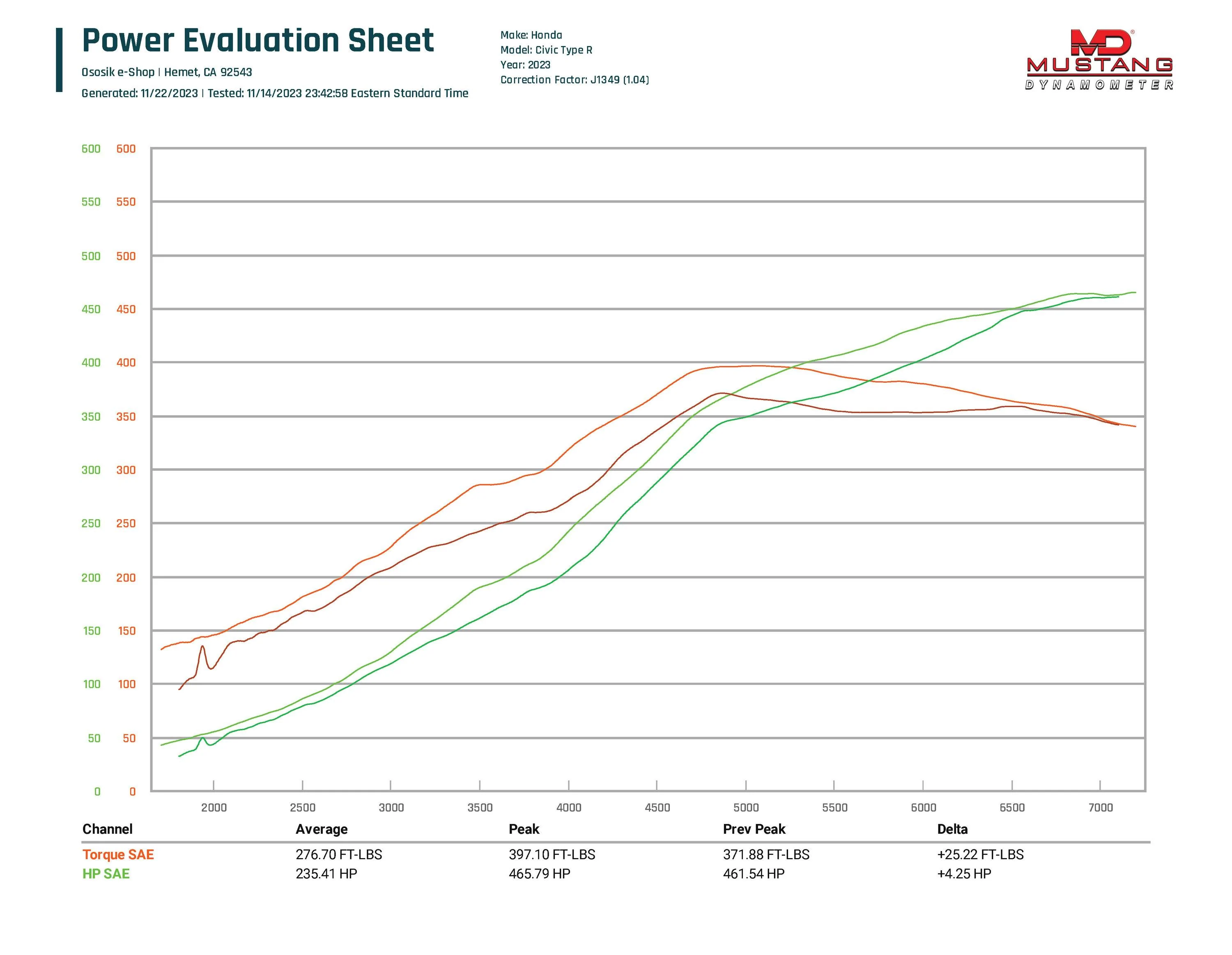

Our in house dyno is a Mustang Dyno AWD MD500. Currently the video and graphs show where Daniel (powermetric) stopped but as you can see Cam tuning really wakes up the mid range and if you have an aftermarket turbo this will definitely bring back the "stock turbo" spool feel..sort of, but in the end the peak power makes all the difference and I live above 4k RPM anyway. As always choosing a set up depends on your own goals.

Before and after some Cam tuning (more gains to come soon)....
11th Gen Honda Civic 4 Piston TR2 Drop In Cams | Civic Type R FL5 ososik-fl5-p700-E50-dp+ic-tr2-camtuning-vs-noCamTuning

Wow, the gains over 4k to redline are impressive. Wonder what this would look like with some springs and a raised redline.

It is raised redline.

The graph shown looks like the stock car was cutoff at like 6700 and the upgrade at 7500 (yes, higher but not much - I hadn't noticed though)?
Correct the stock one the run shows cut off at 6800 (if I remember correctly), because when it was stock I didn't want to bounce off the limiter to complete the dyno run.
