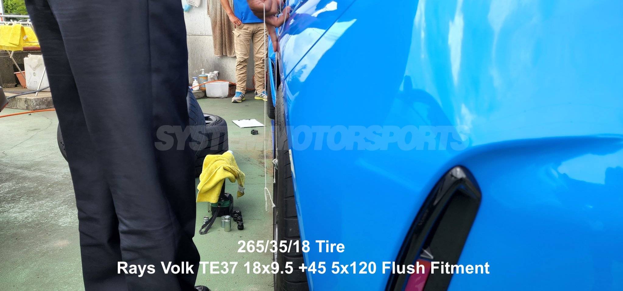

How's 18x10 +41 looking? My wheel math is rusty

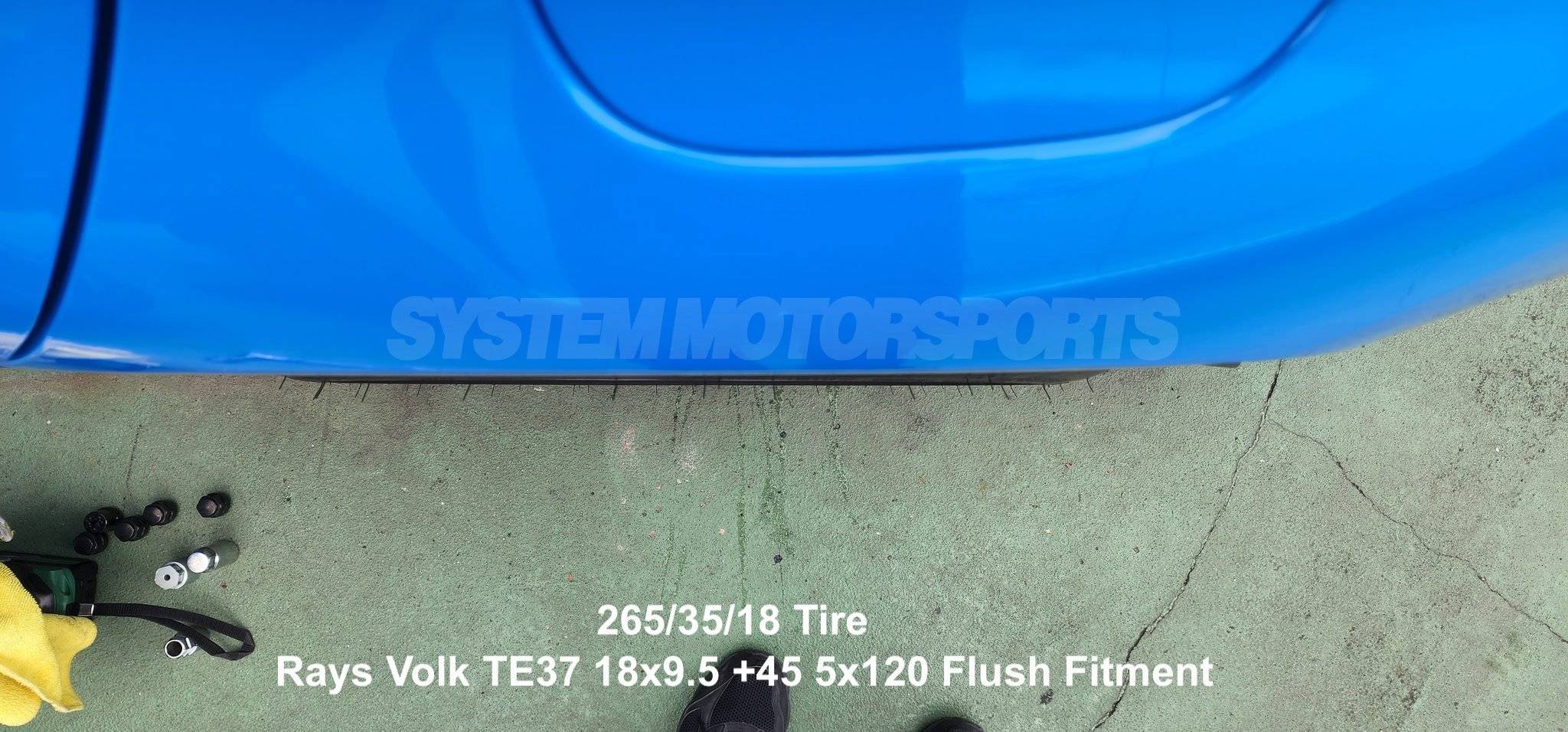

It will work but you might lack inner clearance - Our TE37SL in 18x9.5 +45 5x120 will have about ~2mm more inner clearance with the inner liner/firewall and at full lock, and it will be flush. The 18x10 +41 will be about ~10mm more outwards poke than what you see below.
This is TE37 18x9.5 +45 5x120 with a 265/35/18 tire.

Yes and no - The FK8 previous gen could fit 18x10 +41 (effectively same outward clearance as 18x9.5 +~35) which required fender trimming. It is very likely the new FL5 11th Gen CTR will not require any fender work for 18x9.5 +45 squared setup. The last thing people would like to do is to cut up a new FL5, so if one would like to fit 18x10 or even 18x9.5 +38, they would likely have to atleast massage the rear and front fenders on this new gen. The good news is that it looks like there isn't a "fake" flare on the new CTR like the FK8 Gen. We would say that only the 18x9.5 +~45 sizes would prove to be a bolt-on affair. It's a bit more conservative in sizing compared to the FK8 CTR from what we are seeing.
