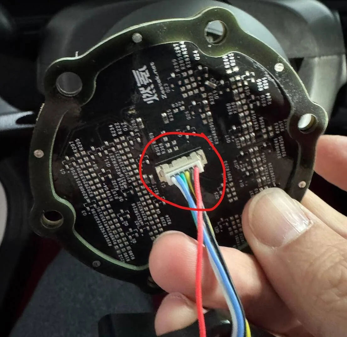

The first picture shows the Zestek-supplied harness connected to the factory Honda OEM steering wheel plug. I rechecked this connection, ensuring it was "snapped" and not semi-connected.

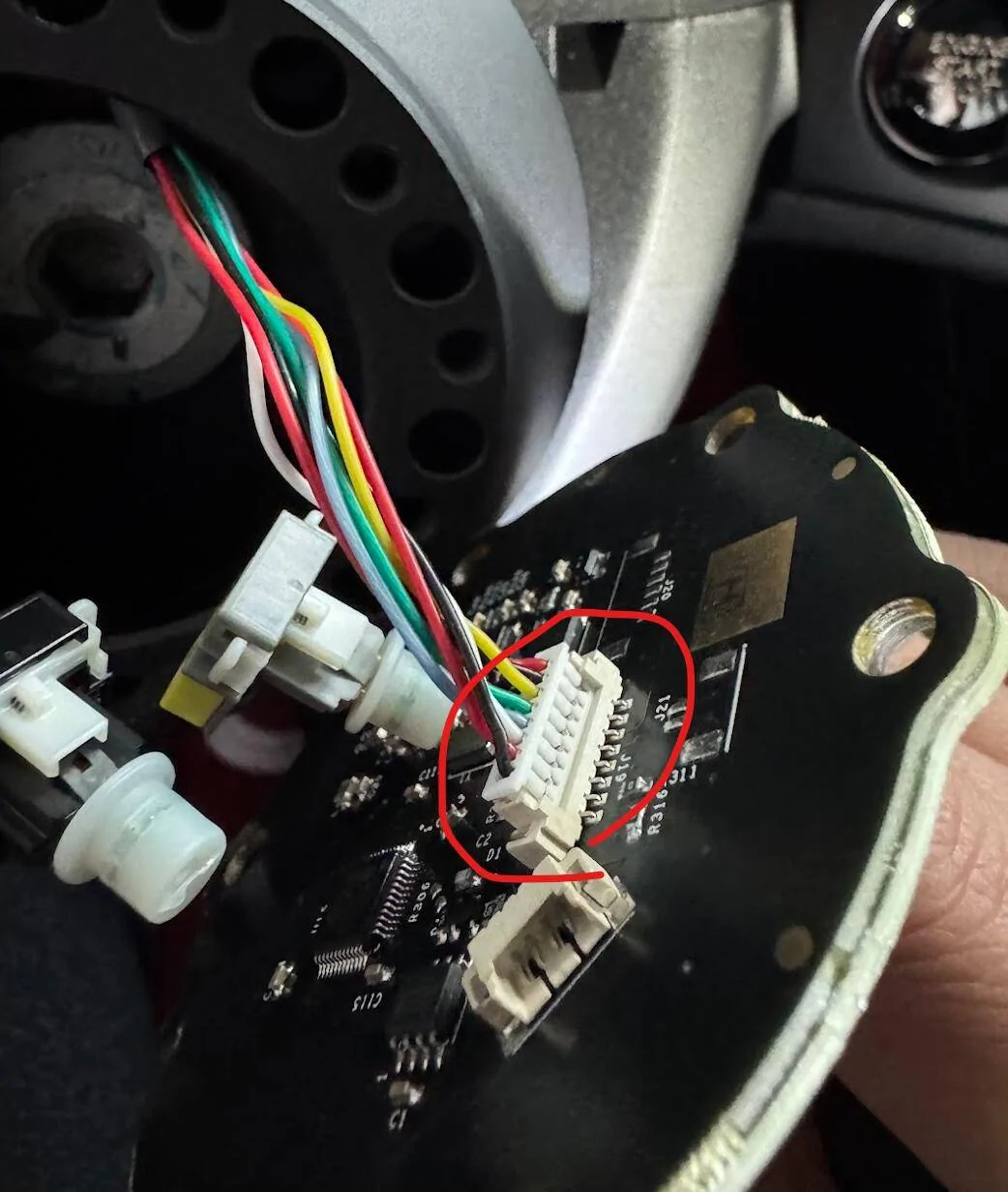

The second picture shows the Zestek-supplied harness now connected to the Zestek logic board. Again, I made sure the connection was seated correctly. Also, so that you know, the two airbag plugs are connected to the bypass plugs supplied by Zestek.

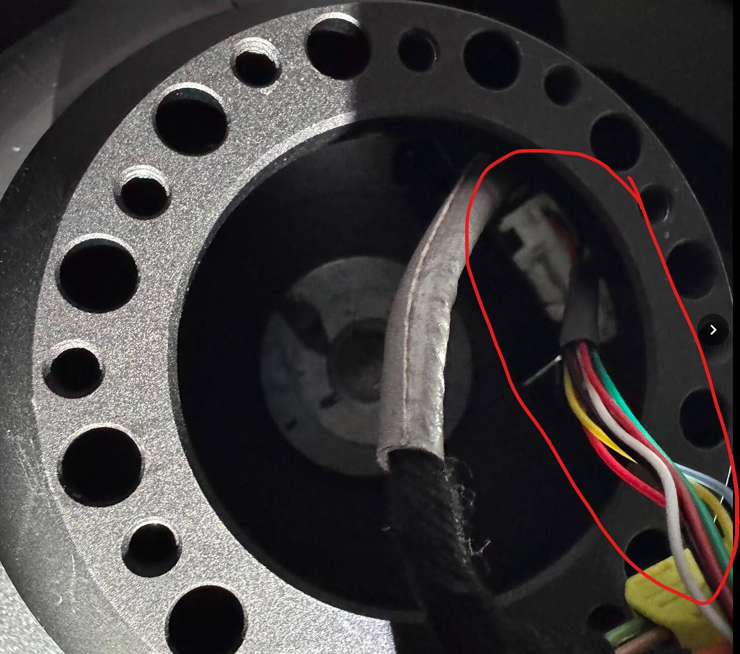

The third pic is of the Zestek quick-release cable plugged into the Zestek-supplied logic board. Again, I made sure the connection was seated correctly.

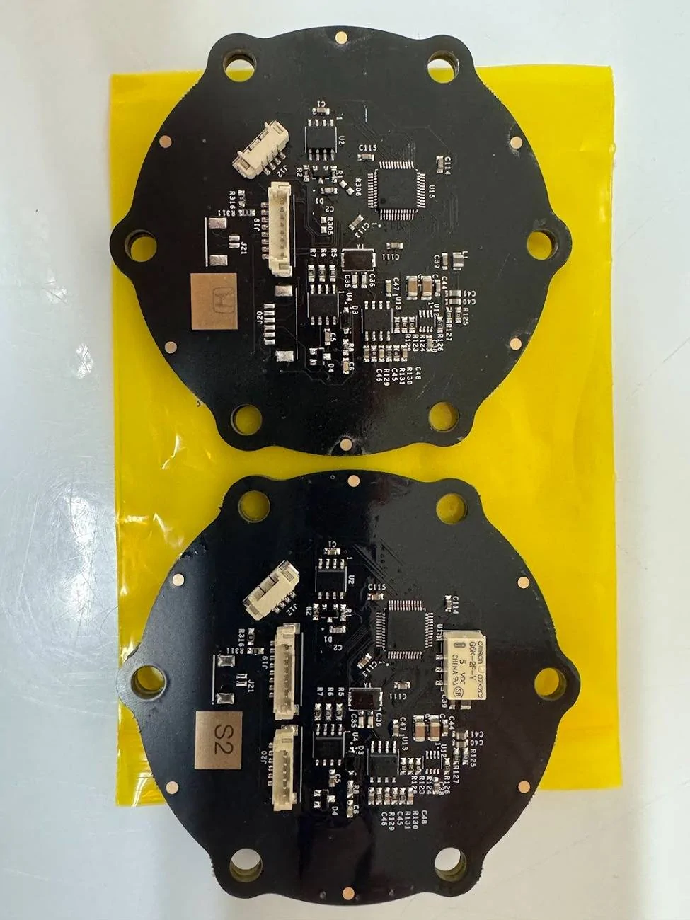

To close the loop on this, a new version of the board appears to be out. Tegiwa was gracious enough to send me a new board + harness.
The top is old; the bottom is new.

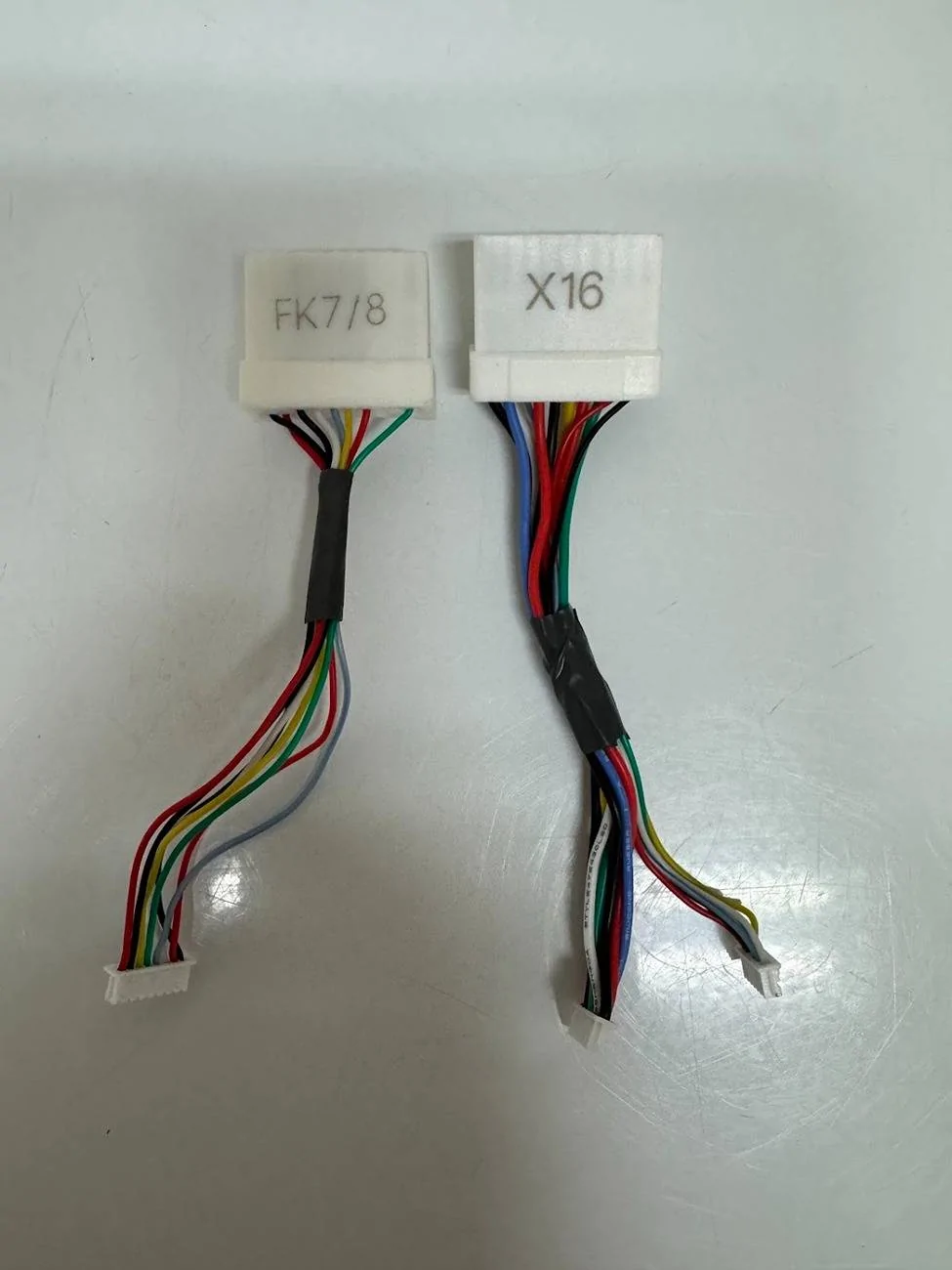

The left is the old harness; the right is the new harness.

A big shoutout to Tegiwa and their support staff, who got back to me. A shout-out to Jacob! Also, Zestek support finally contacted me after about 1 week, and I initiated two messages via Chat, who also recommended that Tegiwa send me a new board.
Lessons learned: buy expensive stuff, install it immediately, or within the return period. I purchased the Zestek in Aug 2024 and started the installation in Jan 2025.
