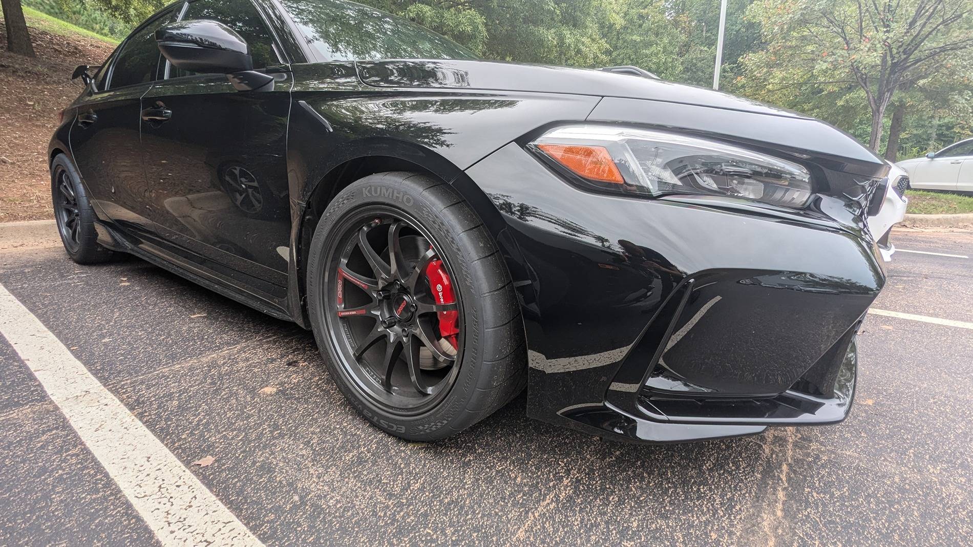

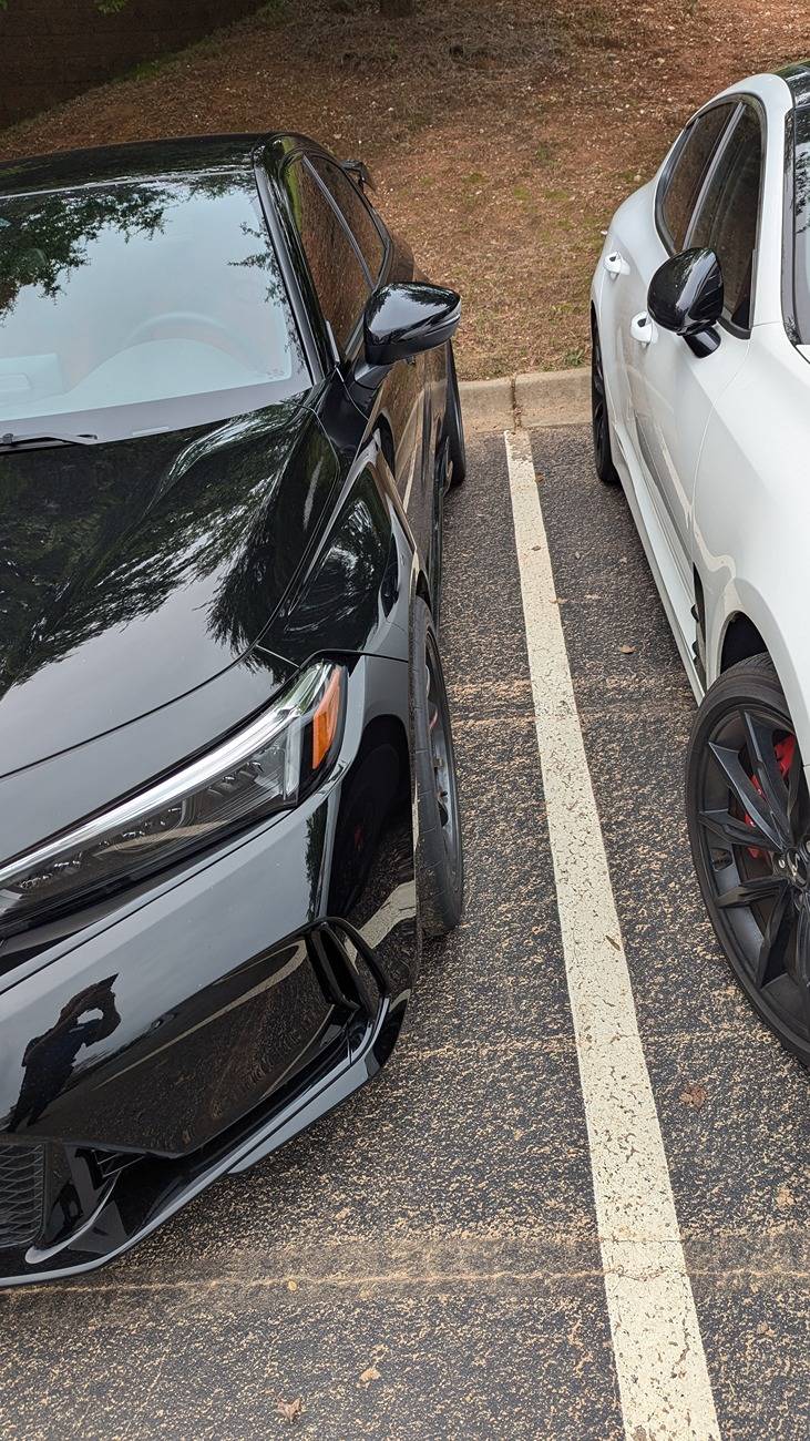

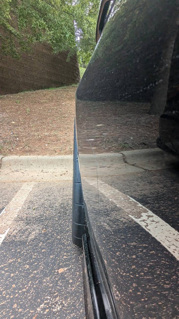

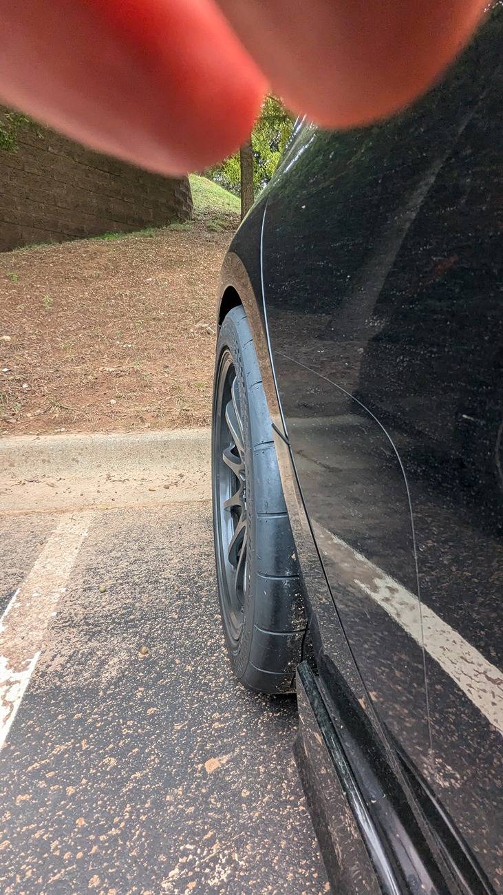

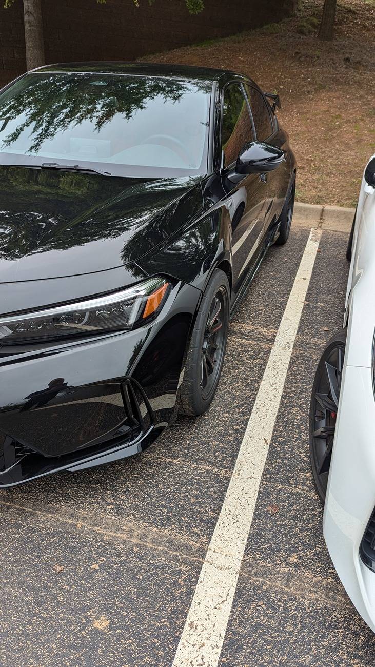

Currently running Eibach’s FL5 specific Sportline-kit springs (1.2 inch drop on the front and .9 inch in the rear) along with TE37 SL’s 18x9.5 +45, perfect flush fitment, with 275/35 on Falken FK460’s. No rubbing at all, so you’ll definitely be fine at stock height.
Experience may vary depending on your spring/coilovers, how aggressively you drive, and tire choices. I’ve heard that depending on the tire manufacturer, some tire sizes aren’t what they say they are and can be slightly inaccurate. So stick with good brands or ask what people are running on their wheels.
