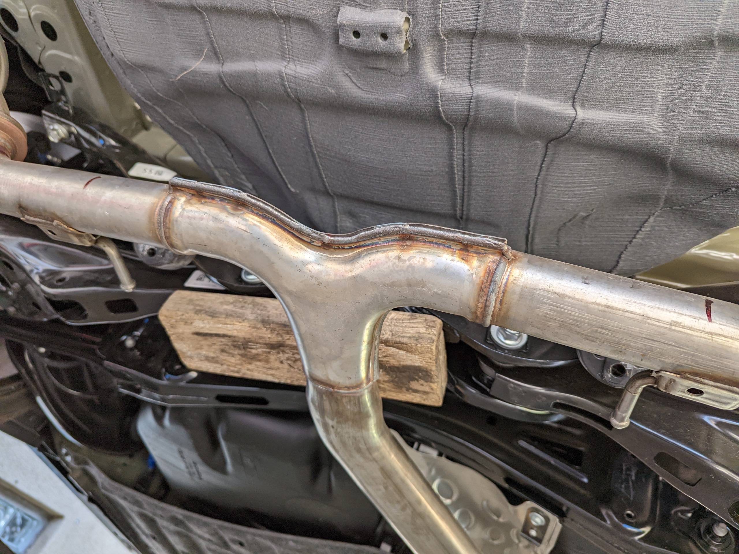

I installed a Whiteline 22mm rear sway bar which is pretty straight forward. You should order the Accord end links and 10th gen civic bushing brackets for the new sway bar. The only issue I encountered was I couldn't snake the stock sway bar out without having to remove the riveted together mounting brackets. I had to use a angled die grinder to break the rivets, once the brackets were removed from the bushings, the bar was able to be removed.
