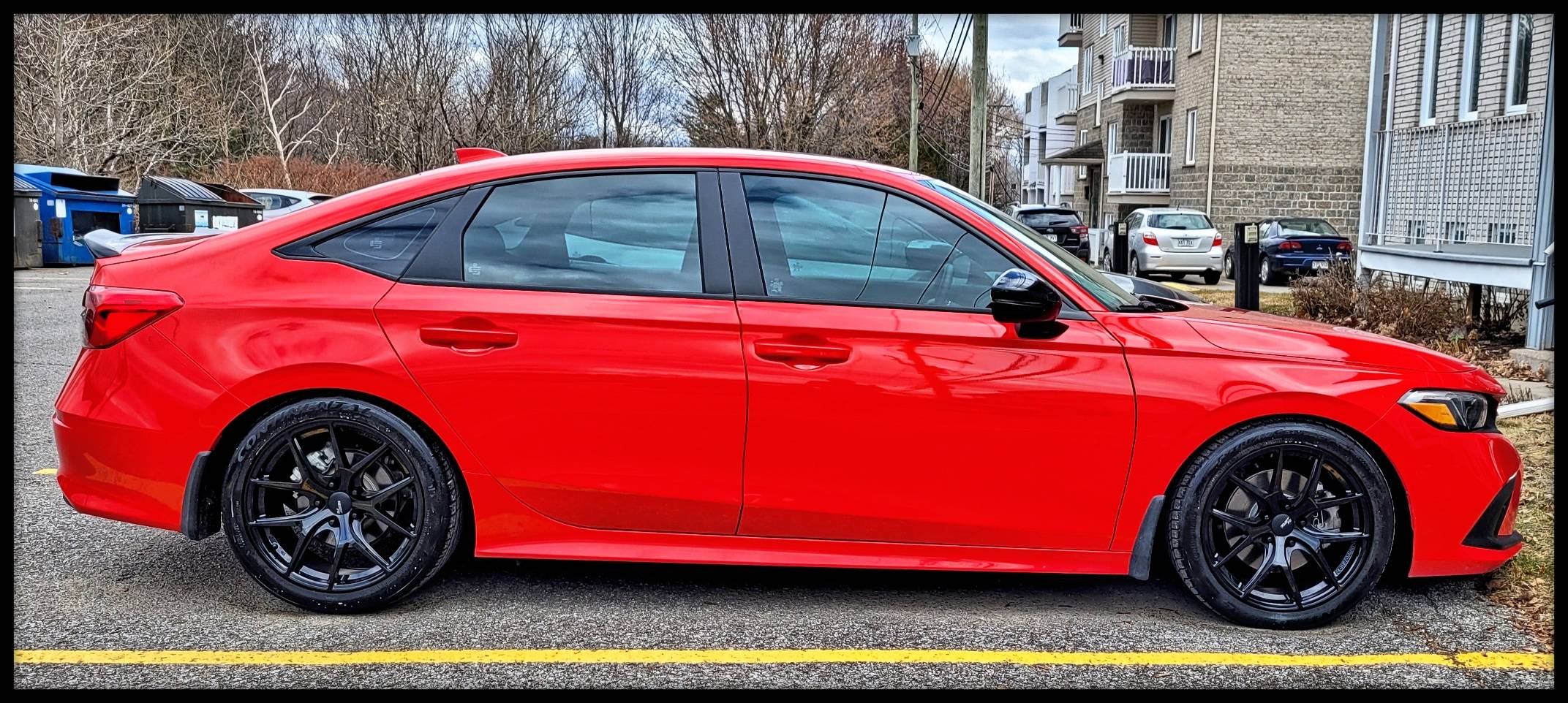

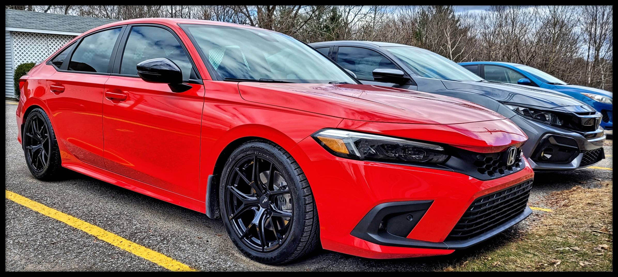

I work in parts for Honda and did all my research on what would be the best ...Eibach are ok,they will fit fine with the # E20-40-036-02-22 (SI) but one thing you should know is that the SI as a higher spring rate than the 10th gen one especialy in the rear (54% more)so if you go with 10th gen spring that will fit #1,you will have a lower spring rate than oem...you will feel the rear less stable!! and most spring will lower the rear more than the front!
I have and SI 2022,Im lowered and like i said i did all my research and my choice was to go with SWIFT SPEC-R springs that are made for Japanese cars ..the car stand's equal all around (1.1" fr / 1.1" rear)...and right now i have the same spring rate rear than OEM and 48% more rate in the front that makes the car more stable......
The car rides like it's oem ,but much more stable
Here is a pics...sorry about the Steelie..i live in Quebec/Canada and we still have alot of snow here ..in 2 weeks it should be on the oem wheels
It's been 3 weeks....let's see those beautiful 18's! :headbang:

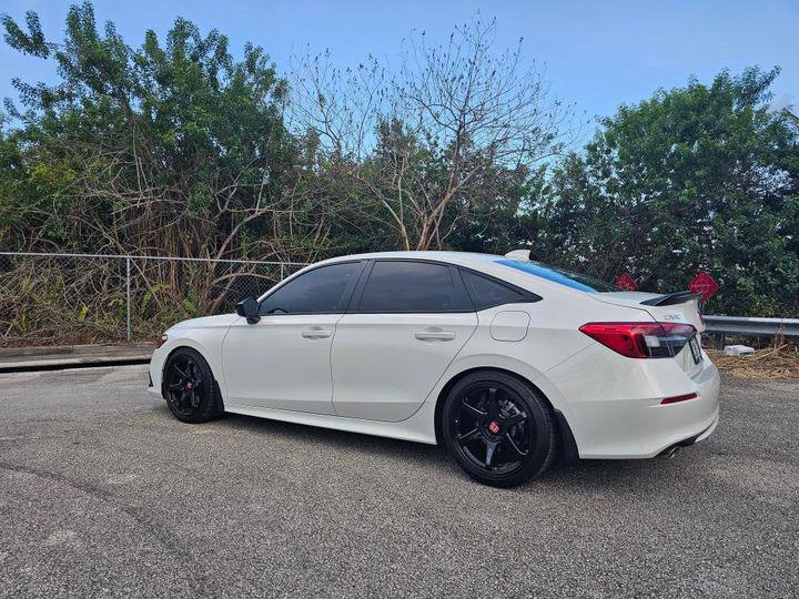

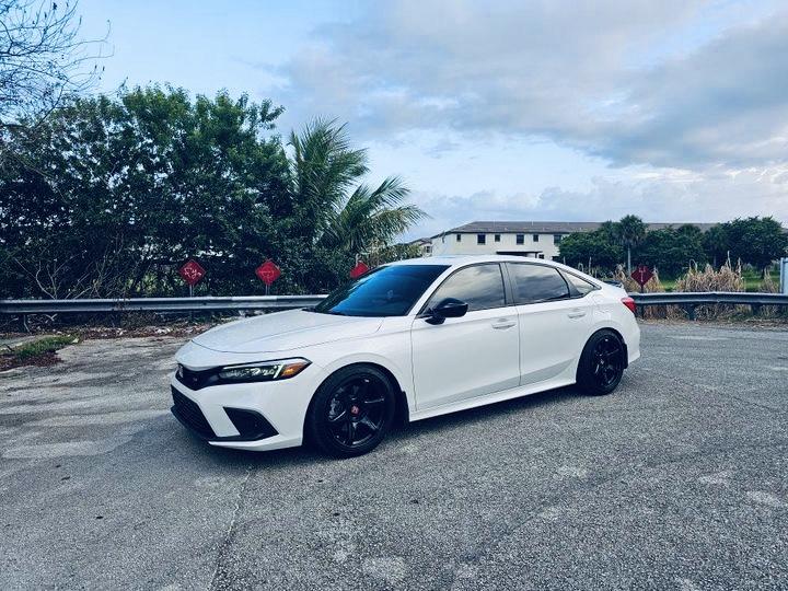

Just installed Eibach Prokit for the 11th Gen. They came out amazing and so far no noises or rubbing. They still have to settle but should be good to go if anyone was on the fence for Eibach you should definitely consider it.
My set up:
Eibach Prokit
Enkei T6R 18x9.5 +38mm/5x4.5
Michelin Pilot Sport A/S 4 235/40R18XL
11th Gen Honda Civic 10th Gen Eibach Sportline Springs installed on 11th Gen Civic Sport 08338B47-C94C-4EB1-AB97-50DCD49E6023
11th Gen Honda Civic 10th Gen Eibach Sportline Springs installed on 11th Gen Civic Sport 99BE4DF9-2500-4CE2-9B60-4EE7545C4633
