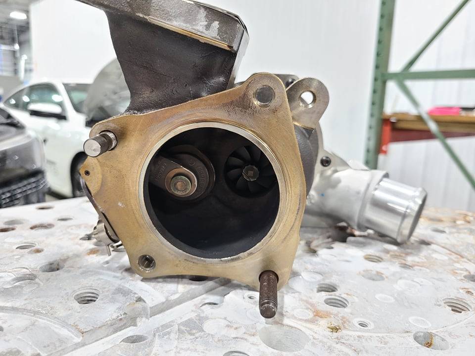

We can also see that the turbocharger is different in terms of compressor outlet routing and the fact Honda didn’t locate the BPV into the turbocharger inlet pipe. However, there are quite a few differences that aren’t so obvious to the naked eye. Honda implemented a new part number for this platform and which has been seen described as a high-efficiency turbocharger.

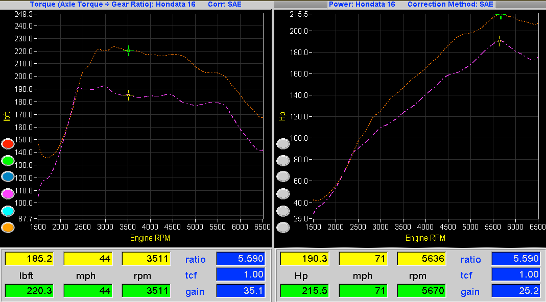

They both were perplexed with the super slow times. Sure the car is the equal to having a passenger in the car heavier than the last gen, but with the supposed power increase that shouldn't take a mid to high 6 second car to a 7.5 to nearly 8 second car. There's obviously more to it than that. And I think Hondata's testing is a great place to look. They use the same dyno (Church's Dynapack) for all their runs.
Back in 2016 their bone stock Touring dyno'd at: 190 hp / 185 tq:

Their 2022 EX dyno'd at: 162 hp / 163 tq:
11th Gen Honda Civic What’s new with the 1.5T 11th Gen Honda Civic and why we’re PUMPED e6c9244c-28c5-48cd-84f0-1d35501651e3-png
Clearly, Honda seems to have done some sort of detune to keep reliability and mpg numbers higher.
On the other hand, maybe what PRL is saying is that the 11th gen's 1.5 ultimately has more headroom to create more power than the 10th with the right parts/tune. Hopefully, PRL will publish their dyno results on a stock 2022 as well.
Our 2016 1.5T Touring (CVT) baselined at 183 hp https://tiremeetsroad.com/2017/05/0...ipe-front-pipe-combo-adds-10-hp-and-14-lb-ft/, while Honda rates these at 174 hp.
Our 2022 1.5T Touring (CVT) baselined at 169 hp http://prlarmy.com/Blog/2022-honda-civic-1-5t-silicone-hose-upgrade-release-dyno/, while Honda rates these at 180 hp.
It's worth noting the 2022 Civic ECU targets less boost than the 2018+ 1.5T Accord ECU for whatever reason. Could this be the reason for the power difference? Unfortunately we weren't able to log any type of data during our initial dyno runs. There may be some sort of background table or algorithm affecting power output as well - maybe not. We will find out more information regarding this shortly. Judging from previous data and Honda's factory output ratings (however you want to take that), we see the 11th Gen platform having a bit more headroom than the 10th Gen.

So this kind of confirms it. Where the 2016 power was underrated by Honda, the 2022 stock power seems to be overstated at bit and certainly reduced from the 10th gen.
Your numbers, Hondata's numbers and all the road testing pretty much show that.
