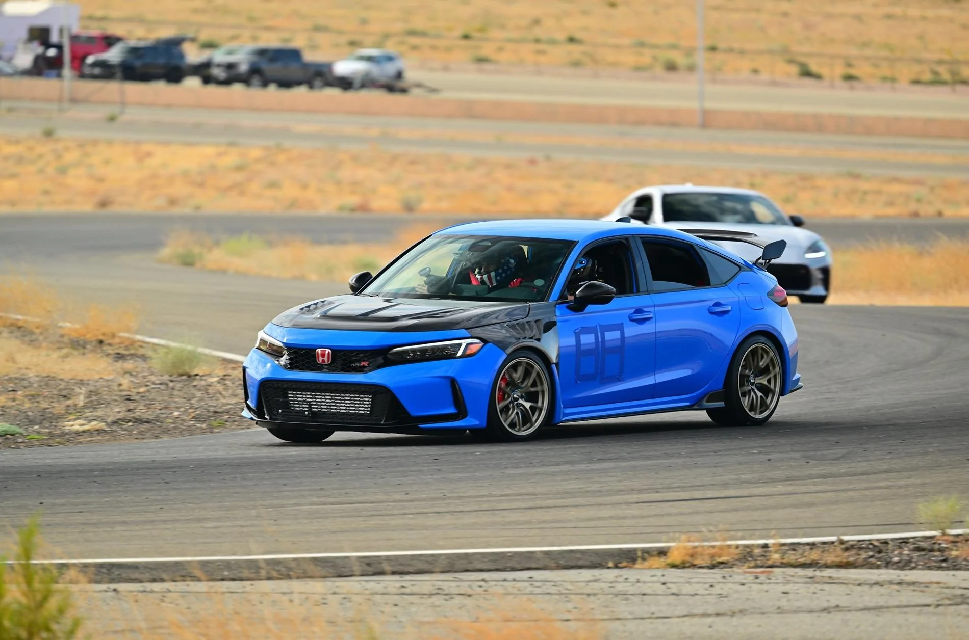

Yesterday, I went to the track and disabled the VSA by pressing the button, and the dashboard showed it was off, but it didn’t seem to work. The rear still wouldn’t slide. Am I missing something?
Also, in R mode, I tried left-foot braking, but the car wouldn’t hold the revs and felt like it lost power. Is this normal? Has anyone else tried left-foot braking in their Type R.
