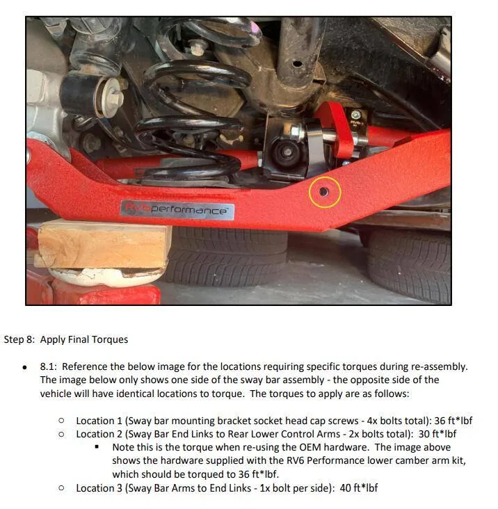

If your end links are making noise they probably need to be torqued down.
RV6 Torque
11th Gen Honda Civic Upgrade End Links w/ Aftermarket Rear Sway Bar? 1727386566604-2l
OEM Torque
11th Gen Honda Civic Upgrade End Links w/ Aftermarket Rear Sway Bar? 1727386442618-i
