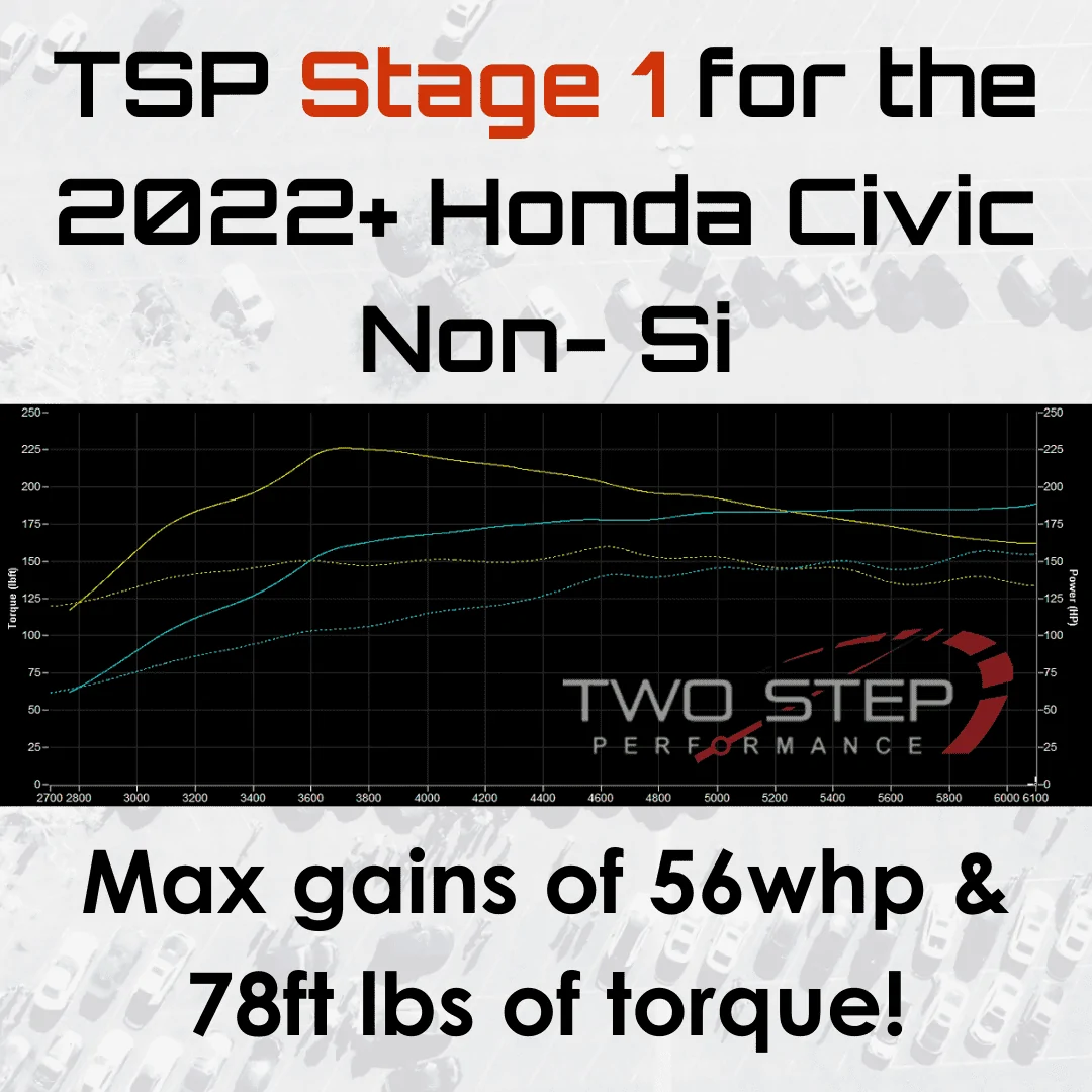

Two Step Performance and Derek Robinson are now offering the long awaited TSP Stage 1 tune for the 2022+ non-Si 1.5T Civic variants. After over 20,000 collective miles of street and dyno testing we can confidently and proudly offer the following:
Power output:
191whp / 227tq - TSP Stage 1 Tune for 1.5T Non-Si Civic XI
154whp / 163tq - Factory Calibration
(Dyno testing was completed on a 2022 Non-Si Civic with a CVT.)
As you can see, we were able to achieve peak gains of 37whp and 64ft lbs of torque over the factory calibration. If you take a close look at the dyno chart you will find max gains of 56whp at 3800 RPM and 78 ft lbs of torque at 3700RPM! There is also a very nice gain of 40whp at 5600 RPM.
Output was slightly limited to avoid risk of damage to the factory engine and transmission.

Good job guys. Still amazed how much lower a stock 11th 1.5T dyno's compared to a stock 10th 1.5T.
Yes I have to admit it is disappointing what Honda has given us this time. Let's hope the 6MT hatchback and Si do better.

So, it is possible to tune the 11th and get back on power parity with an untuned 10th. For those on the fence, this is massive good news. You get a lot more torque with the tune too! Win-win. ?
