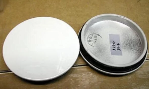

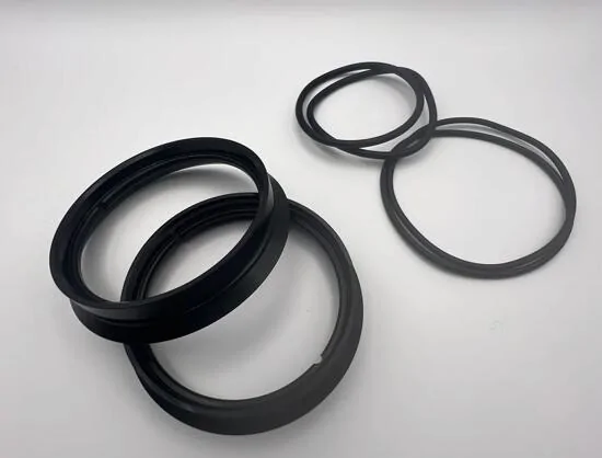

I have a set of Championship White TE37SL's in 18x9.5. I have run them with no center cap but recently, I purchased a set of TE37SL center cap adapters and Rays center caps. And this is where I am hitting a wall... it seems so simple, pop center cap adapter with included o-ring in and then pop on the center cap, right? Well, nothing I am doing seems to work and I could really use a little guidance. Here is what I bought:
Adapters - https://shop.lmtlsauto.com/collecti...cap-ring-adapter-aluminumincludes-o-rings-2pc
Center caps - https://shop.lmtlsauto.com/collecti...center-cap-o-ring-type?variant=46460556017923
They were hand picked by Luigi Arroyo from LMTLS Auto and sent to me. He confirmed this is what I need for my specific car. Any help? Thank you

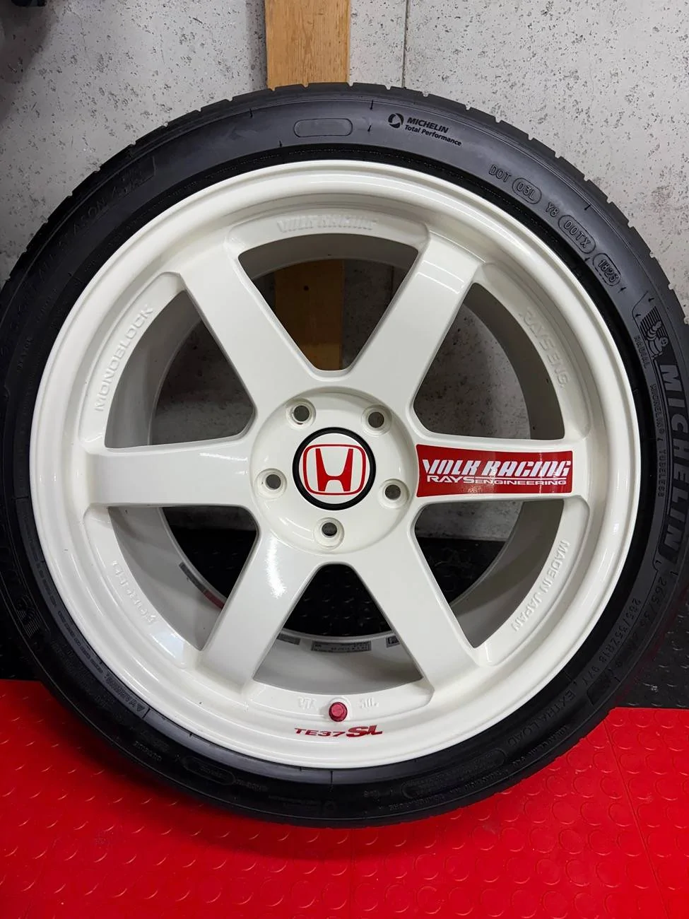

My goodness... I’m such a fool! I see what the issue was… the Rays flat center caps have an o-ring already on them from the factory. I was putting the o-ring that came with the adapter on top of that one! I didn’t realize I had to use a screwdriver and pry out the old o-ring to put the new, thicker one that came with the adapters. All good now!!

That looks pretty good. Makes me want to do the same. What Honda stickers did you use for that sizing?

I have my wife the png I found online and she got to printing and cutting!
