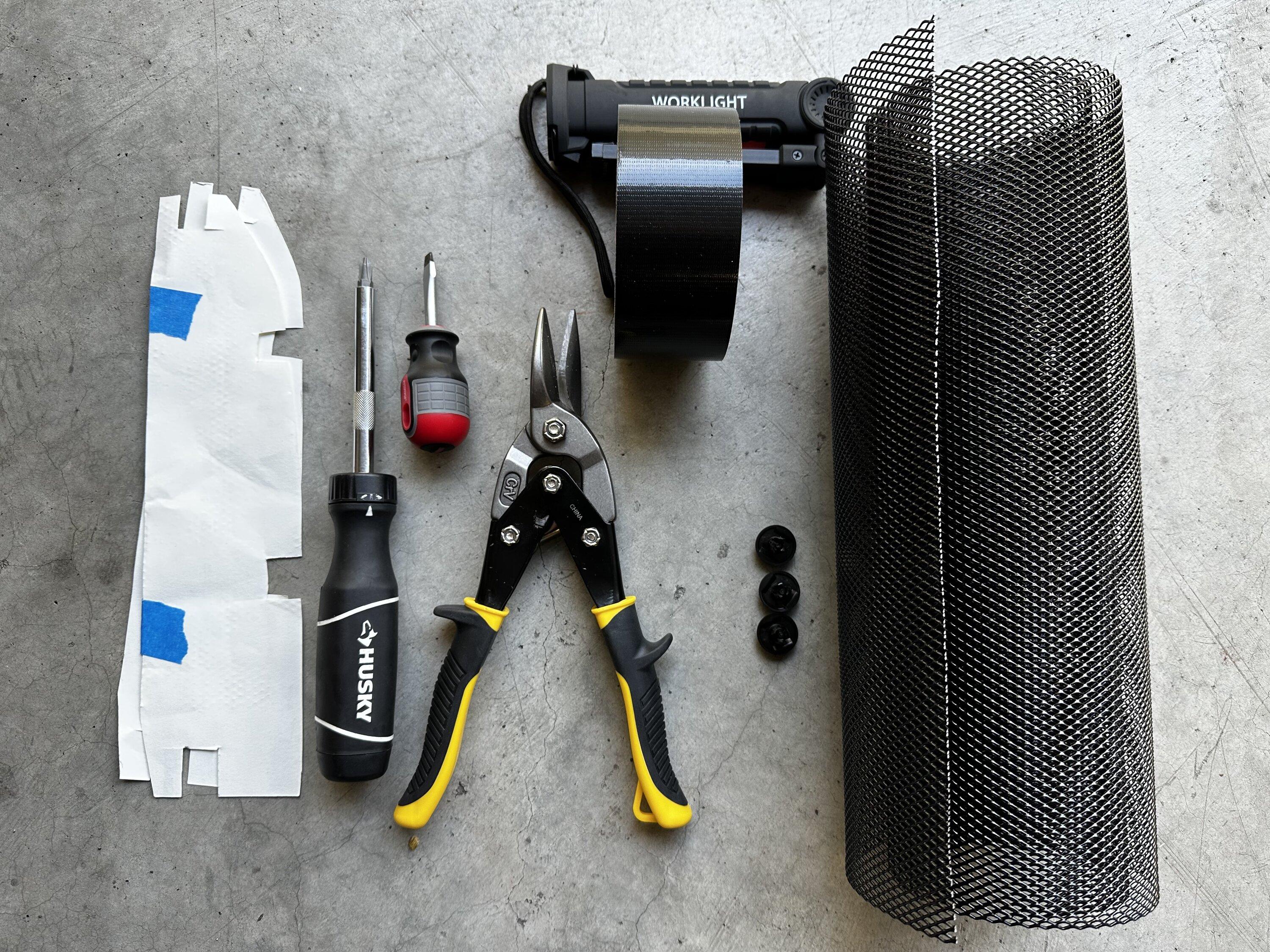

AggAuto Universal 40"x13" Car Grill Mesh 3x6mm Rhombic Holes

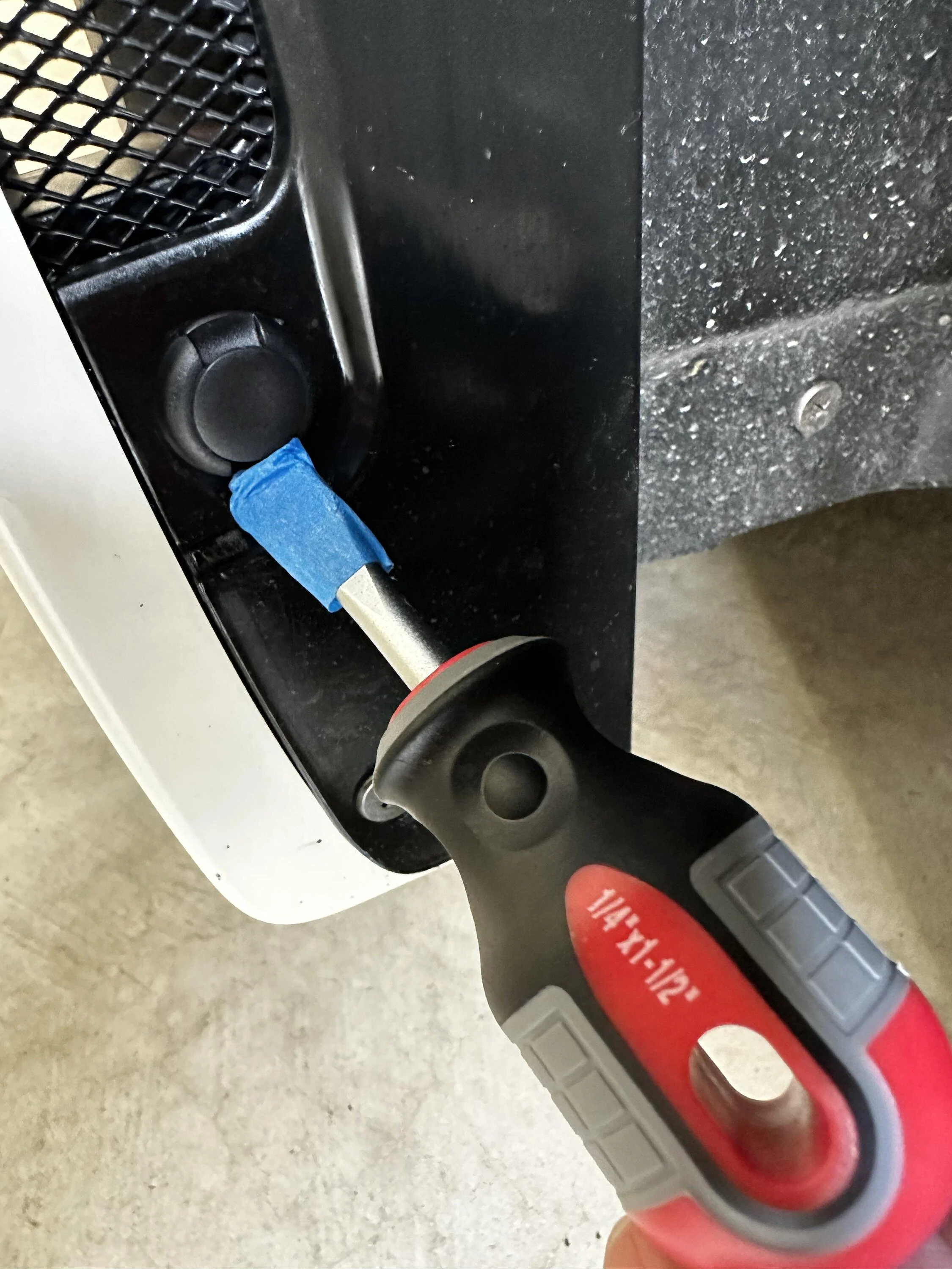

Black Gorilla Tape
Short flat head for the clips
The trick is to slide in the tab and wiggle gently.
Tried using two screw drivers and freaking broke the first clip
Dealer wanted 4.17 each! So I bought 4 then I figured it out how not to break it!Generic one works but I wanted OEM and right away so no choice…

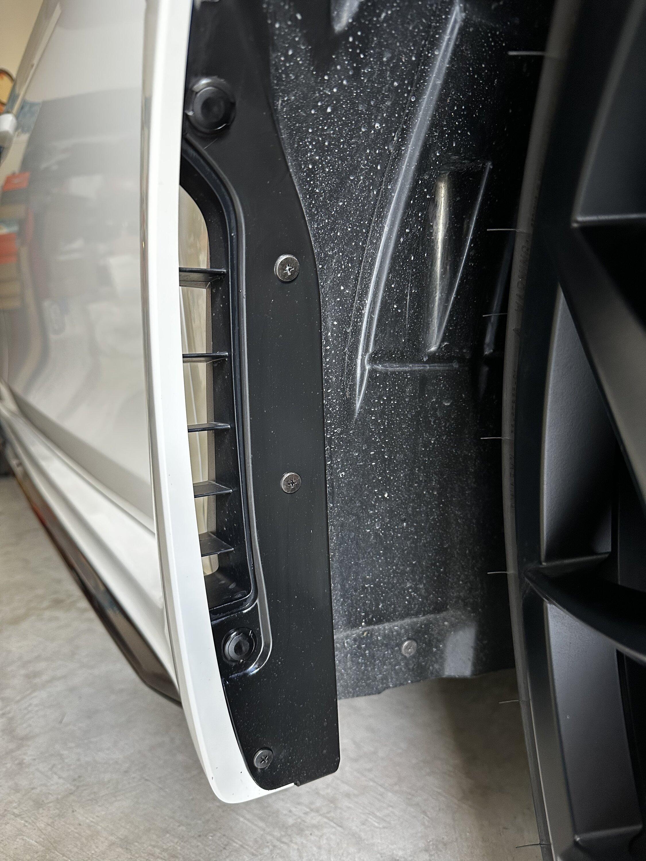

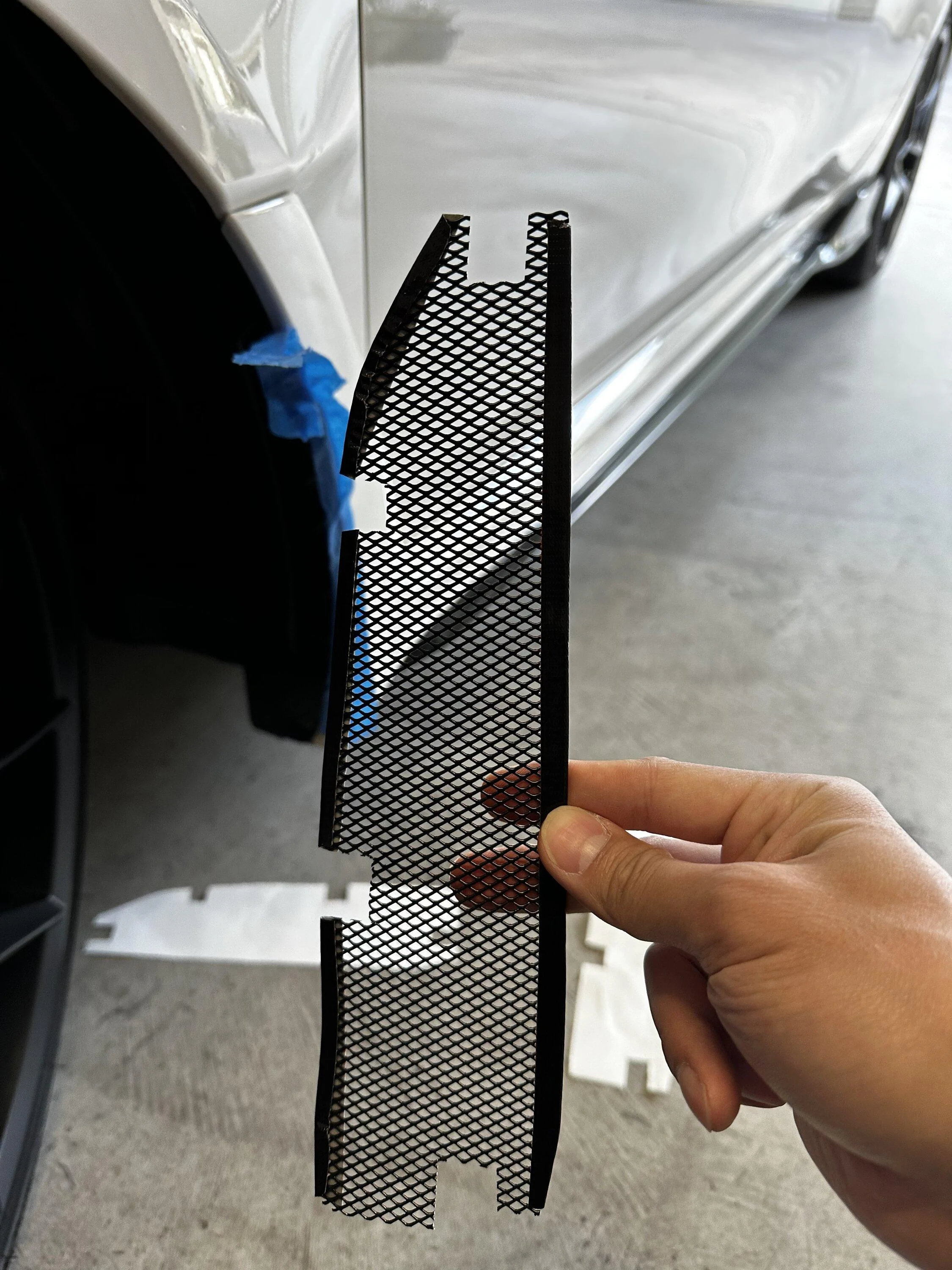

if anyone interested in the mask I can scan and make it printable.
The one I got online is actually off had to make my own.

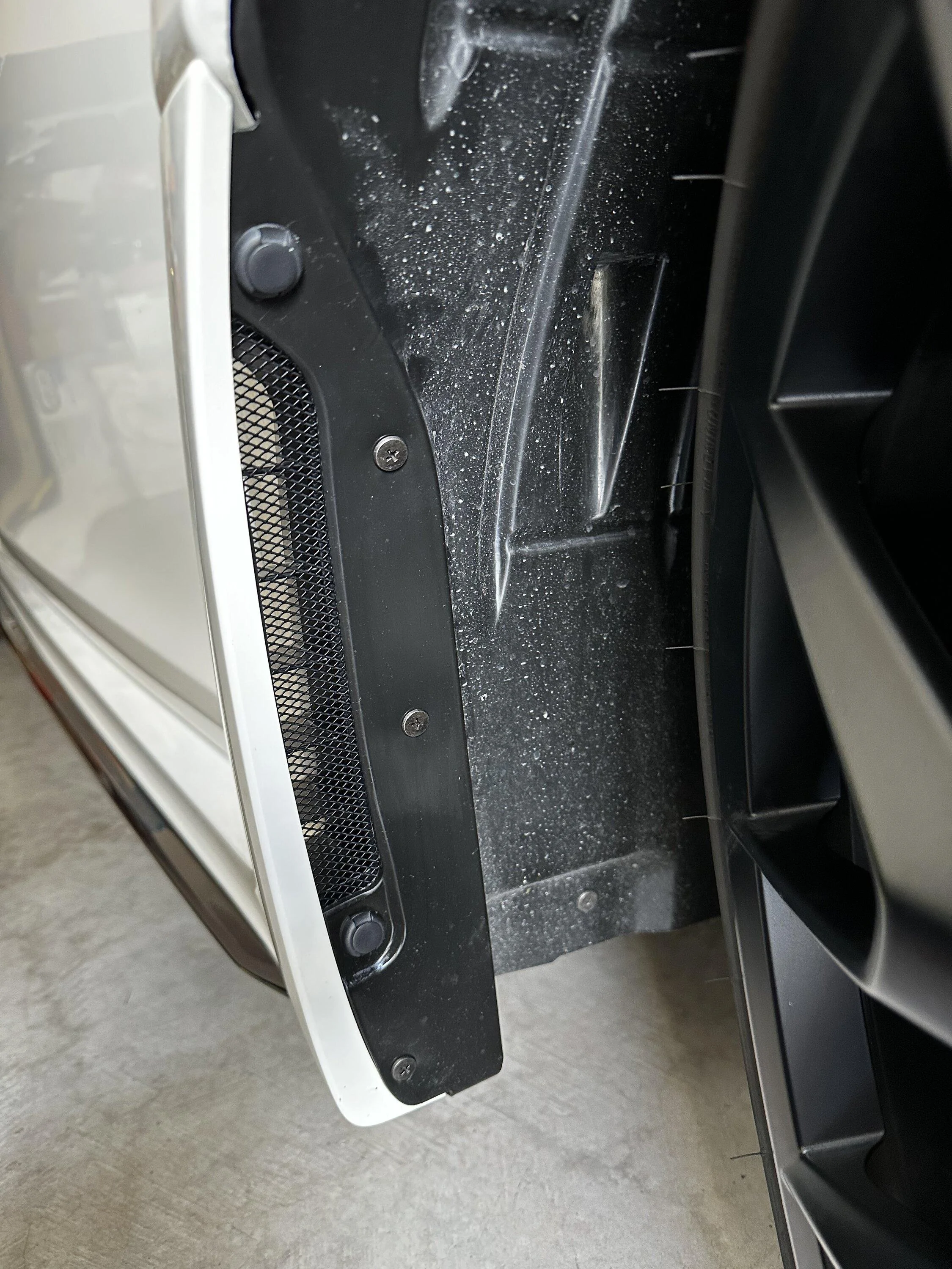

It looks ghetto but will turn out factory like.

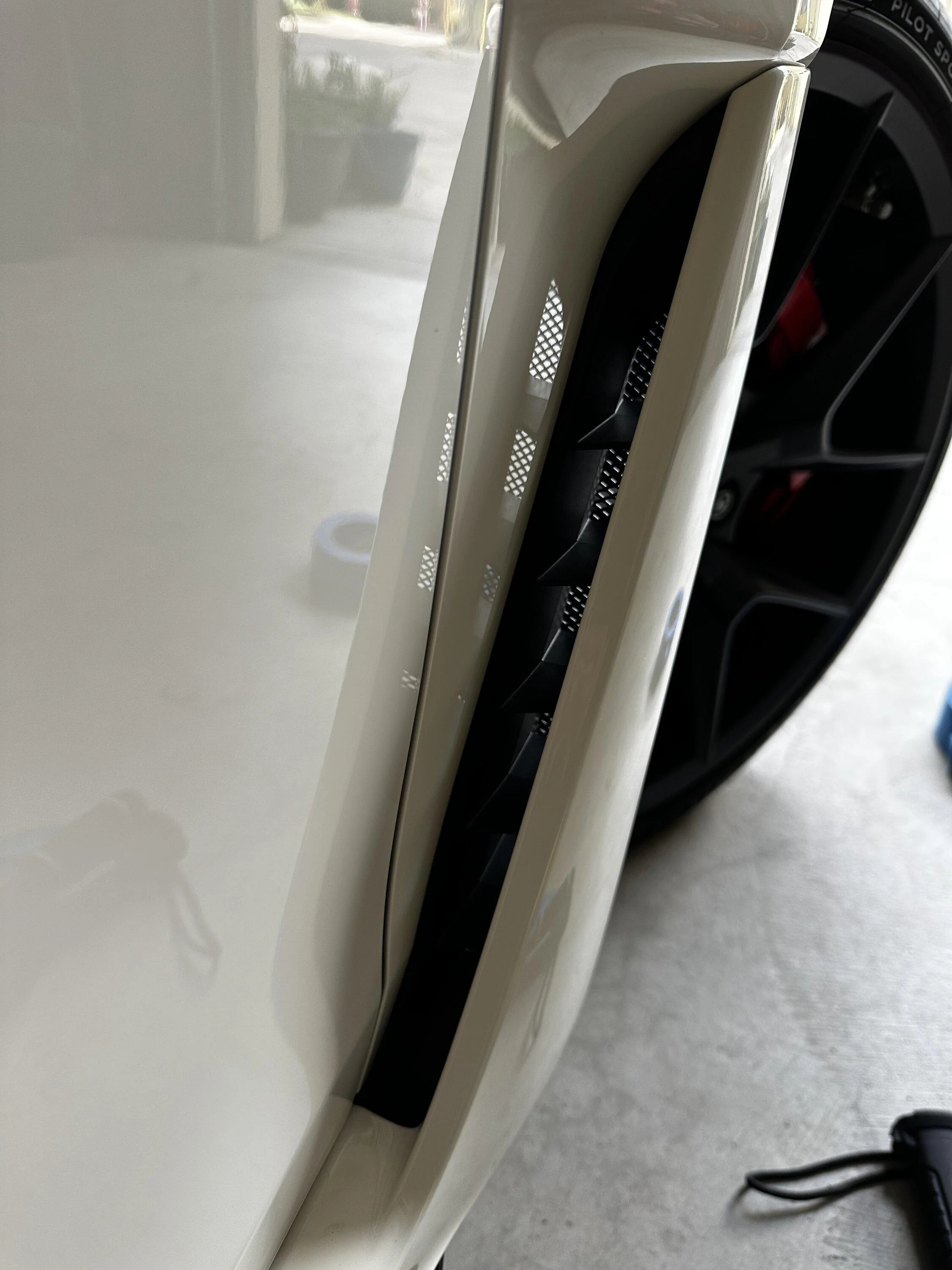

I thought about this as well. My concern is that it cuts down on airflow to the condenser
latole
Apr 13, 2017
1,104
36
Vaudreuil,Quebec ,Canada
The photo of the car does not show that this cannot be the case. The condenser remains very well supplied with air.
I would not have installed the mesh in this location, which is the subject of #1.
Look how thin the links between the cells are. Arrow
11th Gen Honda Civic Stone Guard DIY Capture d’écran, le 2025-10-02 à 04.17.18
11th Gen Honda Civic Stone Guard DIY Capture d’écran, le 2025-10-02 à 04.22.07
Eiching1
Jun 3, 2024
They are pretty thin, so probably an insignificant amount of reduction.
